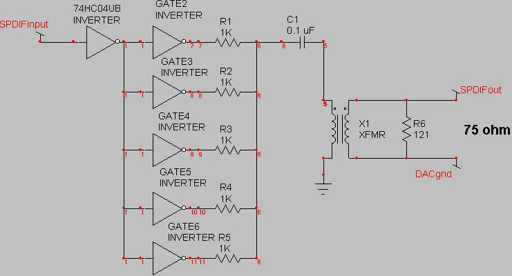

Does anybody know how to make digital out on this player. Analog out is showing signs of sudden death but transport works excellent. I'd build an external dac and it would be nice for some time to be able to use pds501 as transport.

Get a Tentlabs clock XO3 it will clean up your transport and it has a super Spidf (digital coax) output.
Use your power supply that feeds your analog stage for the +15v for the XO3 and disconect that power supply from powering your analog stage so it's only being used to power the XO3, and just leave the - of the power supply disconected.

Tent labs 's DIG out board is good!
If you want to do it a cheap way, you'll have to understand that the SP/DIF will not be as good as the Tent one.
I know that Elso made a goodone also, but the parts are no longer available, but maybe there is a substitute for the (i thinkOPA603???) part.

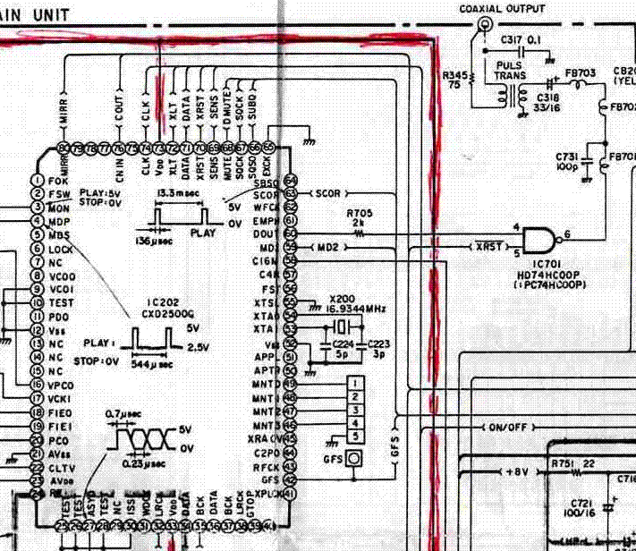

Here it is the sheme of digital out from DENON DCD 860 .From the CXD 2500 Q datasheet , pin 59 must be high (5 V) to enable digital out . So , please check this pin .

Hi everyone
It works ! :up:
I had to cut one jumper wire and add pull up resistor (470R) to pin 59 to enable digital out. Then I made a simple output circut (connected to pin 60) to form S/PDIF output signal.
Thanks everybody.
Mario.

Hi
I didn't use pulse transformer for one simple reason, I had to go to store and buy it (I was lazy and I wanted to finish everything ASAP). I used optocoupler 6N137 with external power. Basically I inverted signal from pin 60, filtered it and connected it to 6N137 input. On the other side of 6N137, I (again) put some RC filter, divider (to adjust level to SPDIF specifications) and transistor buffer. That’s it. I checked (with oscilloscope) all waveforms to be sure that signal on DAC input is as good as possible.
