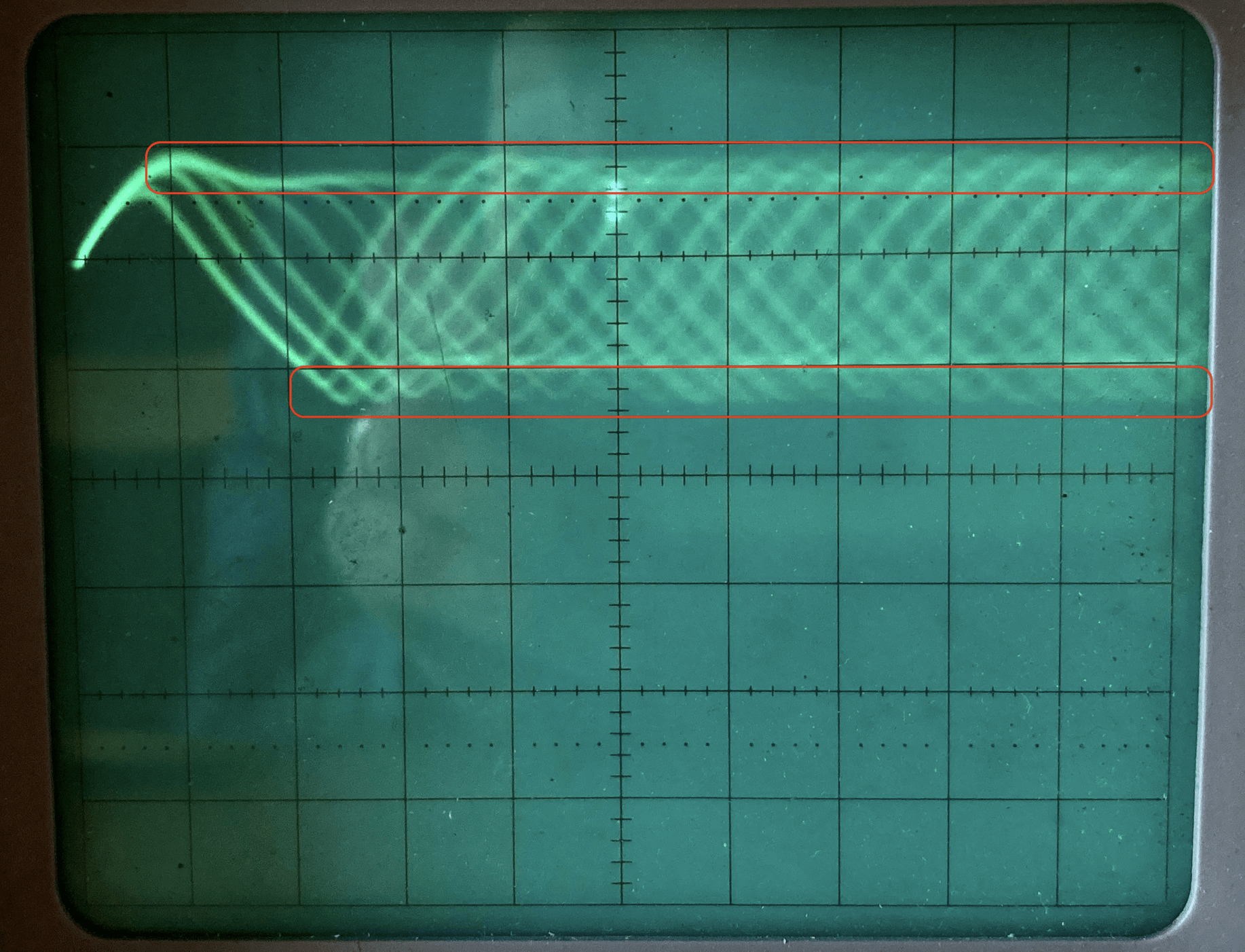

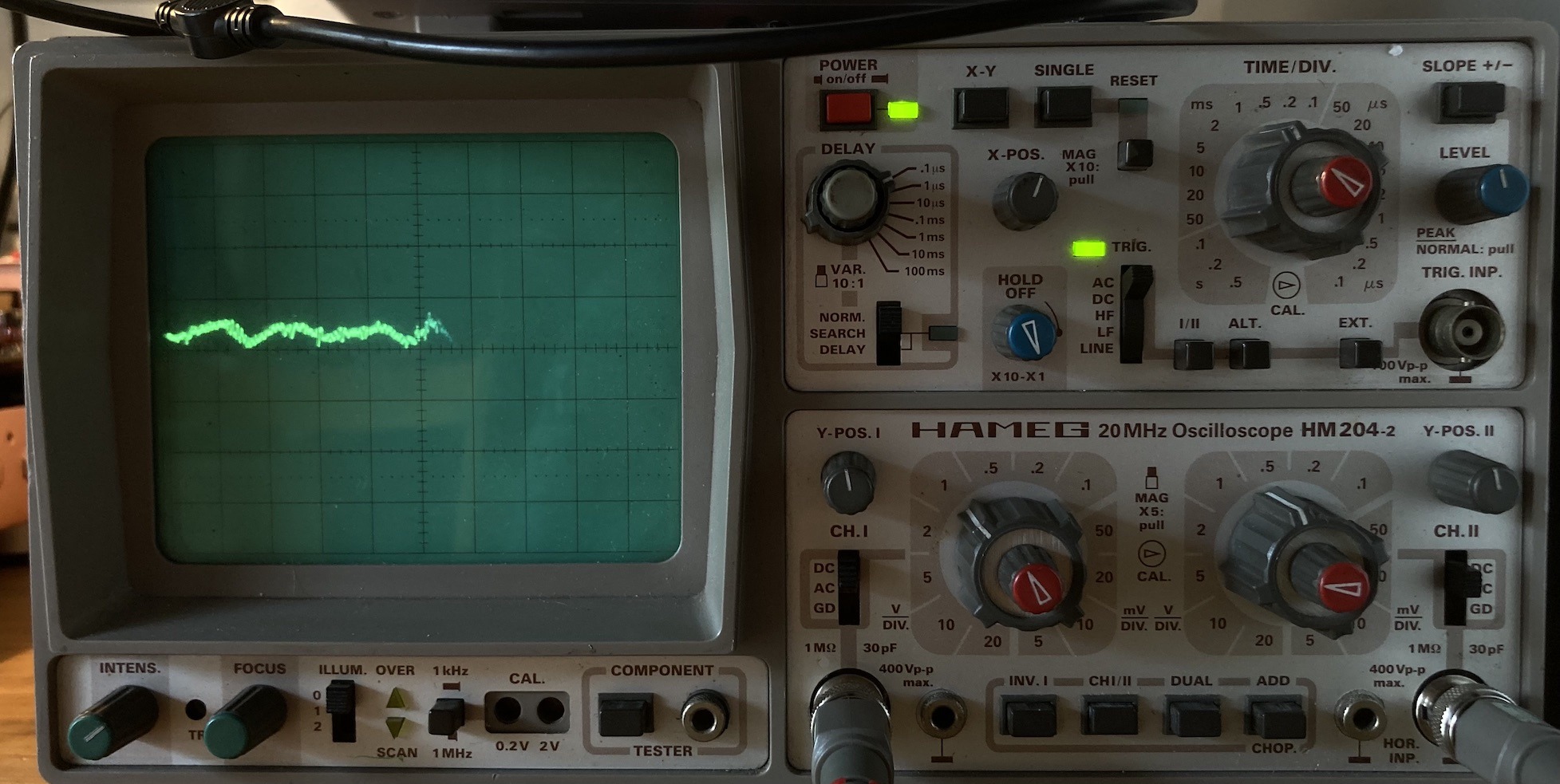

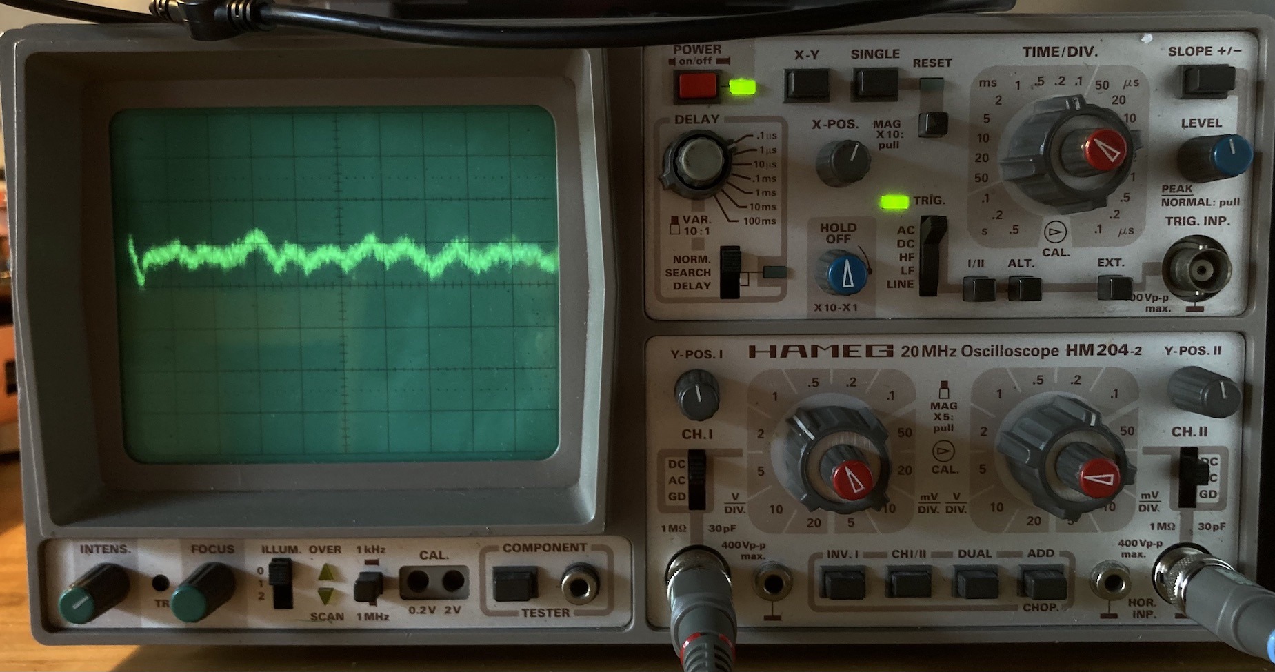

Hi, I made some progresses and now I can reliably read most of the tracks with defects however not with the same stability I get with the PD 7300.
Below the images respectively of RF, FocusErr, Tracking Err.
RF detail showing (red boxes) signal artifacts
RF value ~1.6Vpp (channel 1, 1V/div)
Tracking Error (channel 2, 500mV/div)
Focus Error (channel 2, 200mV/div)

The Central control on both channels of your Vertical Amps on your 'scope aren't set to the ''Cal'' position so you will be getting erroneous readings.
To me it looks like too much RF signal, that distortion at the top and bottom of the trace looks to me like the circuit is being over-loaded.
Channel 1 ? set to 1V/div so is reading over 2 V pk-pk and you have the cental control 'turned down' so am guessing it's even more that that.
Thanks percival007 for your comments.
The Cal knob is out of the default position (all right) because the oscilloscope is old and isn't perfectly calibrated anymore. Usually I take signals I'm sure about and I set the calibration knob to make sure that I'm reading the right measure.
About your remark on the 2V p-p, consider the whole EYE pattern including the overstrikes, yes it's around 2V with standard CDs but when I use a different media like a CD-R then it drops down to 1.4V. However even reducing the RF level, and bringing it for standard CD to default value of 1.5Vp-p makes no difference in terms of tracking skip.
