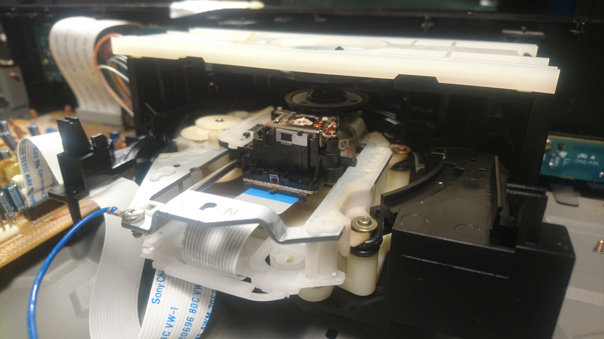

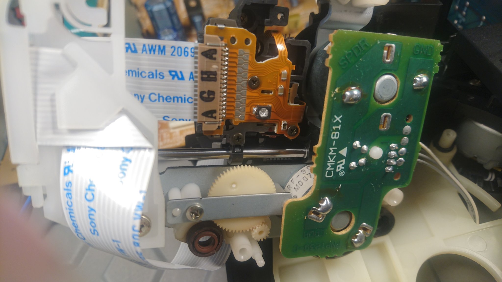

- I also looked under the optical unit. Maybe a problem with the cms capacitors?
I didn't see anything special on the weld side.
- I then saw that the rubber suspensions of the chassis were all dead !
- I temporarily replaced these suspensions with plumbing washers on hand I had. No improvement.
In any case, even if the chassis is poorly suspended or crooked, the spindle remains aligned on its common chassis facing the optics.
isn't it ?
(and the CD did not rub when turning)
I find it hard to question the optics since when the reader works, it works perfectly.

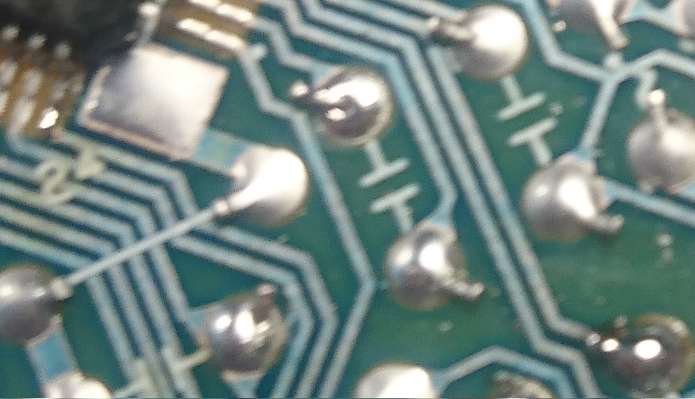

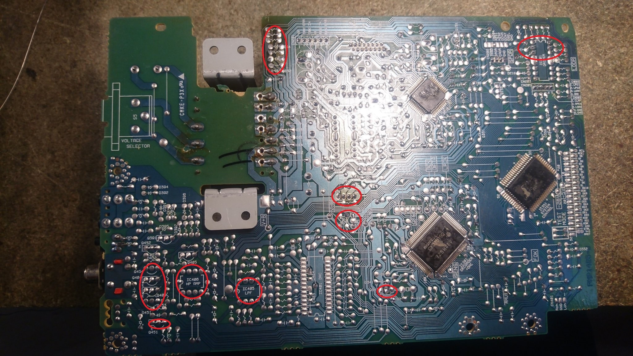

- The soldering under the card was bad originally. it is poor in tin and under the soldering iron, the component legs refuse to solder.
We see in this photo the difficulty :

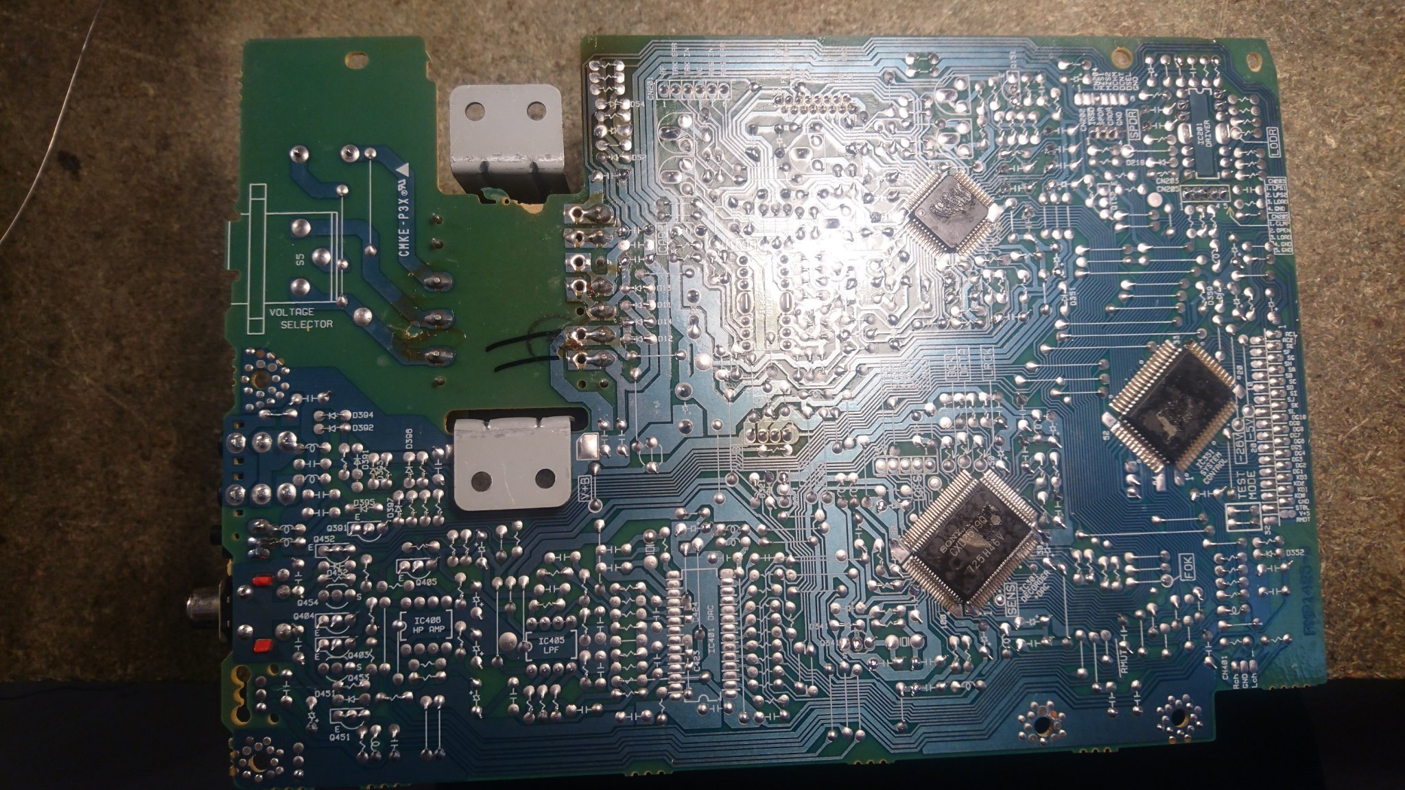

A view of the entire board :I reworked a majority of solders correctly and even on the chips

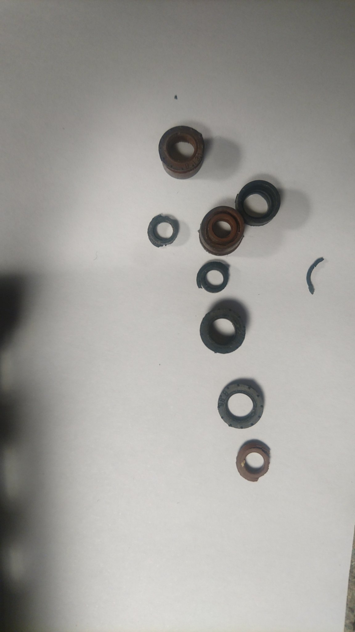

isn't it ?
It's only with the revision of the soldering of the board that I find the best. The disc is read once in five, instead of once in 15.

Hello and thank you.
New weldings have improved operation, I was actually thinking of going back and doing them all.
The ones you circled in red at the top right are freshly redone on my photo.
Near the metal bracket of the transformer at the top, you surrounded this part with resistors.
I wondered why the backélite had turned brown. Maybe a sign?
(it's near the La6520 very hot)
I started to check all the capacitors,
I can also look at the transistors and those famous resistors in bakélite brown.

Some news.
All welds have been reviewed. I had to scratch each component tab for the solder to set.
I also checked numerous capacitors and resistors without finding anything suspicious.
No change !
