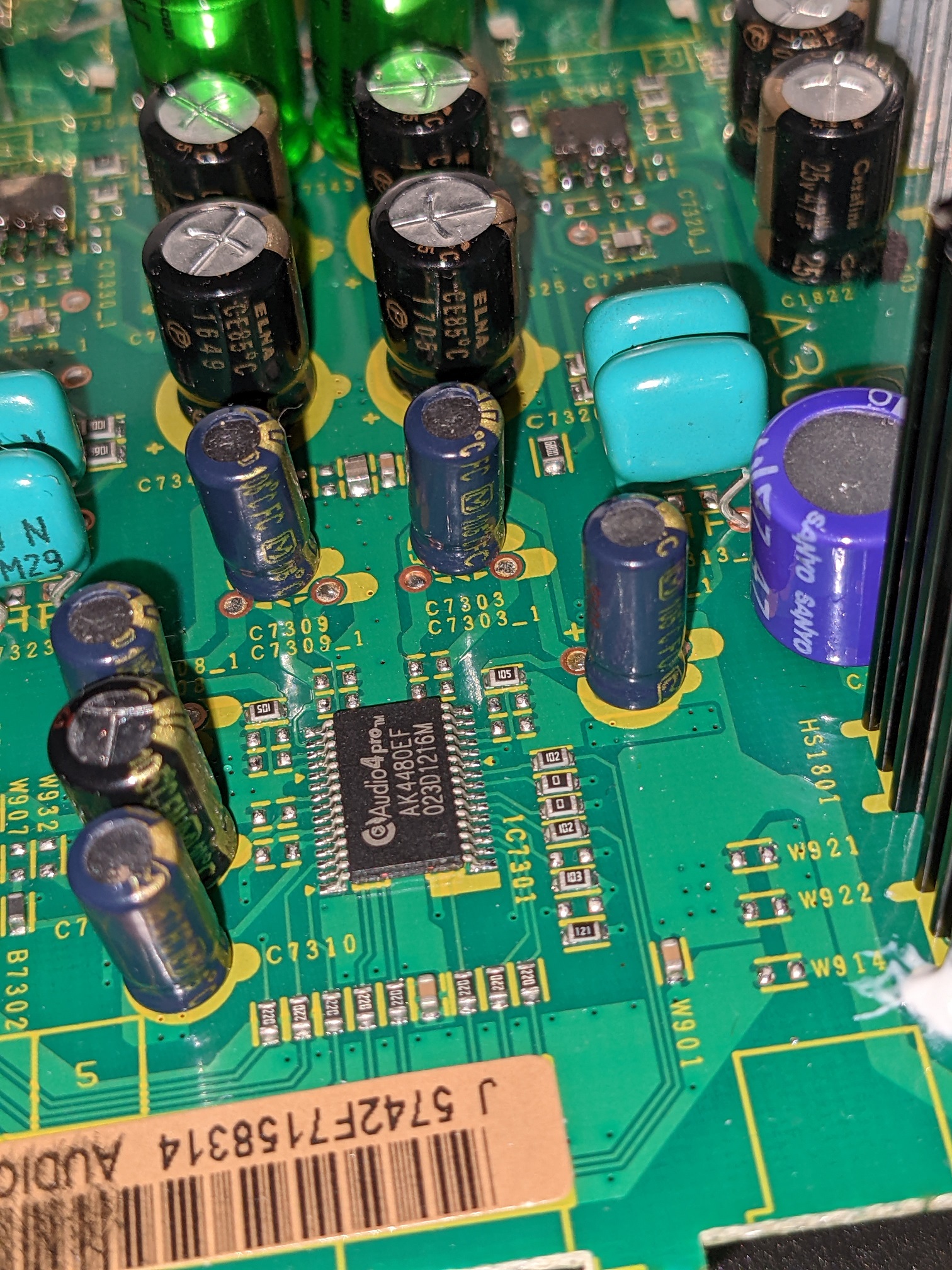

I had a problem once with this player. One channel of the DAC chip was fried!!! I checked everything and I was certain it was the chip itself. Somehow I killed one channel replacing caps. Replaced it and was fine. I'm not saying thats your issue but I not saying its not lol
Heres mine...Did you replace the diodes in the bridge? Did you check the 0 resistors which are essentially fuses??
@dj_holmes i didn't check the diodes, I abandoned the project until now because I thought I'd just replace my dac with one that has an optical input, but it turned out that the player doesn't output digital as well, the optical diode turns on with the player, so the dac detects a connection, but then when play is pressed, the diode turns off and connection is dropped, same with coax, so I guess back to the board it is
