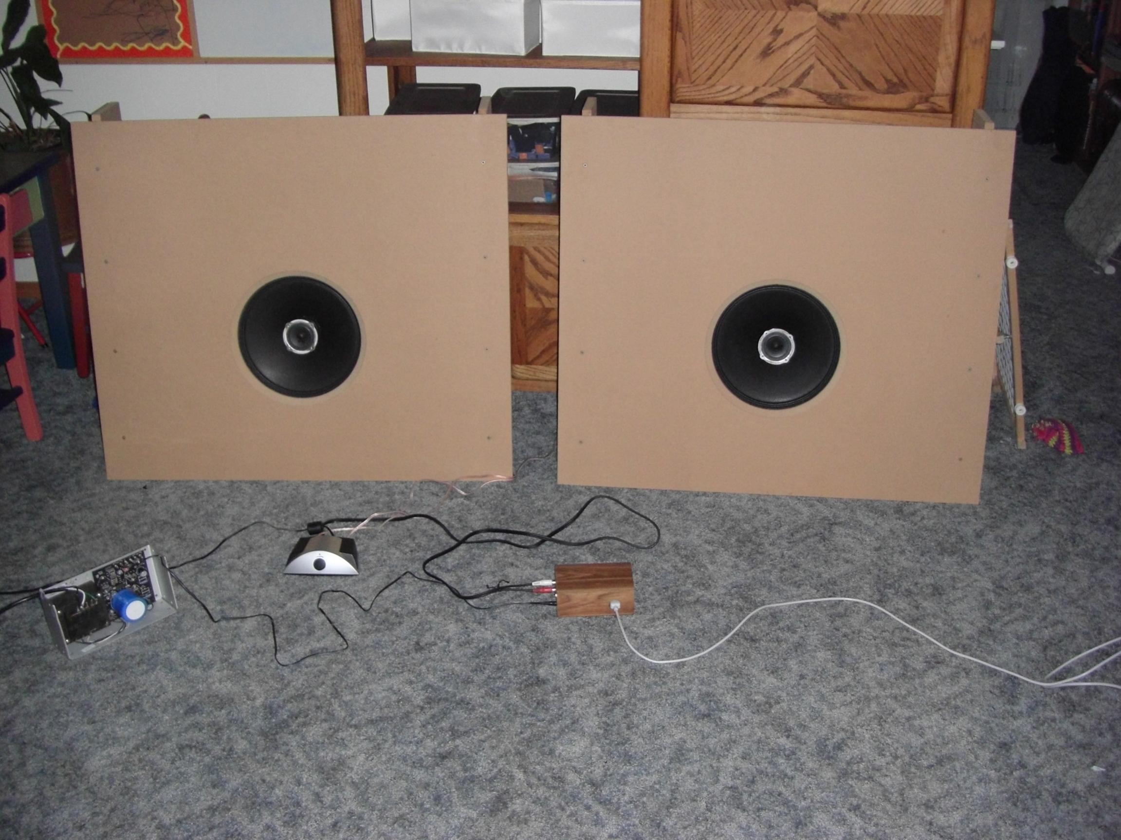

Ok, here are some older pics of the baffles. They don't look just like this now but it gives you a general idea. See what I mean about ugly?
I was using the tripath amp just to test a few changes I had made. Those little amps are pretty cool but after a while they drive me nuts. I can't handle the digital nature of the sound and tubes bring me back to equilibrium.

Erik, beauty is in the eye of the beholder, and I see nothing offensive there.
Can I ask what the tubes are on the inside edges of the baffles?

Yes, the tubing. Well, it doesn't work so well at dealing with edge diffraction the way I did it. But it does effectively extend the baffle and therefore the front to back distance. I completely edged that small Hawthorne baffle with that tubing and it pretty dramatically improved the sound.
I think that the ideal baffle would be shaped something like John's but round, like a donut.

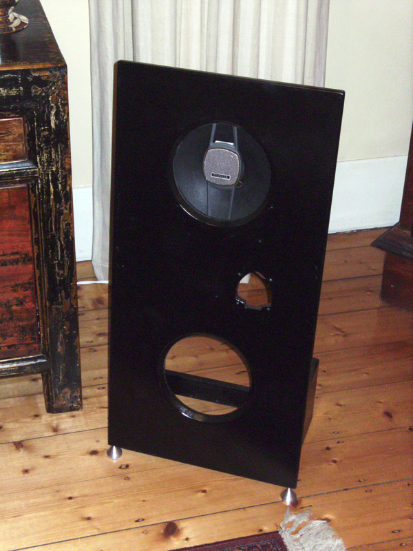

Now, let me show you ugly. (see below)
Notes to self: Don't buy cameras from supermarkets. Remember to make proper baffle for PAX-25B. Make baffle driver cutout 10" to fit driver diameter.

Dunno what you are talking about. UGLY? looks fine to me. But you won't be getting any satisfying bass from that(as I'm sure you know).

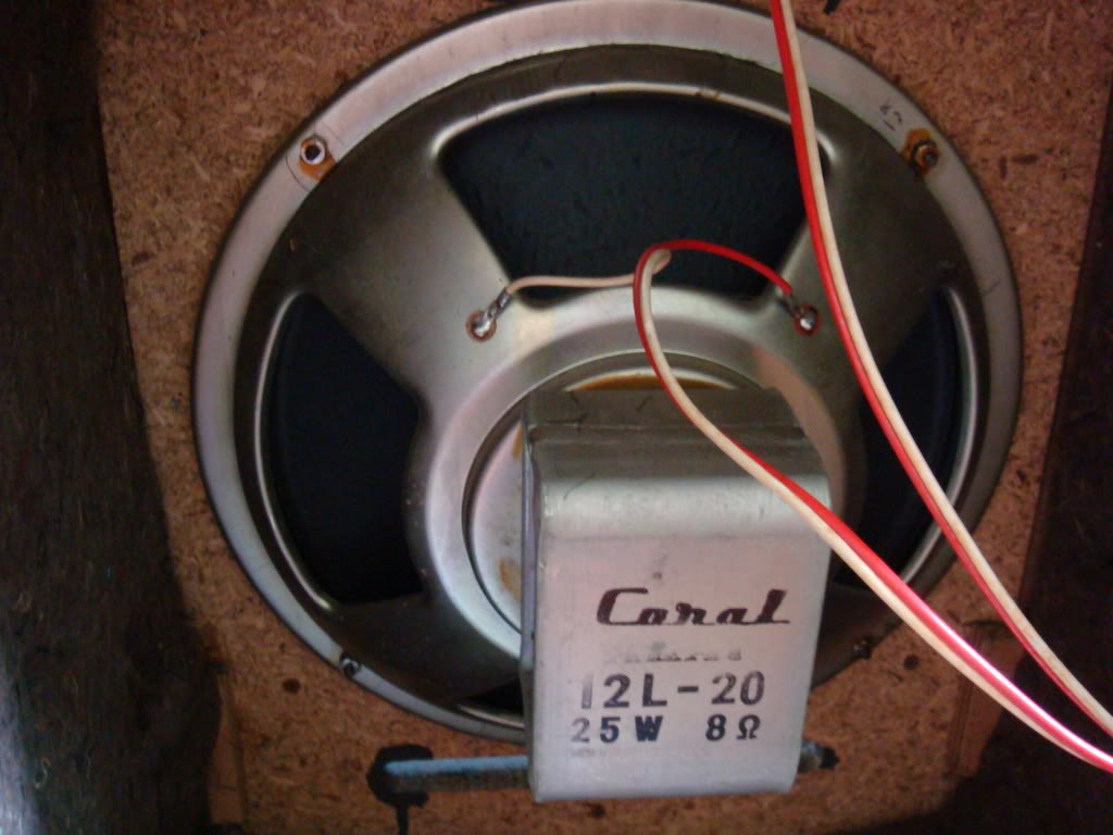

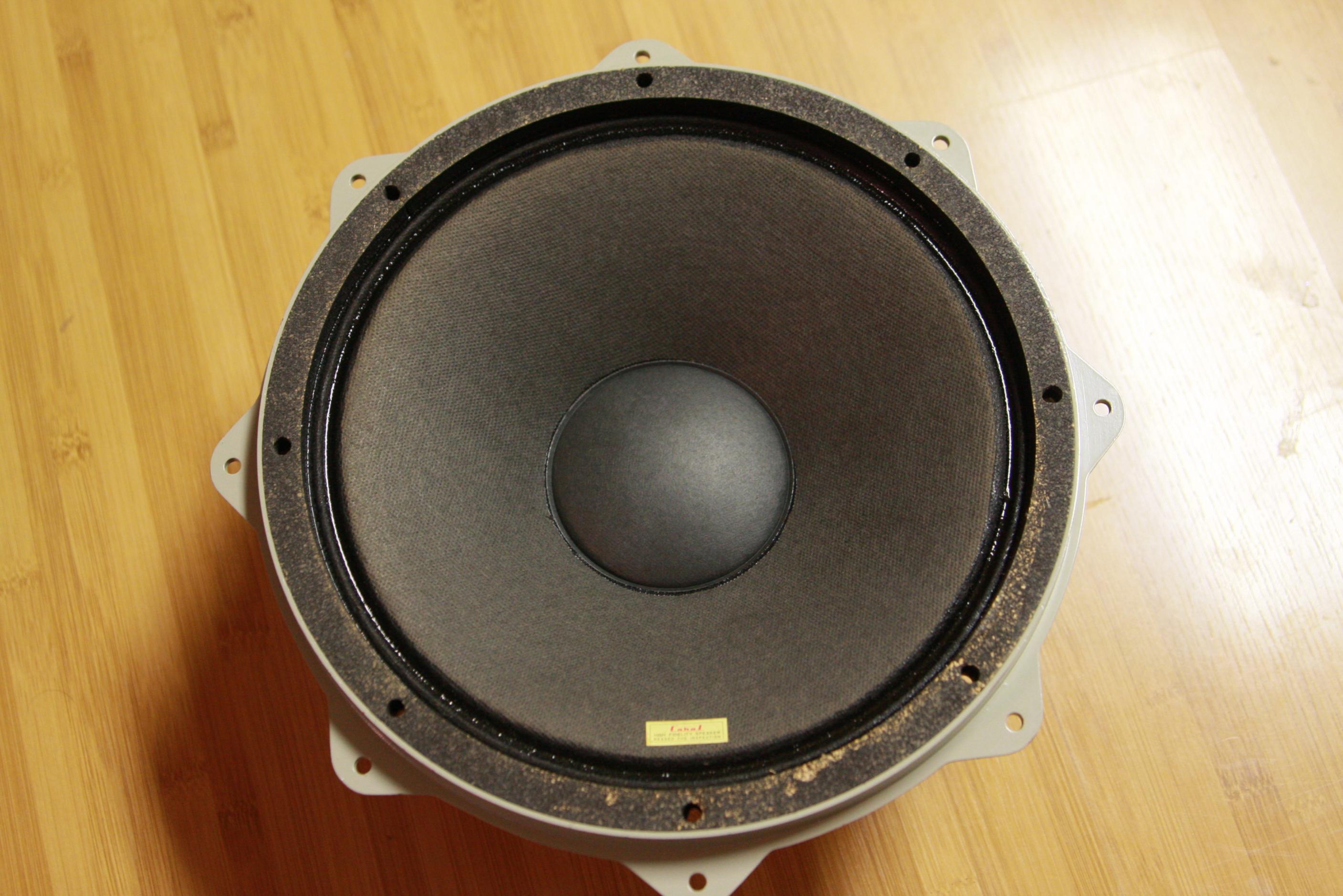

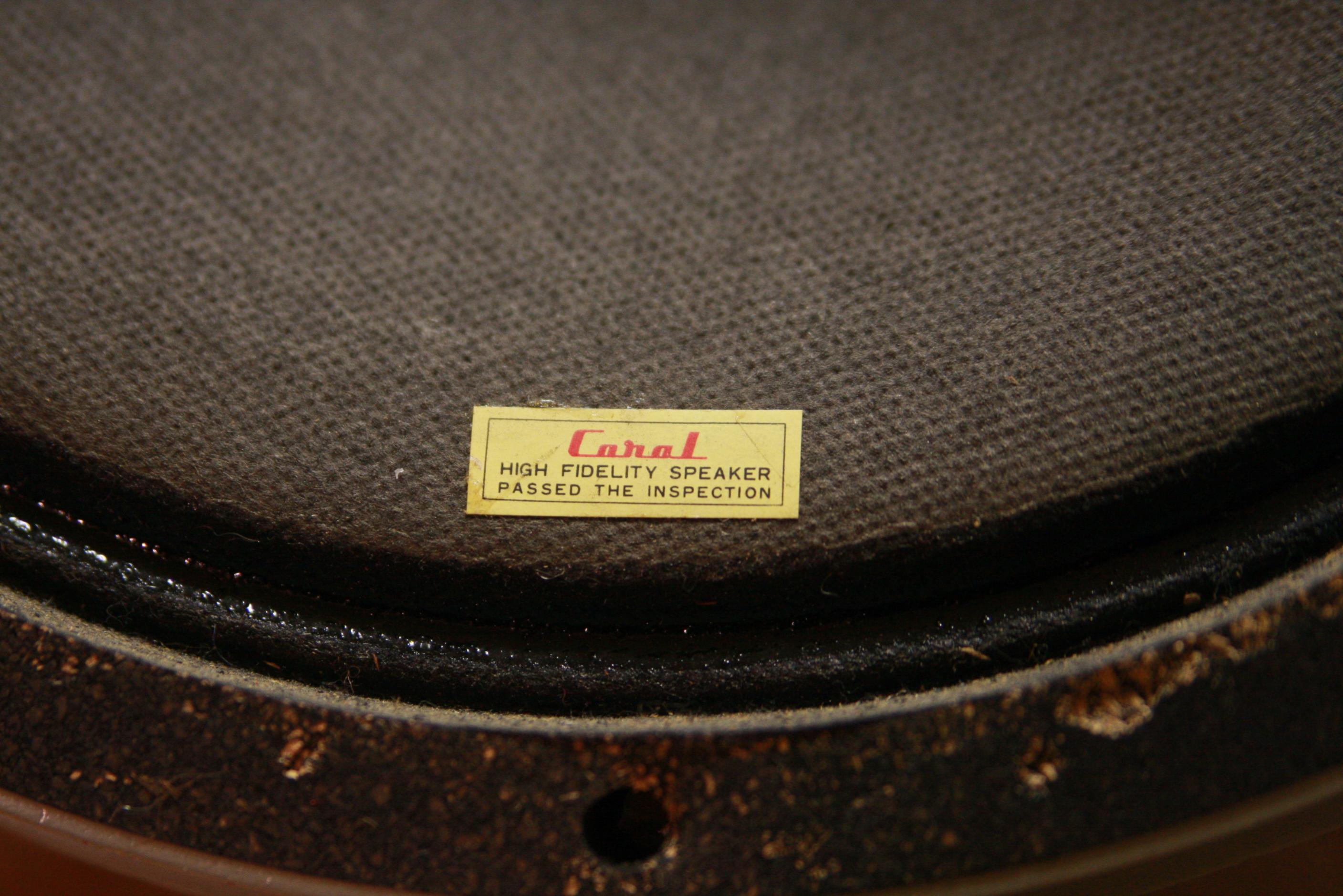

This is that Coral woofer I was talking about. AMAZING build quality.

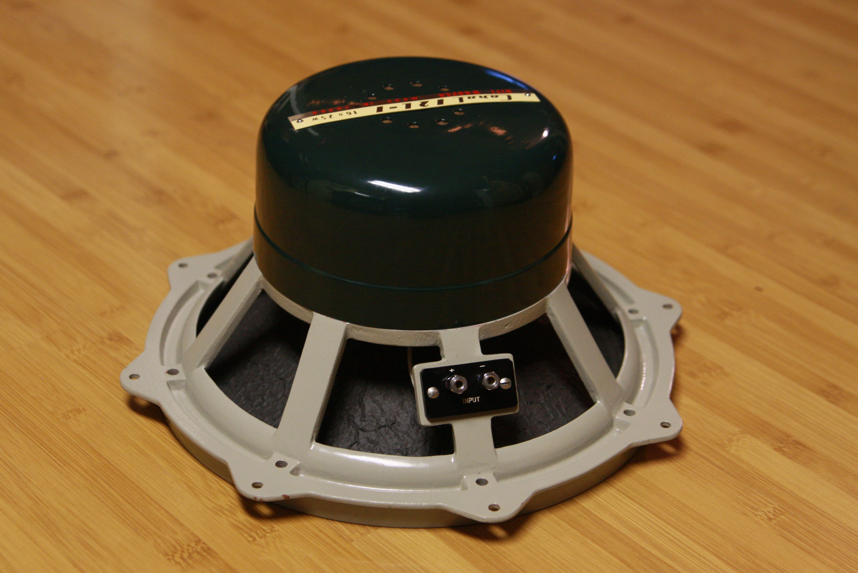

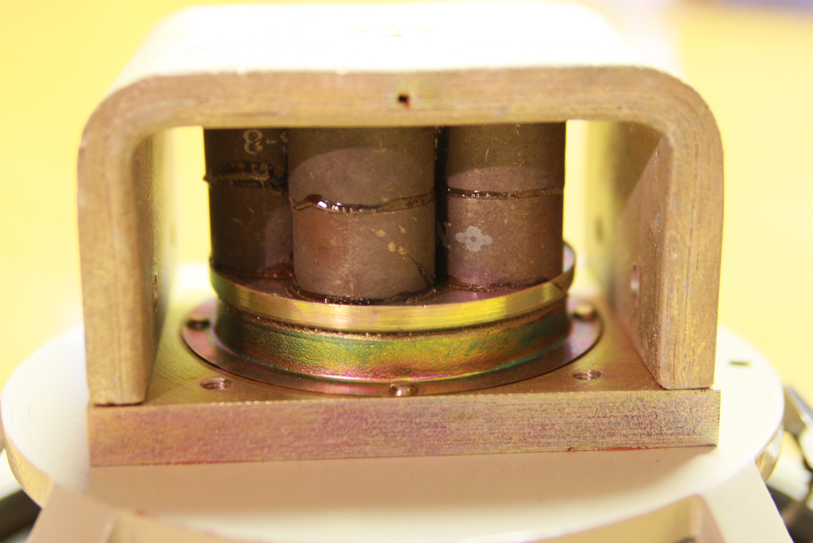

Check this out. Quad Alnico slugs!

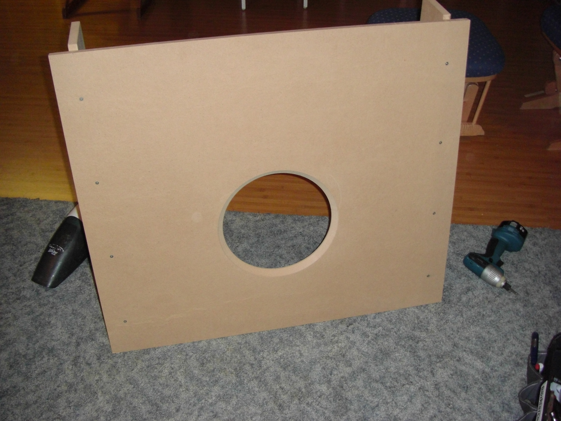

This was the first JELabs baffle. MDF. Yuck.

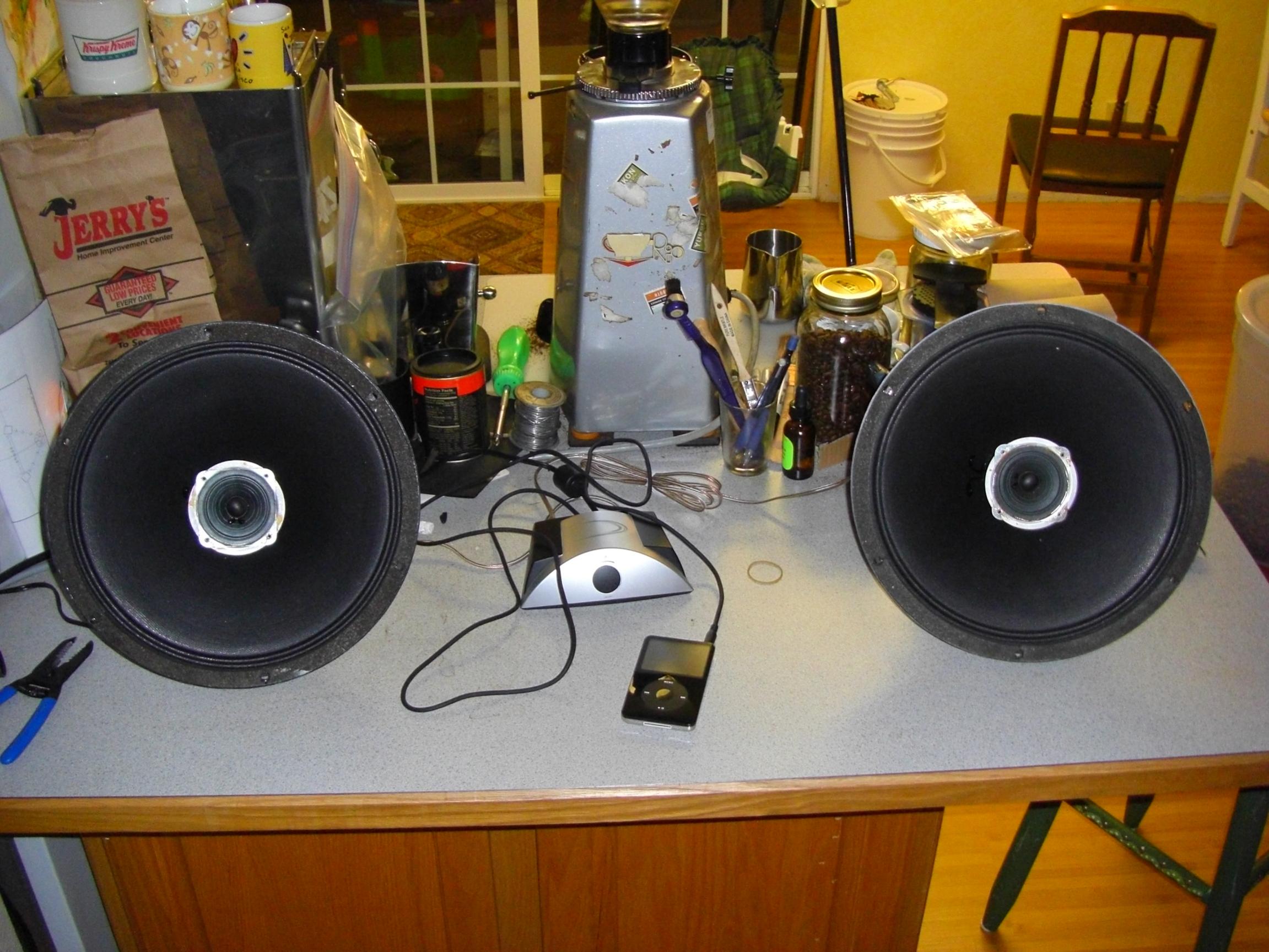

This is where it all started with vintage drivers. One of my other hobbies in the background(coffee).

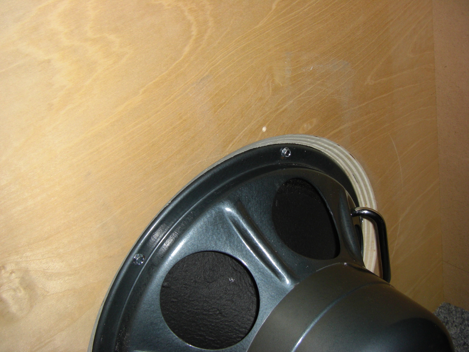

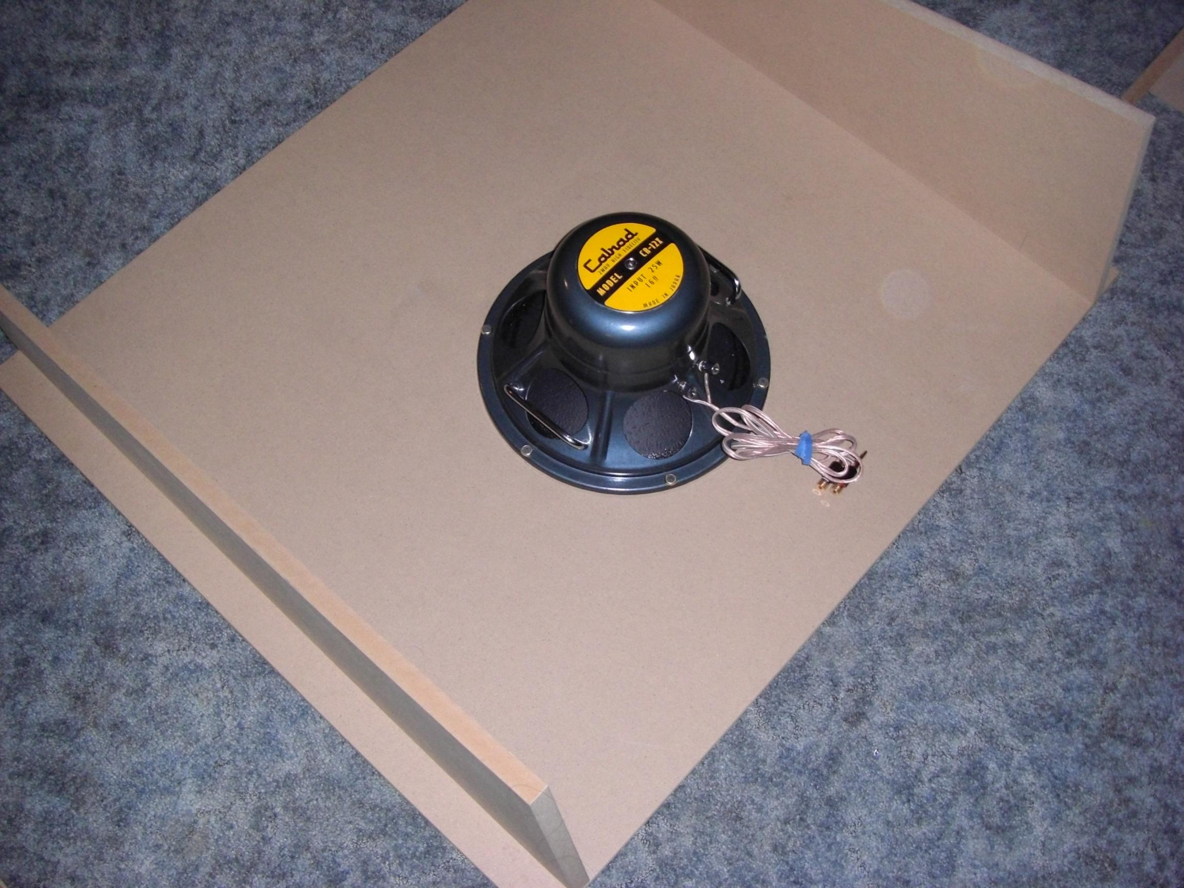

Some mounting details of the Calrad CX12's. These were rated 103dB. I just couldn't stand the bass after a while. Qts was too high I believe and the bass was just too flabby, regardless of the amplifier.

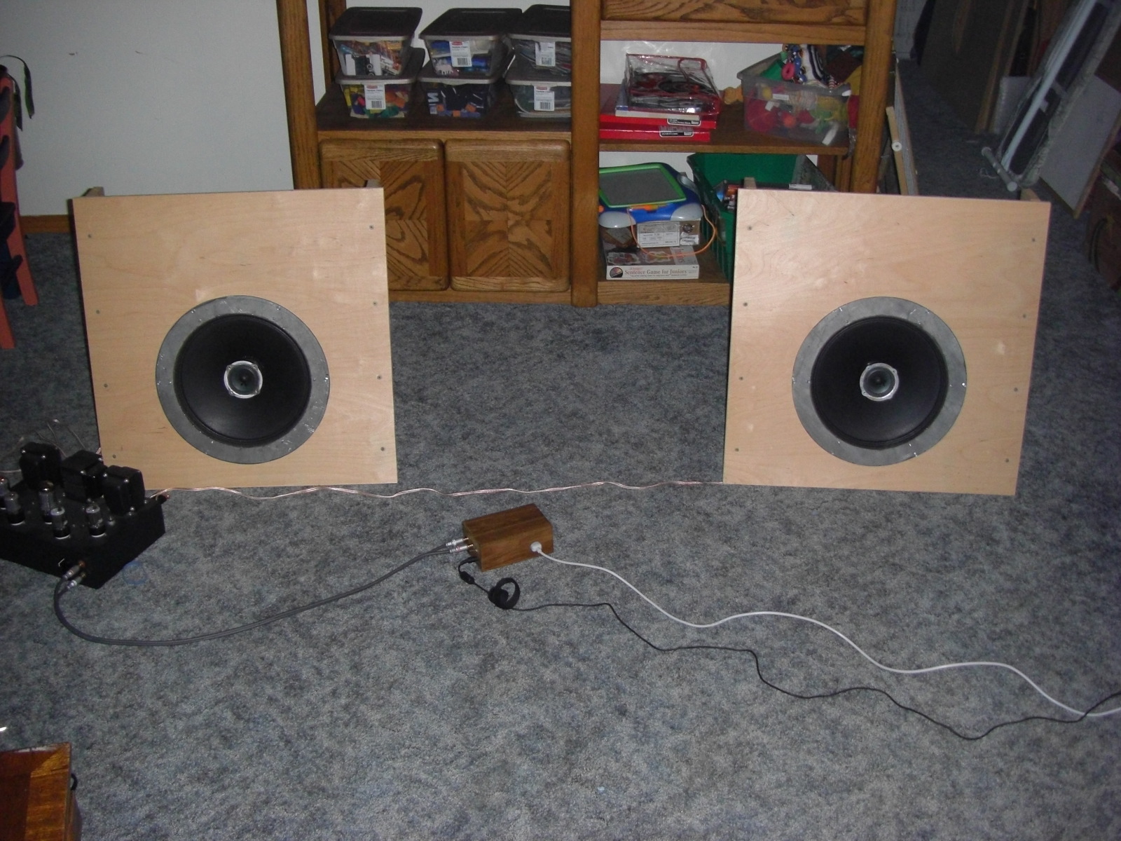

Baffles are getting smaller! These put the drivers a bit too low. But the boundary gain from the floor really helped that "low" end.

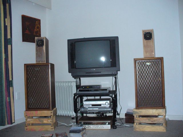

Wow! I was going to start another thread on the CG8Ts, but seeing Viridian load all that fancy stuff here - I thought why not do it too. I have to say the Coral 12" woofer in the BX series is nothing like that giant you have - engineered to the max! The alnicos in the BX are more like this:
Stamped frame, otherwise all OK - accordian suspension, paper cone, alnico magnet.
I mostly enjoy a fullrange speaker, but they do have their limitations, particularly when I want to rock out, that is when the Corals come into their own, a loud wall of sound, tho' it is hard to get them into the house, they do not suit SWMBO, particularly on their stands 😱:
The wee speakers on top are akai SW30, they are a 4" fullranger - a Radio Shack 40-1197 clone (I think) in a labyrinth cabinet.
