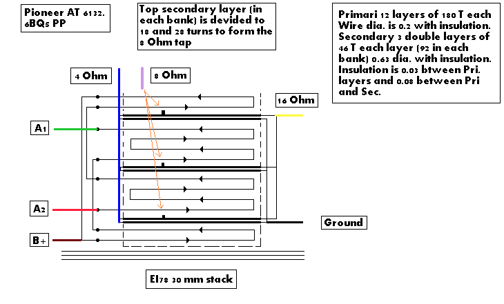

I am talking specificly about the AT6123 output transformer tipycal of the PP 6BQ5 to 7868 units. it is a regular PP unit not UL.
I have pioneer SM-83 amp and after replacing the tubes, caps, the resistors in the signal path and the electrolitics with good quality parts the amp sounds fantastic.
I have a lot of material for building transformers and would like to build some more based on this design. Hopefuly someone can help with the wire schema so that I will not have to destroy the spare unit I have got.
If you want to wind your own units, I think that a good place to start would be "turner audio" he has atransformer design there that I think can be converted to 6BQ5 design just by going from 44 mm tongu EI material to 25 mm, primery wire to size 0.22 instead of 0.36 and secondary wire size 0.65 mm instead 1 mm all the other aspects of the design (I E number of turns, number of layers etc.) can be unchanged.
Please let me know if you have tryed and what ware the results.

AT6123
I took one pioneer output transformer apart a long time ago and have the schematic if anyone is interested in building one...
Very good transformer...
Good luck.
Glass_painter
