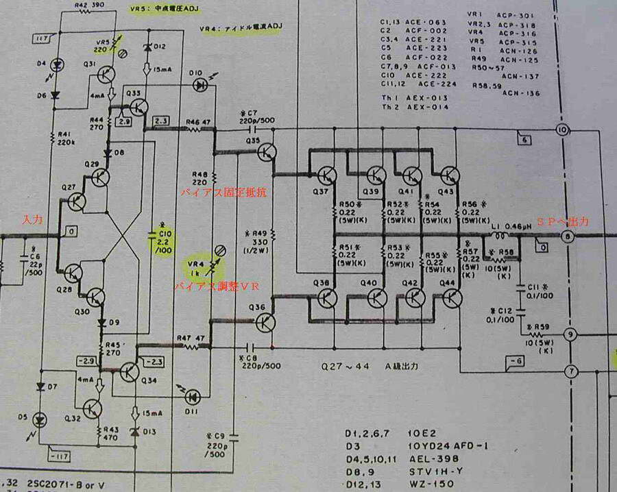

I would like to have this amplifier schematic.
I am interested to assemble the power unit to listen to it.
Can you please, upload the power amplifier schematic or service manual to:
panzertoo@yahoo.com
thanks in advance by your kindness.
regards,
Carlos
I have a non complete schematic found at JA1MDN home page..not enough to simulate...i am still simulating but i see something was missed.

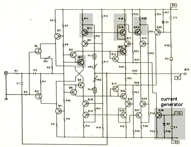

Hi Carlos I dont believe you want to try build this after you see the schematics, this amp is super complicated . :bigeyes:
I dont have detailed schematics but Ill post what the front end looks like.
The one i want the schematic is this one
Are you sure your schematic is the correct one for this model?
I am not sure about mine..it looks to be...but not informed into the Japanese site....or i could not read entirelly..there are signs i do not understand.
If you can read perfectly the Japanese, go there, as i have only some basic knowledge about this language..alike others...only basic... at least i know several languages..all basic knowledge.
here you have the link:
http://amp8.com/tr-amp/pioneer/m5.htm

The circuit posted seems not to be the real one...or... at least is not complete
Observe here...this looks to be a VBE multiplier trimpot... the stand by current adjustment..not sure..but it is possible this adjustment exists into the complete schematic substituting some fixed resistance you have into the circuit.
regards,
Carlos

Dear Carlos,
My fault I didn't explain myself good enough. I mean there is not VBE transistor for thermal compensation but just a simple potmeter.
With best regards,
Bas
Hi Carlos
The circuit that I posted is the front end of the schematic that you posted, you only have the output section. The circuit is called super linear and was used in Pioneer M5 M6 and PA 06. From what I understand these amps were highly regarded and said to compete with Macintosh and Mark Levinson, price back in 1989, 1990 was around 10 000 dollars outside Japan if I remember correctly. Between our 2 schematics we missing some parts though.
Complexity does not always mean bad sounding amp, I myself have some electrocompaniet monoblocks which are more complex than most but sounds rather better than a lot of amps.
Dear All,
From what I can judge, it seems a very neat circuit. High current gain already from the VAS. Tripple Darlington. Something that seems to be hated by many, but can sound very good in my opinion.
