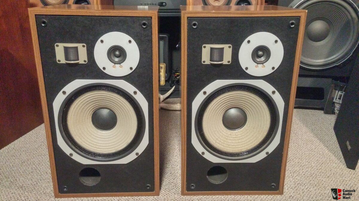

I have the same speakers and the same problem tweeters. I would love to know how the cheaper Dayton tweeters turn out but would buy the expensive tweeters if I must. The cost of the Pioneer copy tweeters maybe worth more than the speakers (with no sentimental value applied).Good call, thanks for the insight, i'll give the cheaper tweeters a shot and see how they turn out and compare with the one factory tweeter i have, will definitely recap the xover board if it does turn out to be NP Electrolytic, i haven't dug out the stuffing to check, it does appear , i will post updates and if it turns out nice i'll look into fashioning some sort of nice looking adapter plate, fingers crossed
A lot of stuff came up for me this year so i haven't had the time to get into it. I'll look into the Dayton ND20FA or ND28FA sometime early next year when i get back home from the holidays, i'll be glad to update you on the progress/results when i get to it if you're still interested, i'll most likely be 3d printing some form of adapter for the old tweeter opening, the design of which i'll also gladly share if it comes to it.I have the same speakers and the same problem tweeters. I would love to know how the cheaper Dayton tweeters turn out but would buy the expensive tweeters if I must. The cost of the Pioneer copy tweeters maybe worth more than the speakers (with no sentimental value applied).

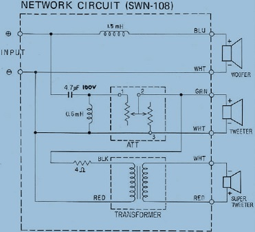

I've measured HPM-100 as a whole and per driver unit. Woofer is decent, the rest is trash. Crossover design is nonexistant. Piezo film tweeters lost almost all of their sensitivity. The best option IMO would be to keep original woofer and cabinet (turned upside down for more sensible CTC distance), add freestanding ATH horn on top and make a two way.

Take note how all drivers are playing together; essentially there is no crossover.
All of the above applies to HPM-40 as well.
Forget any "recommendations" from Pioneer, their HPM series was moronic. There is no design to build upon, you have to start from scratch.

I'll begin with the dome and take some of my own measurements, i suspected the Xover wasn't the greatest but one of my "goals" with these speakers was experimenting with biamping and DSP, thank you for the info though, i didn't think it was that bad.I've measured HPM-100 as a whole and per driver unit. Woofer is decent, the rest is trash. Crossover design is nonexistant. Piezo film tweeters lost almost all of their sensitivity. The best option IMO would be to keep original woofer and cabinet (turned upside down for more sensible CTC distance), add freestanding ATH horn on top and make a two way.
