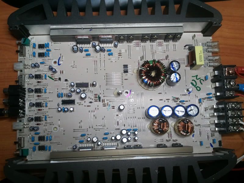

I have a Pioneer GM-X574 4ch car amp that's giving me the silent treatment.
No sound from it but seems ok. All transistors give correct readouts but there are 4 DMOS that I am not sure how to test.
I found the datasheet on them here:
http://www.datasheetcatalog.org/datasheet/SGSThomsonMicroelectronics/mXqwvzw.pdf
The capasitors looks like new so not sure what's up. Also the red diode is blinking.
Manual doesnt say what that means, but I guess it's because it's not working 🙂
Anyone have any idea what I should check next?
Only have a 0-5v scoope here but will try to get a better one this weekend..

Are the amplifier ICs TDA7294? Try to get the datasheet and check their mute/standby pins. The amp is probably muted because protection is being activated.
Yes the ICs are TDA7294. Both pin 9 (std by) and pin 10 (mute) have about 6 volts on them.
Power to the ICs are 11-13v oscillating (pin 13-15).. I guess there should be higher voltage here?

Here is a amp that is "close" to the one I have. Same ic for controll. PC494C and PA2027A.
The PC494C doesn't get VCC power on pin 8,11,12.

according to the DS and application schematic, when measured against pin 4 (GND), pins 7 and 13 should have from +24 to +36V, while pins 8 and 15 should have -24 to -36V.
If you are seeing the supplies oscillating (how fast?) at a lower voltage, this could be due to an overcurrent protection shutting them off, then on again etc.
possibly indicating a broken TDA7294.
Got 5-6v on those legs, power is going up and down within a second.
