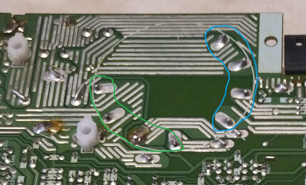

I tried looking over the board and jiggling components on the top side while looking at the underside to try to find other bad solder points. I wasn't able to find any.
Install a single 10 amp fuse in the amp and power up without Q332 and the other output in that channel. Does the amp power up?
I didn't need to install a fuse since I have one installed already per your bcae1 instructions 😀
Removed Q332 and Q328 and the LED comes on and stays solid. I would say it looks like it is powered on but wasn't sure what other tests would be ideal at that point.

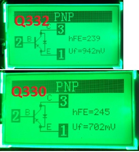

I moved Q330, Q314 and Q326 over to Q332, Q316 and Q328's spots. When I touched the b+ lead to power I heard that little sizzle sound, so I stopped. Any idea what could be making that sound or what components, if any, are capable of that? I checked that all the legs of stuff under the board were shorter than all the plastic standoffs, so I don't think it's arcing to the heatsink.
I thought about taking Q330, Q314 and Q326 back out of the broken channel and putting the ones from the broken channel (Q332, Q316 and Q328) into Q330, Q314 and Q326's spot to confirm that channel works with them in there, if you think that's worth it.
What ones precisely do you mean by "driver transistors"? Sorry, I don't know for sure which those are and I don't want to guess wrong. My guess would be Q316 and Q314 and since I swapped those as well as took them out and put them in the transistor tester and they measured similarly as NPNs, I am thinking they are fine.
If resistors don't sizzle, I was thinking is that more likely to be a capacitor or one of these other Q numbered components? At this point I was just trying to decide which components to desolder and test out of circuit first.
