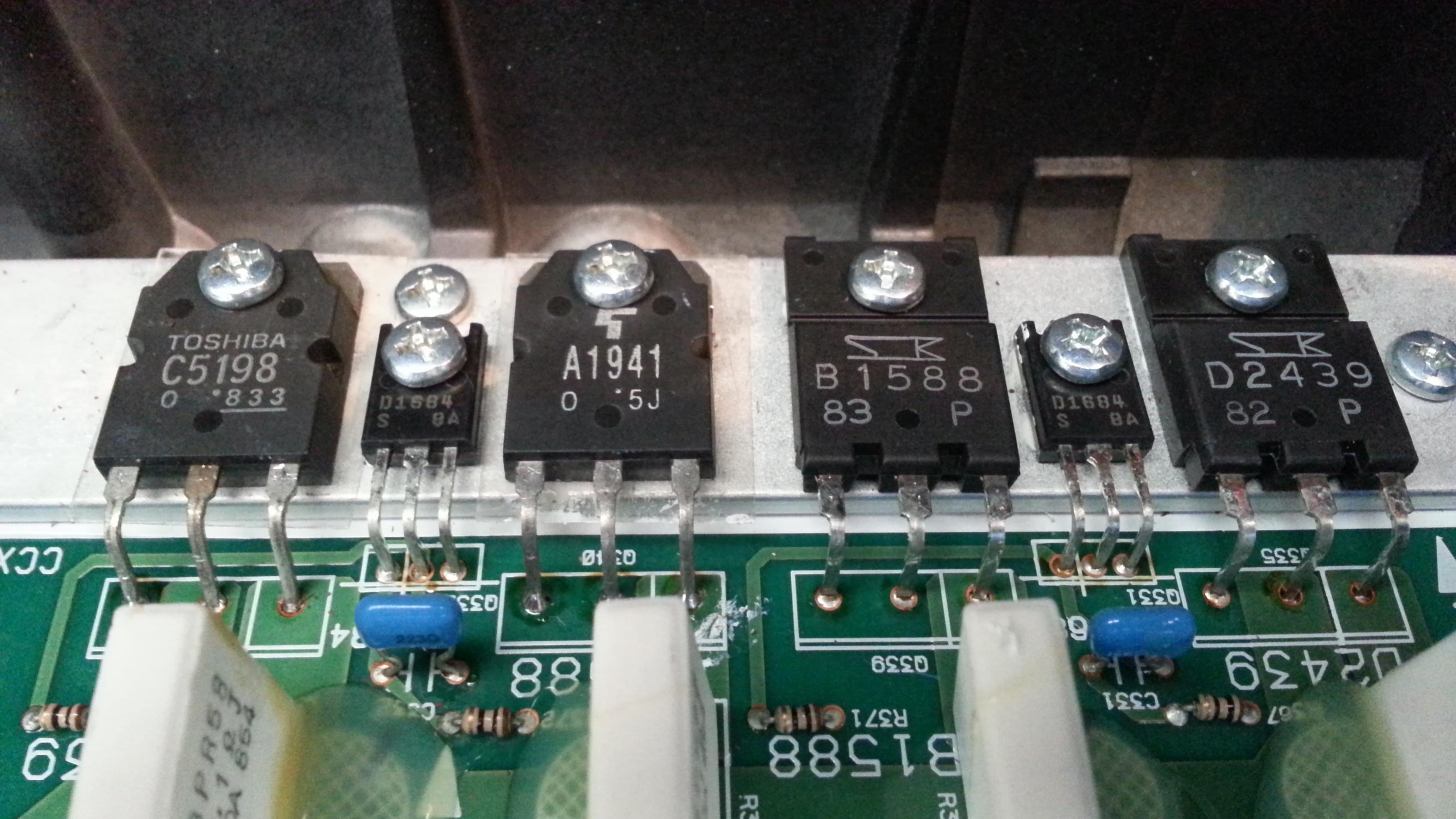

howdy all, i have fixed my amp with transistors that are somewhat identical, a little bit higher specs but the new transistors are heating up. the amp works and doesnt get into thermal protection.
its a 4channel amp im bridging the fixed channels on a sub as test.
original faulty transistors are b1588 and d2439
replaced with a1941 and c5198
works well, just heats up.. keeps getting hot.. i had it run for over 1.5hrs no thermal protection and no audio issues....
the only thing that i found out that i think could be the issue is the transistor's transition frequency differs.. the old ones work at 55mhz the new ones 30mhz.. can this be the issue of heating up?? does it matter? or can it be somthing else?? what should i check?

i know ideally they should be from similar manufacture and of same batch, beggers cant be choosey, thats what was available, if its the issue ill change the original ones to the same as what available.. or will i then have 4 heating transistors?
The replacement transistor you used is not a good match/sub.
The original one is a darlington type.
The darlington is essentially two transistors in series. They make it easier for the drive circuit to drive the output transistors but require twice the bias voltage. The bias circuit is causing too much idle current. Simply reducing the biasing isn't generally an option because the drive circuit is too weak to drive the non-darlington transistor into a load.

The non-d transistors aren't working hard but they are dissipating more heat due to incorrect biasing.
The drivers aren't working hard. They work harder at higher output levels and with lower impedance loads.
The non-d outputs may work to some degree but when asked to drive speakers at full power, they could stress the drivers to failure and may not be able to drive to full power without significant distortion.
The added heating from excessive biasing will make the transistors more likely to fail due to higher operating temperatures.

You can't use only a few specs/parameters to determine if a substitute will work.
Examples...
When an amp is designed by an engineer, they have ti use capacitors and other components to make sure that the amp behaves (no undesired oscillation under varying loads, etc). Different transistors may require different values of damping components to stabilize the circuit.
When the bias circuit is set up (by the design engineer), it's meant to compensate for temperature based on the various temperature vs threshold characteristics of the transistors in the circuit. Any substitute could make the bias unstable resulting in distortion at some temperatures and bias avalanche at other temperatures.

Thank you Perry very much for such thorough clear complete and educational answers, indeed its more complicated than black and white, i will wait to find the proper required transistor. I just was hoping the 1587 would have been a better temporary fix than the non-darligton pair that i used. No point in refixing twice, im holding off to find/get the required parts.
Found proper replacements, removed previously installed non-darlington transistors, installed the proper darlington ones and bump tested the amp.... 2ohm bridged.... was expecting overcurrent draw protection or overheat protection when the amp went silent... turned down volume nothing came back turned remote off and on, nothing came back...
Long story short, burned out the replaced darlingtons, got another pair and installed and its working now.
I dont get it.. i do understand this amp is not 1ohm stable stereo, 2ohm bridged, but i dont understand how the protection circuit did not kick in! Hell it did kick in with the non-darlington transistors!! I am testing it by pushing it to the limit without clipping! With the non-darlingtons sure it ran hot as hell but overcurrent protection did kick in and when i turned down the volume the amp turned back on...

The non-darlington transistors are likely rated for higher current which would explai why they survived.
The amp is designed to drive 2 ohm stereo, 4 ohm mono, minimum.
