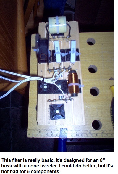

Here's the sort of thing I do for crossovers. Frankly, driver quality makes more difference.

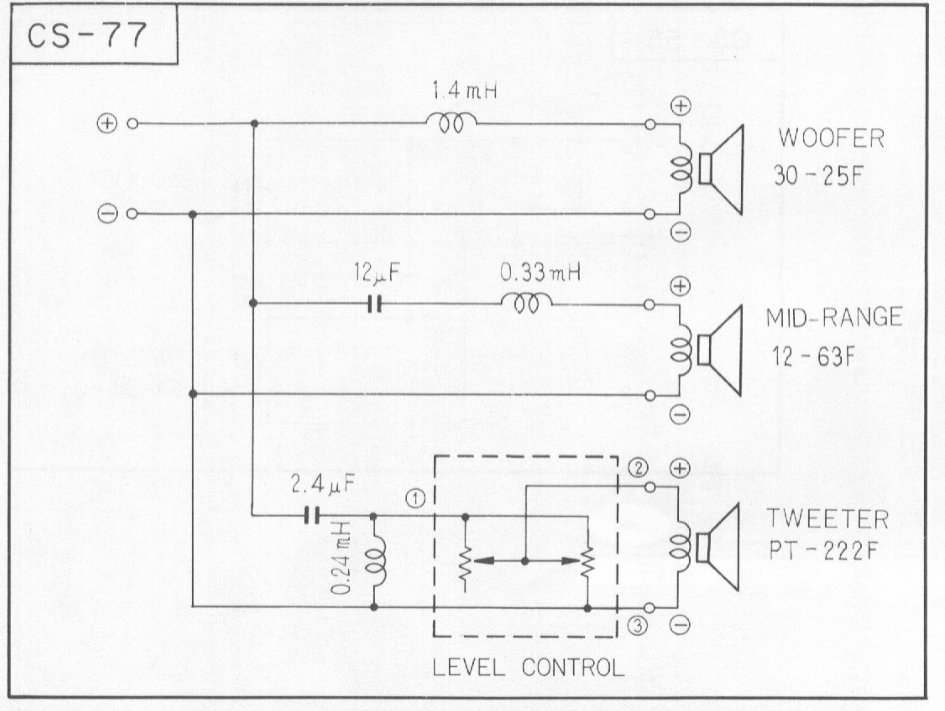

Hi Steve,
Just a brief follow up question regarding the proposed crossover upgrade. Do I retain the L pad for the tweeter or bypass it altogether since we already have a 4 ohm resistor in parallel. I did confirm by disconnecting taking the tweeter out of the circuit ohms increased to 6.4 like you mentioned it would.

Hmmm...tweeters!
So, a brief summary:
It needs to stay on the vertical axys like the midrange and the woofer
It needs to be a new component: choice may be a little difficult because the sensitivity is unknown (and an L-pad becomes useful at this stage, when using tweeters having 93-95 dB sensitivity for a start )
The midrange: Ok, use the cilynder as a box.
Don't trust me when I talk about X-overs ( 'cos it has to be verified at the latter stage )
a 1st order might sound wonderful ( electrical )
But...The midrange ( let's say a woofer ? ) in a closed box already has a 6 dB roll-off, so the final acoustical slope will be different.
It'll match with the roll-off exhibited by the woofer and they'll meet happily together at the -3dB point

Thanks Pico,
I was looking at upgrading x-overs as Steve suggested. He posted a schematic for SEAS 503 model that is very close to mine except it is 2nd order. Confusion was setting in as to how the L- pad would interact within the design.
I appreciate the advice you have given! Just wanted to make one change at a time and learn what influences matter the most. I'm sure tweeter upgrade will take place sooner then latter.

That 1.4mH coil is a useful size for an 8" build at some stage. Should be able to get it off with a blade.Yea,
These drivers are in great shape. I have decided to modify the crossover a bit to improve bass response. Later, as I gain more experience a diy project will arise that does not involve tossing out speakers that are in good working order.

But I think you can do the work on the existing circuit board with those solder tags available and some hook-up wire or 15-30A fusewire, which is usually tinned copper. Hot glue is useful too.
Thanks Steve,
There does seem to be enough room on the existing board. But, if things turned out to be to congested, I could add a small board near the open solder tags for the additional woofer components. Especially, the 4.7 mH coil and 22 uF cap. Keep the 3.30 ohm resistor for the woofer close to the open solder tags. Those are my initial thoughts at this stage. I will refer back to your work that you posted for layout ideas as well.

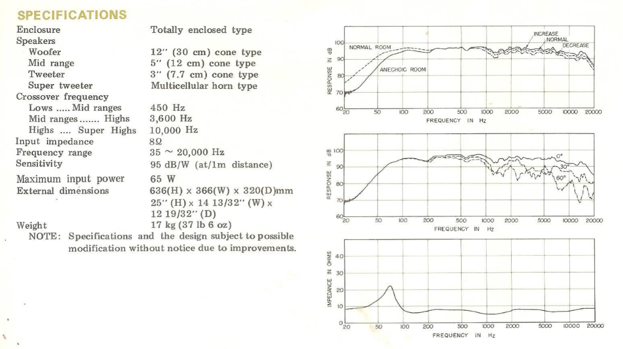

You can download a user manual for cs77a at www.vintageshifi.com.
