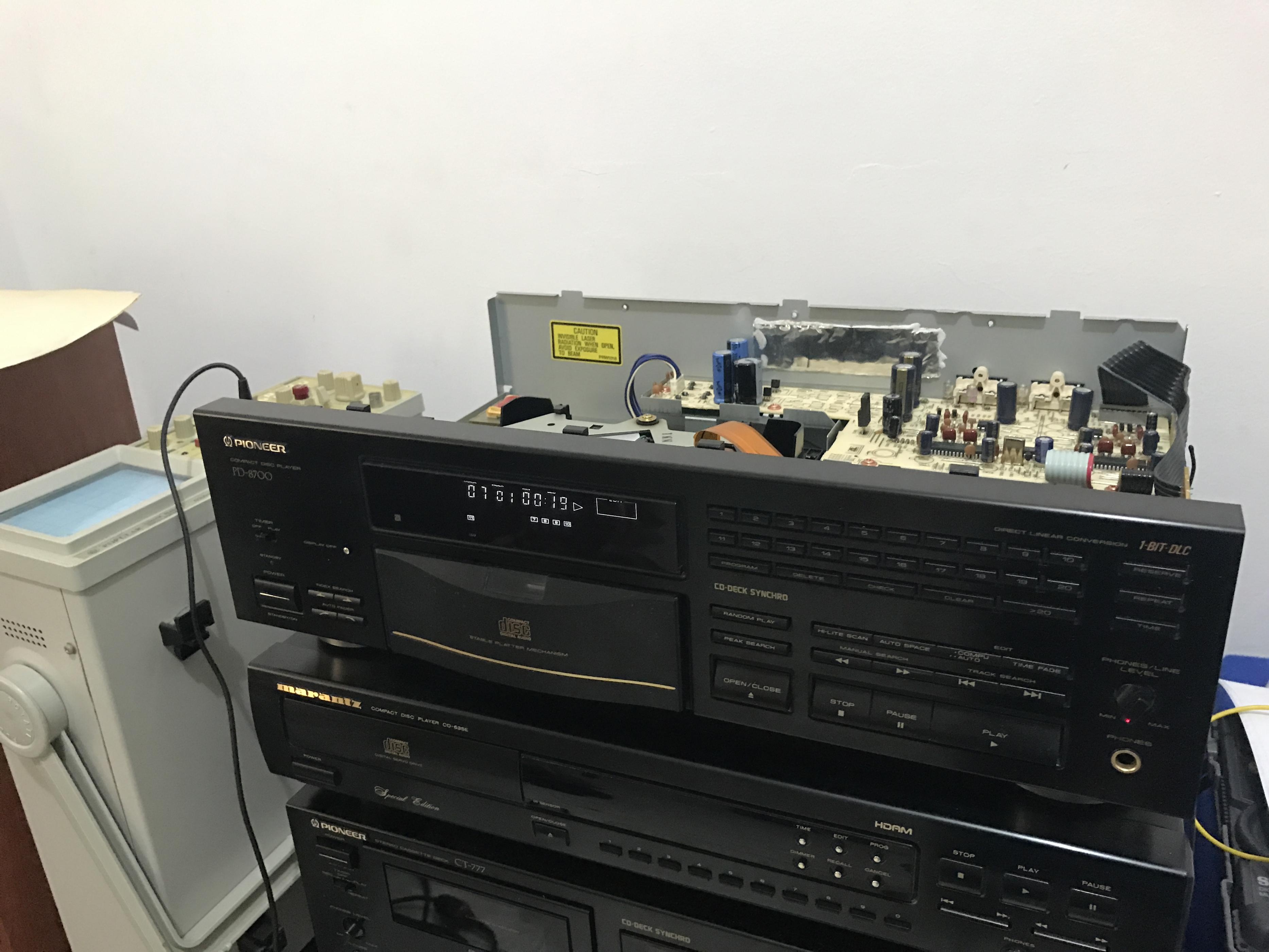

Have you an Oscilloscope? Can you look at the RF Test Point?
With a disc loaded, when you press PROGRAM do you see any signal?
I suspect you won't, or it will be very small, too small for the player to recognise, hence no play.

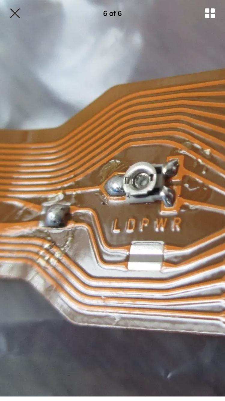

Not normally recommended but a small and I mean small turn of the Laser Power potentiomemter on the Laser itself may spark things into life. I'm afraid I can't remember which direction is 'Up' so make a note of where the potentiomemter is before you start and try it both ways.
I do suspect the Laser is at fault.
P.
Hi P,
Are you refering to below potentiometer?
That's not the picture, mine has the solder bridge removed.
OK, so adjusting didn't help. Put the pot back to where it was.

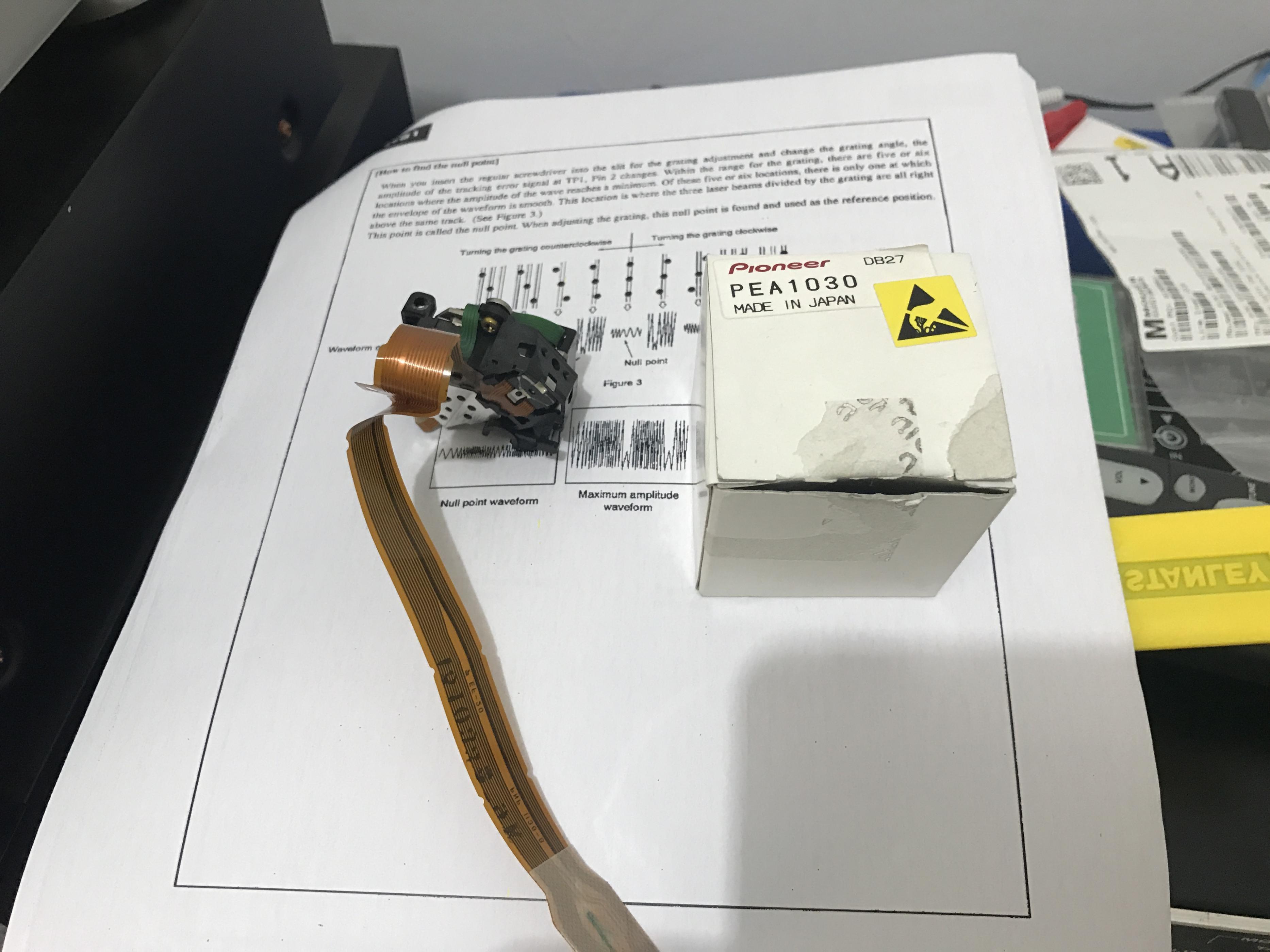

Of course it could be the RF Amp IC (IC101) but I can't ever remember having to change one of these. Of course just because I can't remember changing one doesn't mean they don't fail. It could easily be this. I have changed many RF Amps in Philips machines.
However, I do remember changing hundreds of PEA1030's !!! These were not Pioneer's most reliable Laser. They had a bad habit of the Lens falling off !! (Yours doesn't look like it has ever been glued back on does it?!?!?!)

Hi Percy,
I did adjust the Focus Offset to 150mv.
I can also see a small flickering on my scope whenever I press PLAY that's in reference to pin 1 TP1 but I cannot hear any focus adjust from the LENS if I rotate the DISC Manually.
I might change the LENS but the part is 6X expensive than what I paid for this CD player
Do you have a spare LENS/Optical pickup?

Do take note, it is -150mV. That's Negative 150mV. On these Players with the 'Stable Platter Mechanisms' where you put the disc in Label side down and the Laser is 'upside down' you have to adjust the Focus Offset to a Negative value.
................Do you have a spare LENS/Optical pickup?........................
Sorry, no.
My player doesn't use this Laser so I never 'stocked up' on the PEA1030 like I did for mine !
P.
Well,
I would say it's either the RF Amp IC or the Laser. And on a player this age I would say the Laser.
As you say the PEA1030's are not cheap.
A quick search on ebay reveals this.........
PIONEER PEA1030 LASER PICKUP (PNP-1138-B) - NEW in Factory Sealed box | eBay
and this but this is not new..............
http://www.ebay.co.uk/itm/Pioneer-P...438350?hash=item3d346b164e:g:rIQAAOSwZQRYbogV
I am disappointed that the Chinese have not made any 'fake' Pioneer Lasers. One or two of their Sony and Philips ones aren't too bad. I would think the demand is there for Pioneer Lasers. Ah well.
