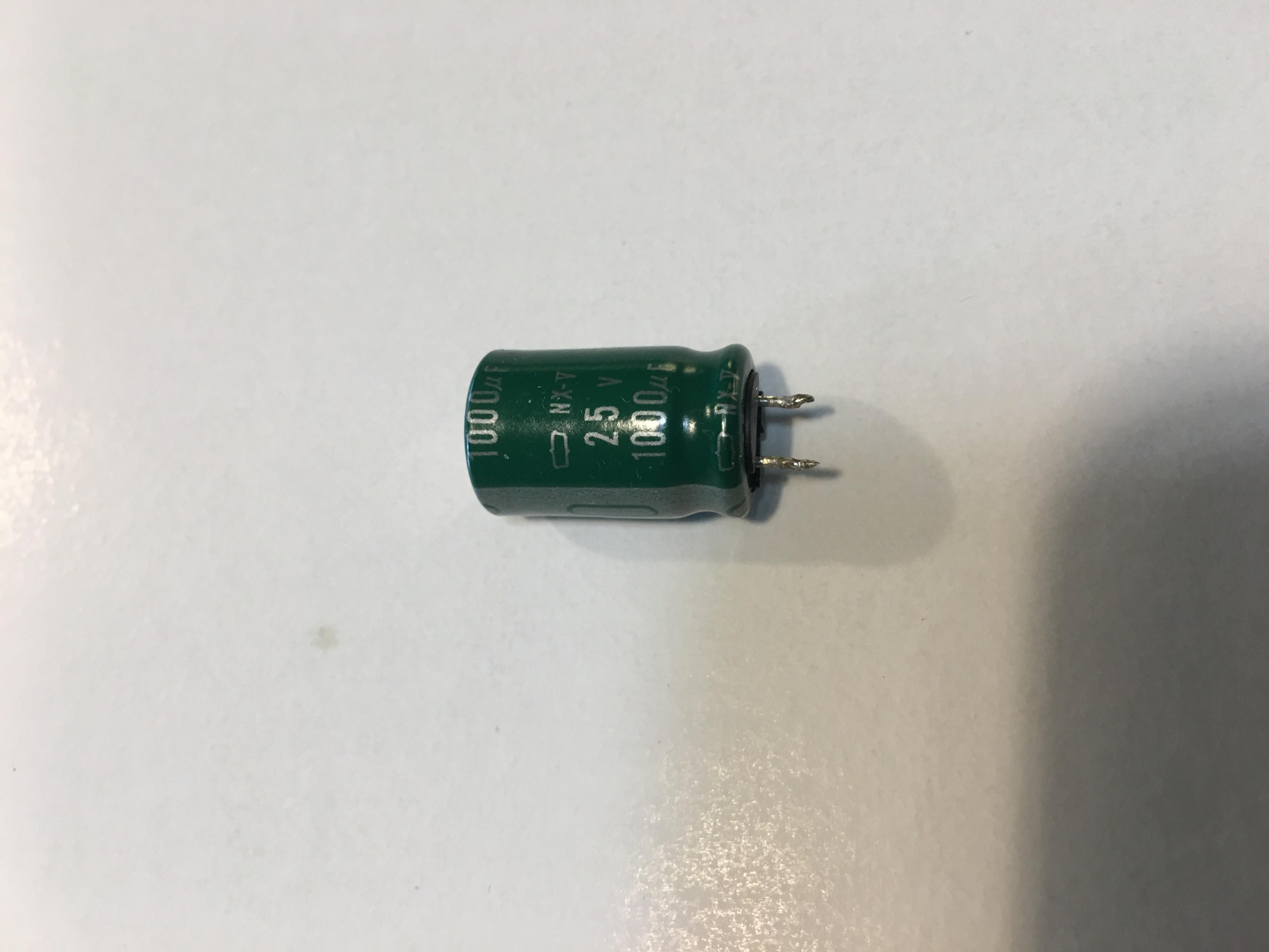

The power supply uses 2 different type of electrolytic and I am having a hard time matching them to the very extensive line of Nichicon caps.
I posted pictures of the difficult caps.
Any help would be appreciated.

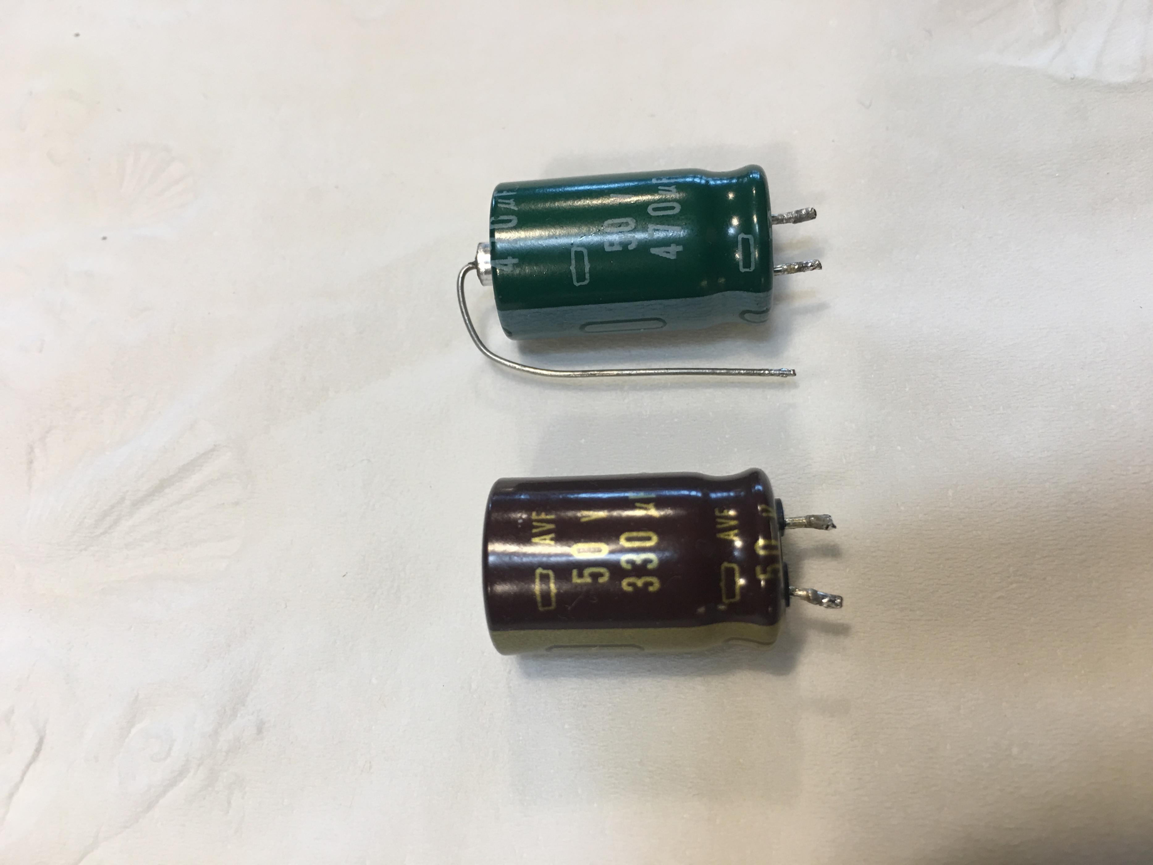

Pictures show a cap of 470/50V with an extra lead at the top. Seen them many times but not common. Any ideas why this is needed?
The brown 330/50V cap is significantly bigger than same values in the green line. This one is described as a CEXA type by Pioneer. What family would this one correspond to?

Is the lead coming from the top isolated from the the others?
if they are i can only assume that it provides some sort of shielding.
if the top lead is not isolated then is it a dual ecap? in other words you measure capacitance from each lead to the lead coming from the top.
I have not seen these in a ecap's in mfg's catalogues before, so I assume that they are specially made for Pioneer.
Do you have a schematic of this model so i can see where they are used in the circuit?
A-91D.pdf
They don't seem to be drawn different but I think the top lead is connected to the capacitors negative terminal on the pcb see caps C401~4?

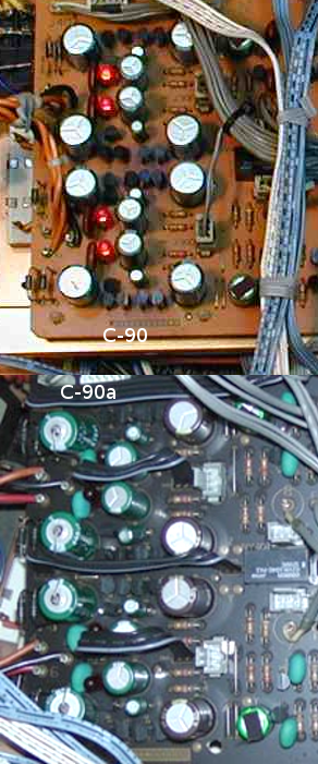

c-90a.html used the same caps
heres a translation
"I connected an aluminum case to the cathode of the aluminum electrolysis condenser more surely, and parts of the sound quality priority including the new development seal dead capacitor which controlled the bursting in of the noise from the outside, the jumping out of the noise from the condenser by a powerful shield were used."

Hello James,
Thanks for both links. In effect the extra lead is connected to the negative side or isolated. Have seen both cases. All my extra research has found that they added it for physical support. Apparently they did not want to repeat the glue fiasco with the M-90 amps and the glue that becomes somewhat conductive and corrosive. On the other hand they are not big at all and wonder why the need to secure them extra.
The curios part is that all these capacitors are used in a power supply setting, with the copper oxygen free lead unit (brown case AVF) used as filter. Three levels of filtering with 3 different kind of electrolytic capacitors is interesting at this level.
I was able to find some more info at the Nippon Chemi-Con Japanese site, but nobody carries some of these in the USA.
And finally, the 3rd legged cap I have never seen in in any catalog. I am replacing them with the best quality Nichicon caps I found at Mouser.
