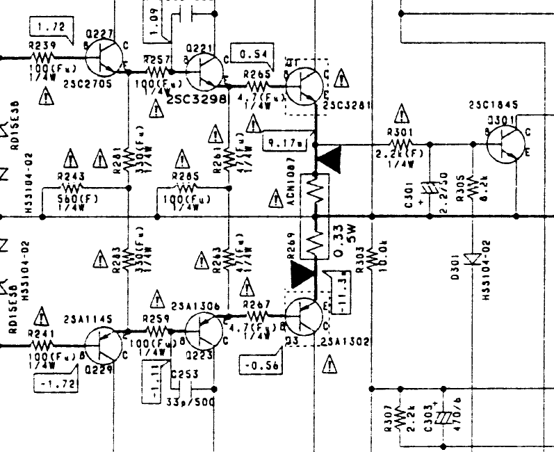

Small problem with Pioneer A400x - amp works fine but the protection circuit activates when volume is turned up or down - then the relay clicks and music starts again. It appears that DC is getting to the outputs but only when volume is changed. I can measure it and also see the speaker cone move abruptly when doing so. All voltages measure OK as far as I can tell and the amp sounds good if untouched. Any guidance much appreciated!
thanks - the pot seems clean and there is no scratchy sound when adjusting volume. There seems to be some DC at the pot. There is no DC at speaker outputs when untouched, but quickly rises on adjusting volume kicking in the relay.
There are 2 small electro caps and 4 ceramics at the pot - would they be likely suspects?
Have taken out the 2 2.2uF - they measure fine and look fine.
Have rechecked voltages and there is one that may be unusual. The schematic reads -11.3V at the emitter resistor and I'm getting -1.3 V - all other voltages good. The same reading both channels by the way.

No, must be an issue on the power amp input side. (It's a DC-coupled feedback circuit.) Measure DC levels there. Gain at DC should be unity, so I'd imagine your DC offset would appear there as well. Definitely something weird going on. Check input-side ground potential, too - if that is floating, strange things could happen. If it comes in via a plug-in ribbon cable, that may need cleaning up...

That shouldn't be happening. Can you verify with another source?
2.5 V sounds like an older model iPod with an AC-coupled output, +5V audio supply and output coupling caps that have seen better days. That said, the volume pot would attenuate this quite severely.
If this happens with any source and the volume pot does not reduce these 2.5 V, verify low-impedance connection between all of:
* RCA input ground
* power amp input ground (C203, R203, C211 etc.)
* speaker (-)
I wouldn't be surprised to see an open somewhere.
Incidentally, why C201/202 are oriented with (-) facing the volume pot is anyone's guess - I guess there's a slightly under 50% chance of them not working as intended if faced with severe DC either way. A pair of 4.7µs connected back-to-back ("poor man's bipolar") would be a good upgrade option if you happen to have any at hand.
Thanks you so much for your help. While messing around at the input area the problem suddenly disappeared so i assume there is some sort of short happening in that area. It seems to be working fine now - no more surging speakers or relays clicking off etc. I will try to recreate the fault otherwise it is bound to return!
