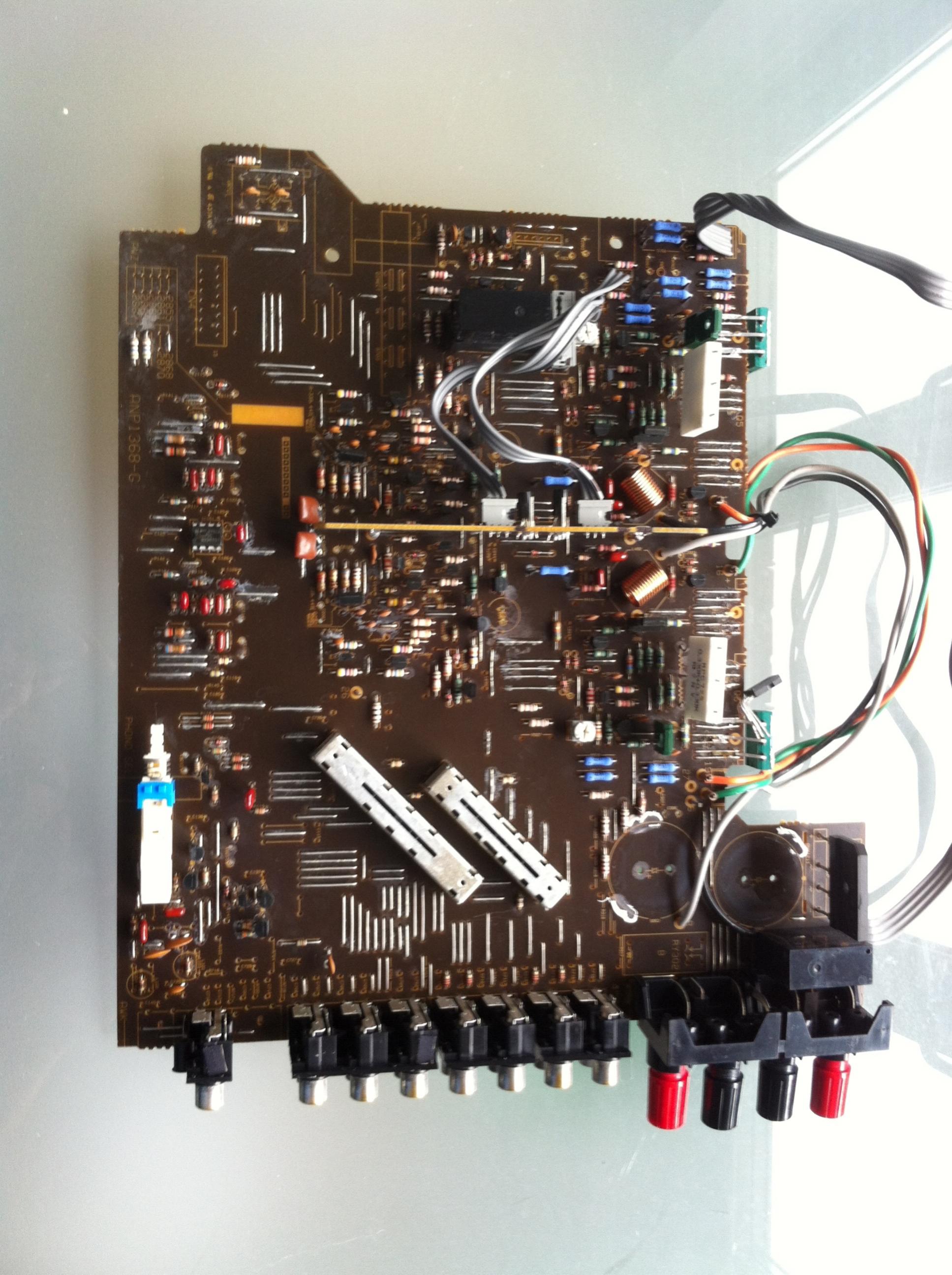

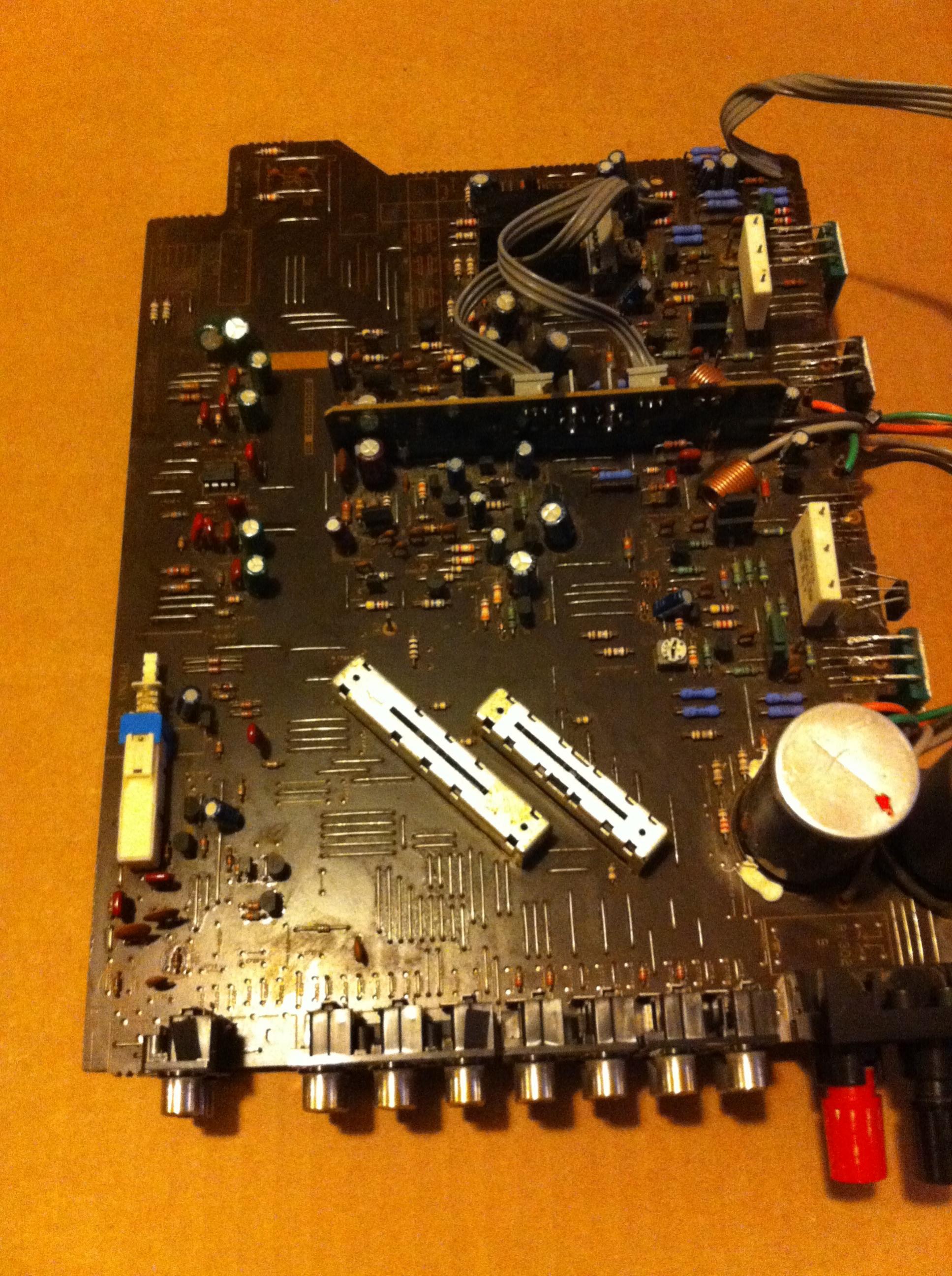

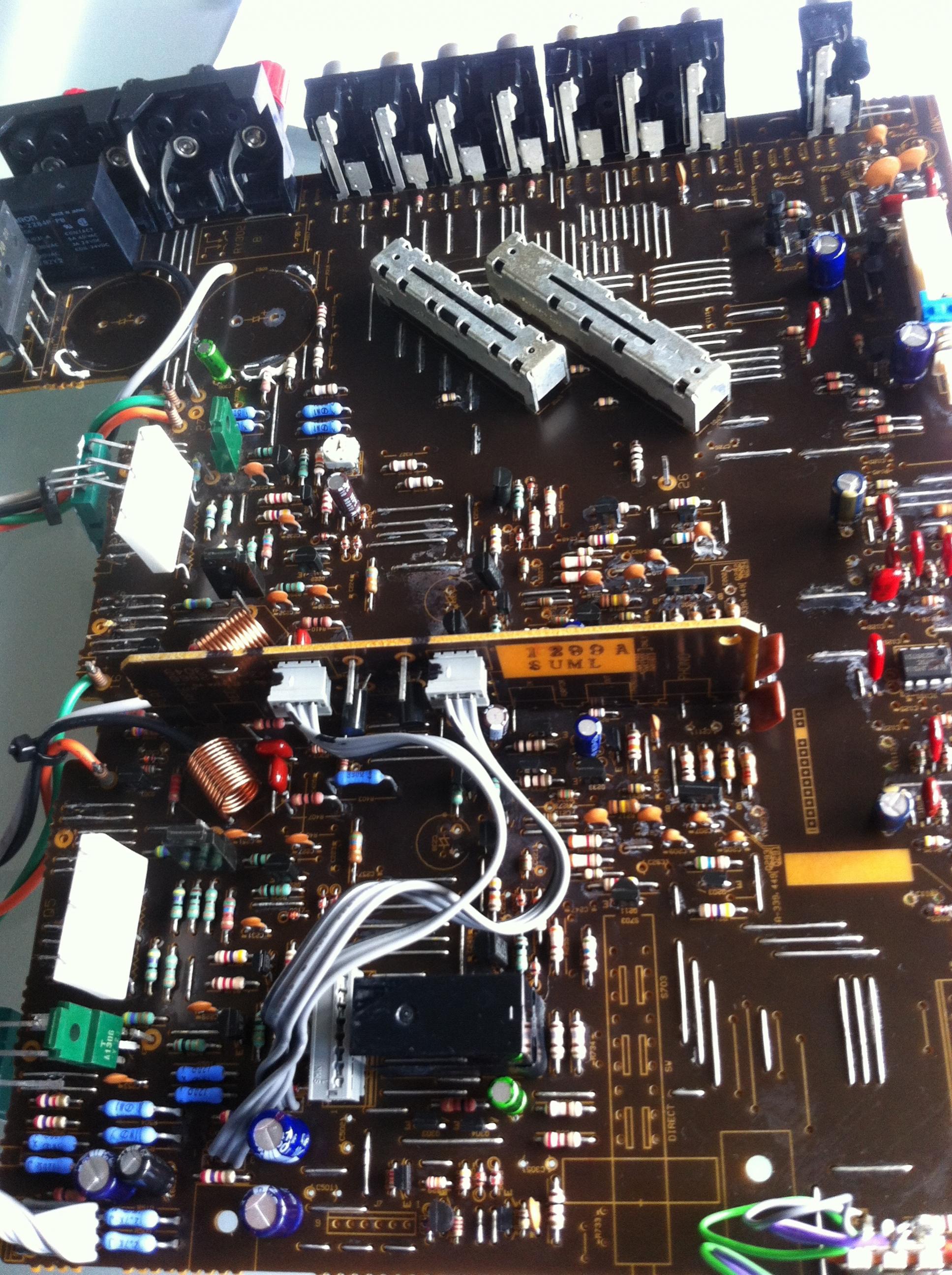

Unfortunately the concentric pots proposed and other ones I found on Ebay do not match the dimensions of the OEM pot. Bummer.
So really that leaves us with option 2 i.e. linear 220K with a shunt 47K resistor to fake log law. I was thinking of using a trimpot for the shunt resistor to do the 1-off calibration you were talking about to improve tracking between channels. 27 turn 100K trimpot should be good.
Thanks infinia I think i understand, it's 220K//47K so as to maintain the input impedance / loading of the preceding stages. Makes sense.
FWIW I measured the resistance of the carbon track for the tap and that was in the ~200 ohm range, which is not much compared to the 10K resistor after the tap point in the original OEM setup.

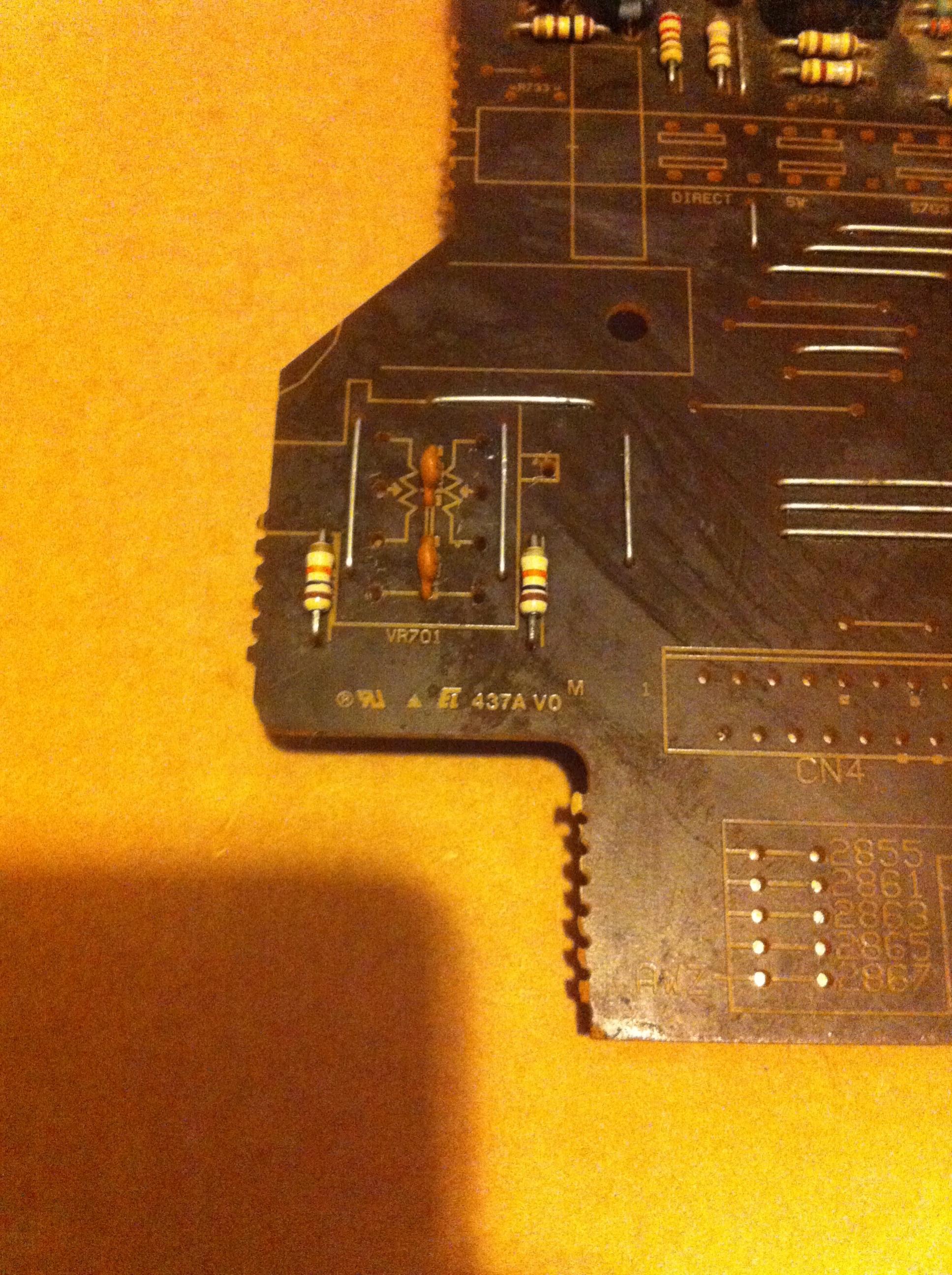

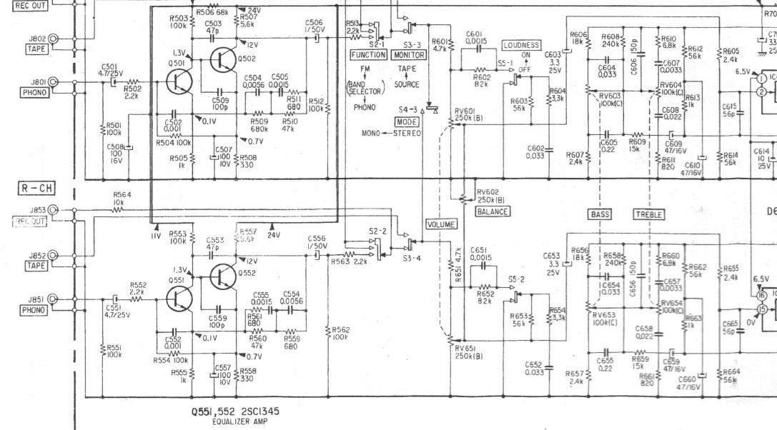

As to those ceramics the schematic makes it look like they are shorted across the ground, maybe the are tying two ground points to shunt RF, I would only change them to ceramic NPO/COG or silver mica if thats the case...
That would be a good explanation but I don't understand why have chosen to join the 2 grounds right where the pot is - there's plenty of space elsewhere on the board.
The original pot has a 9th leg connecting the pot case to pcb ground, so maybe the purpose of the capacitors is to decouple the pot from pcb ground?

That's the pot I ended using up - very similar to the original part but to be honest could have used any standard lug type.

Okay question for the experts...
I have been thinking... given the difficulties finding the right pot with loudness taps these days, would it be possible to ...emulate loudness taps by means of resistors soldered on the CW & CCW legs of a normal 3 pin pot?
See attached sketch to see what I mean. The pots are 100K in both cases.
I guess another option for the emulated pot could be a 100K pot with 30K & 20K resistors (more loudness effect) or even 120K & 80K resistors (less loudness effect)?
Would it work?

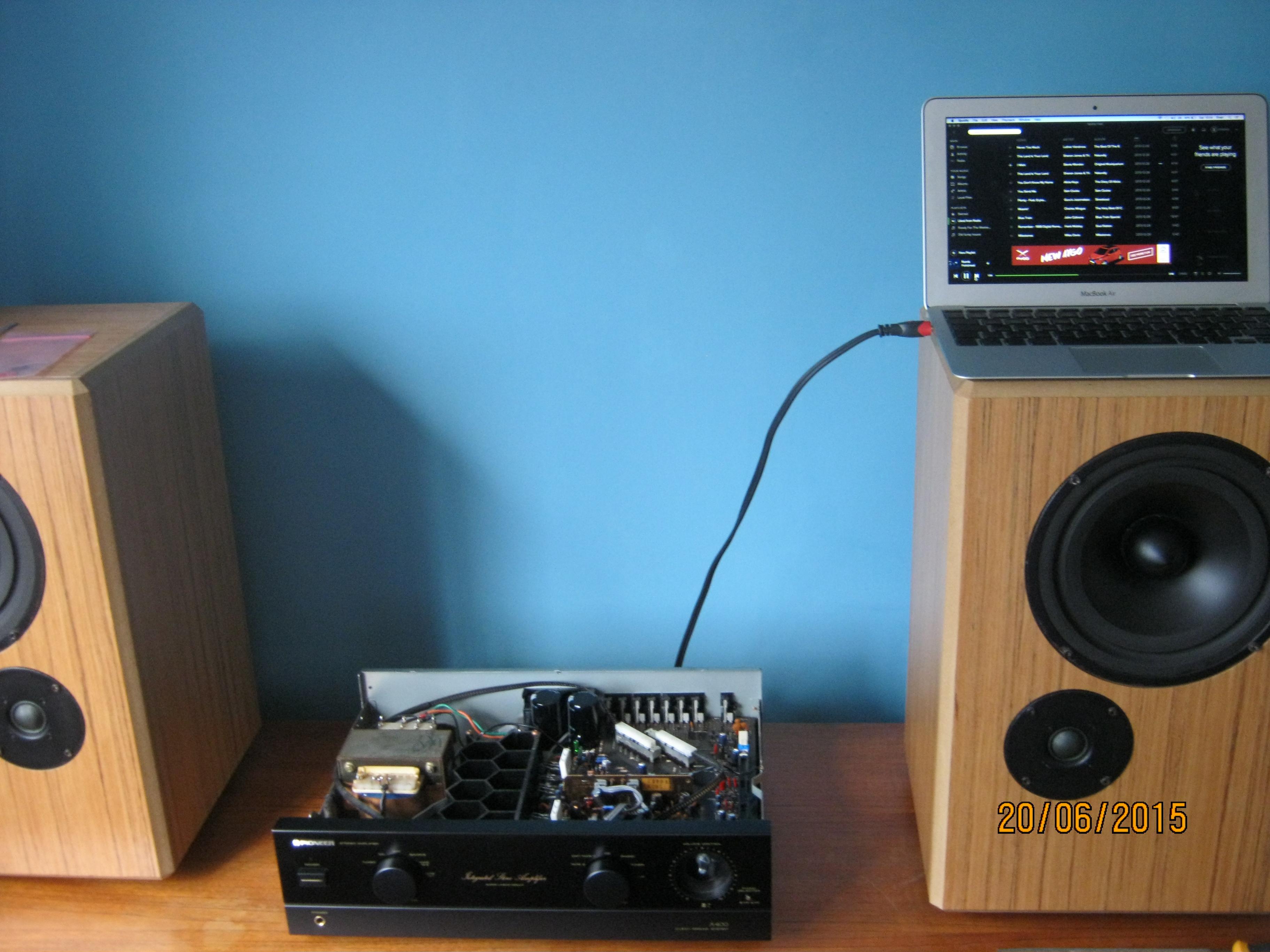

She sings beautifully!! What a great little amp

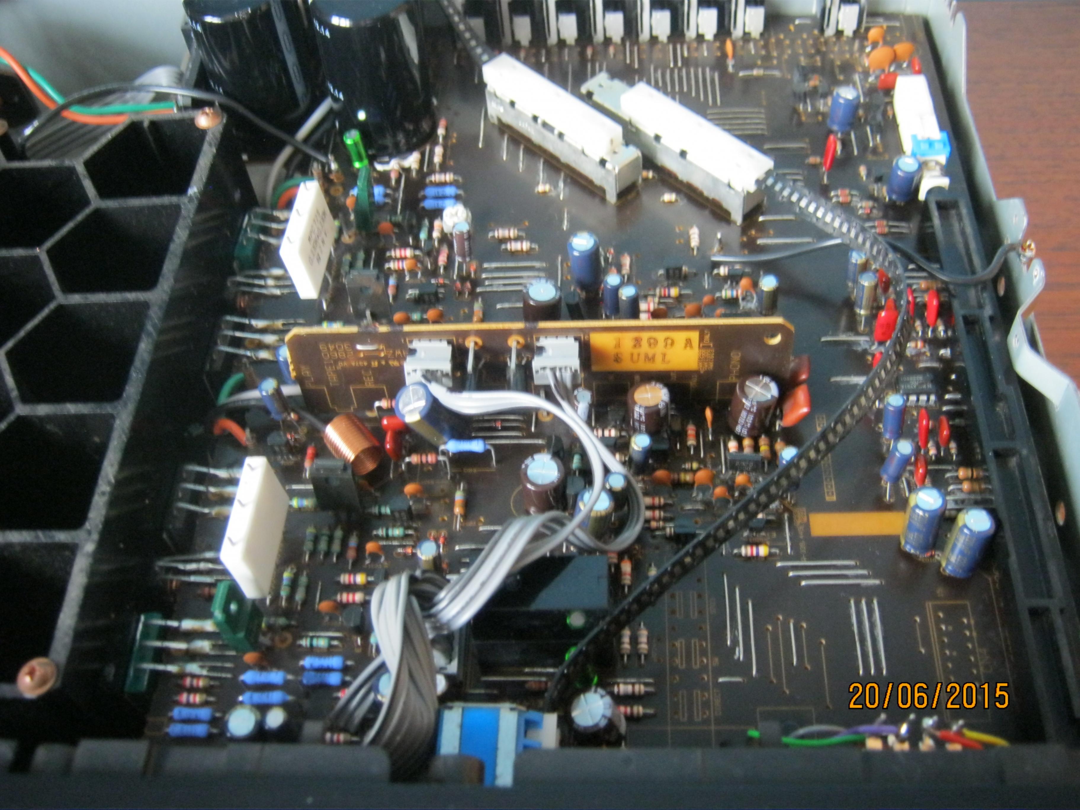

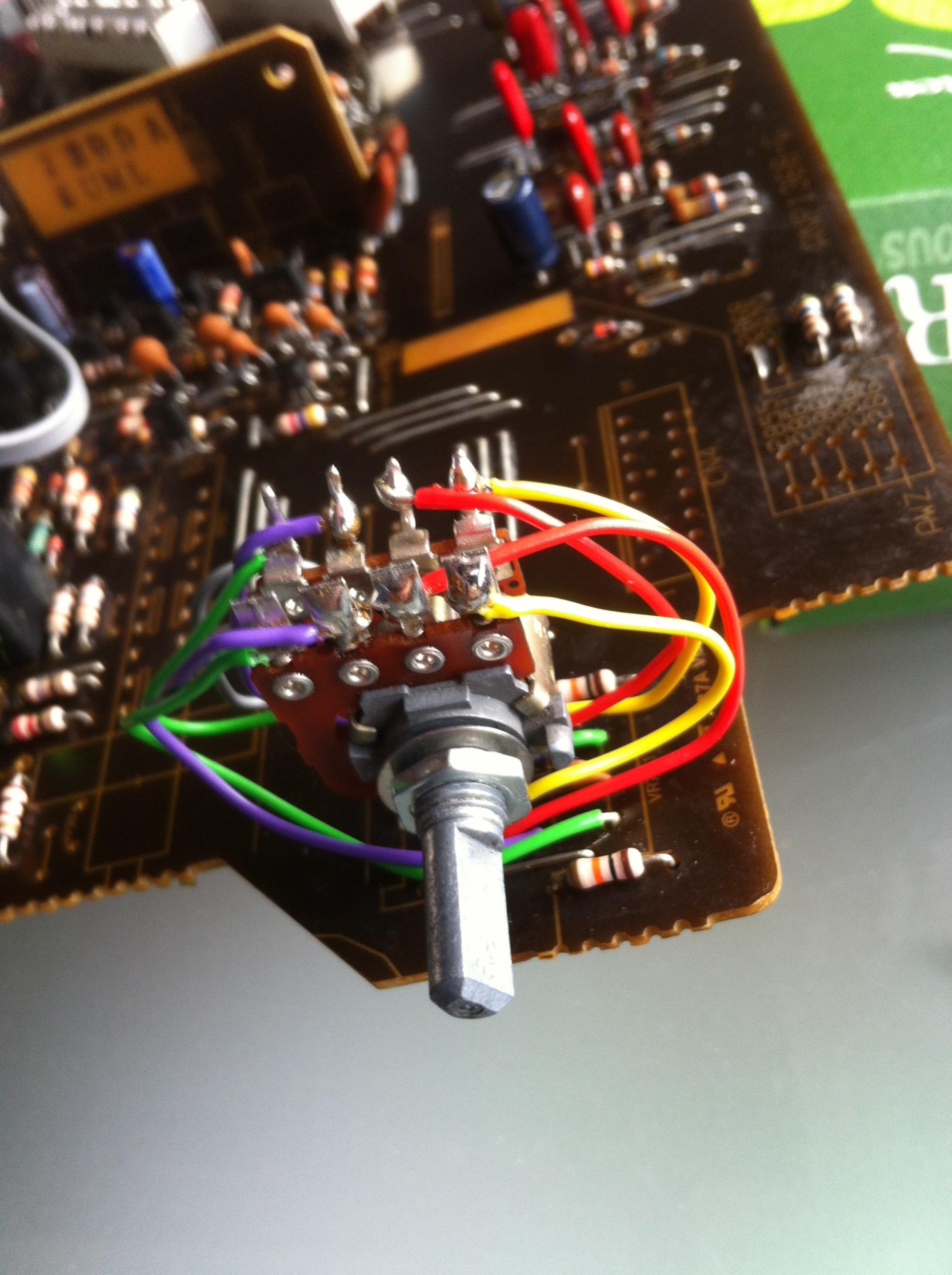

The replacement linear ALPS pot worked a treat. Panasonic FC for most places and Nichicon for recapping are always a good choice. I used EPCOS (TDK) for the main filter ones this time, they're great... plenty of kick!
Nice,now let all the tweaks burning in for 2-3 months maybe more and you are fine. 😀
Really that long is not necessary, 2 days of running is enough to get those electrolytics going.

Hi Chatziva,
I have the same trouble as you did and have managed to get hold of the same vol control.
Did you just do a simple wire from circuit board to control. I also notice from your photo a wire going from pin 9 at the back, i presume this is soldered onto the rear of the vol control.
