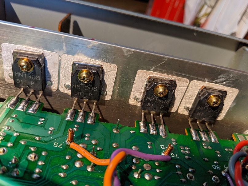

Well, of to the shop it went - back on June 4th. Just got it back yesterday.
16 weeks in the shop. I was about to jump in the car and just take it home since it was there for sooooo long.
The four power transistors in the left channel were replaced. The originals:
Sanken A1104(x2) and C2679(x2) were replaced with Sanken MP103S(x2) and MN103S(x2)
The guy at the shop told me the replaced then with new Toshiba parts. I guess he was a little mistaken.

Hi, didn't they replace anything else?? Seems unlikely that the output transistors just failed on their own, and without any collateral damage.
Also, are you sure about this: "Sanken MP103S(x2) and MN103S(x2)" ? - these type codes sound wrong..

Those original output transistors could also have been subbed by a number of current Sanken types, assuming that's all the problem was. Take a look at this thread: 2SA1102 vs 2SA1104 with 2SC2577
I don't know where MN103S and MP103S type transistors come into this either - they don't appear in Sanken's catalogues so they must be from another source or those are house codes for a specific client.
This is a photo of the replacement output transistors.
The initial estimate for the repair was 6-8 weeks. No complaints, just stating facts. It's a good shop and they are very busy. Every time I called (past 8 weeks) it was stated that they were waiting on parts. I was told that they put in new Toshiba transistors - clearly not. They look used to me. If I were to guess, I'd say they came out of an old Onkyo. It was stated to me that they also replaced the drivers on that side and a cap. They also resoldered the ringed solder joints as they found them.
It works, and it sounds good. Just wondering how long those Sankens are going to last.
Type codes corrected above - they are 130s NOT 103s - mistype on my part.
See attached photo above. I'm guessing those 130s were either NOS or came out of another unit - maybe Onkyo?
I'm pretty sure he said he also replaced the drivers but they are difficult to see/photo and are shrouded by small heat-sinks. He also said he replaced a cap and repaired all of the ringed solder joins he could find.
Sorry for the typos above, here is a photo of the transistors that were used in the repair
They are MN and MP 130S with an Hfe rating of "P"
