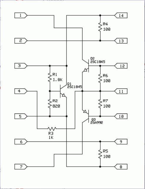

By understanding the schematics of both, the IC ("internal" schematics, as I posted previously), and the amplifier schematics. I suppose there are two ways about it: you either use this amp as a testbed (for learning/experimenting), or - you give it to a good electronics technician/ engineer who could get it going for you.
If the first option seems viable to you, I suggest you start with a simple BJT amplifier circuit, and what voltages you'd expect to see if it is used as an amplifier. Some understanding of the current runs around the same circuit will be required, as well as the proper biasing to get that BJT to actually amplify voltage or current. You should also know how the typical NPN and PNP BJT's measure between 3 pins, in all "directions" - with an ohm-meter, and with a diode tester. For this, you'll need to have some idea of a semiconductor BJT construction... Then you can move to simple 2, or 3-gain stage designs.
