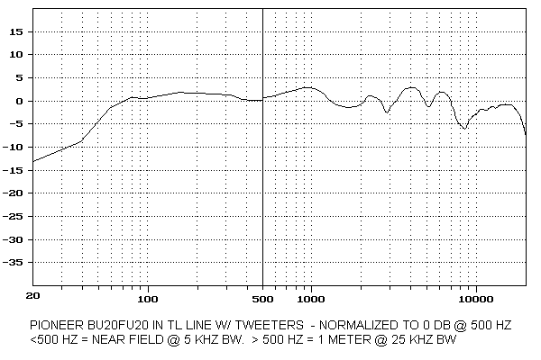

Nelson:
Sorry - I realize that you wrote "Thus ends my micro Bu20Fu20 article" but I have a couple of questions:
1. How far down is the B20 in the TL? If your diagram is to scale it looks like it is about 8.5 in (from the inside).
2. Did you find the need to add a BSC? When I simulated the TL using Martin King's TL Sections worksheet it appears that a BSC is needed. Something like 5 ohms and 3 mH seems to be right.
