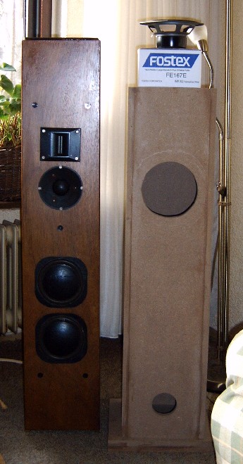

Good looking speakers
Either they are huge or that person is tiny 😀
How much did they cost you all-in-all?

Nice pictures
But how does they sound????
