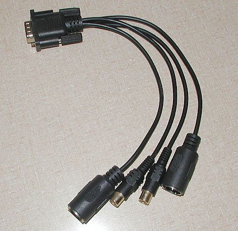

Here are some photos of my own breakout cable that was supplied with a new Audiophile 2496 card
Perhaps you can figure out the connections you need from these
photos - (no guarantees)
This first photo shows the entire breakout cable - it has a MALE
9 pin connector that connects to the card
It has two female 5 pin din connectors and two rca type female
connectors
One of the 5 pin din connectors is labeled "out"
and the other 5 pin din connector is labeled "in"
One of the rca connectors is labeled "out"
and the other rca connector is labeled "in"
I will post other photos to show how the pins on the MALE 9 pin
connector relate to the female 5 pin din and the female rca
connectors

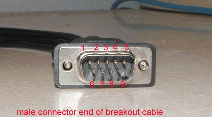

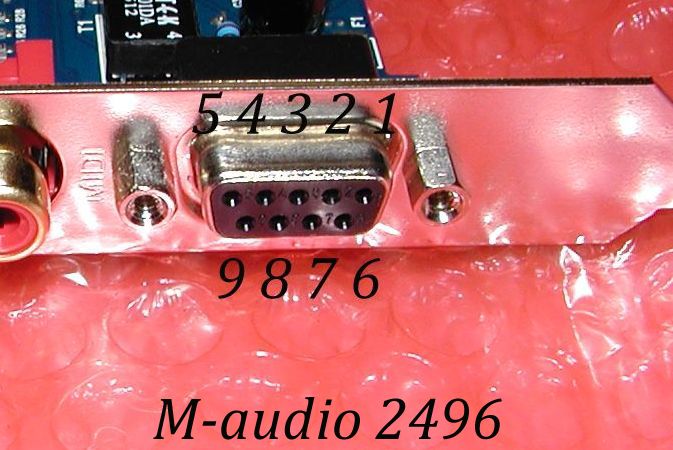

attached is a photo of the 9 pin connector on an M-audio 2496 card
with pin numbers added

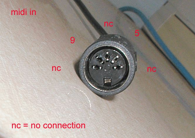

pins 1,4,6 go to a female 5 pin din connector labeled midi out
pins 5,9 go to a female 5 pin din connector labeled midi in

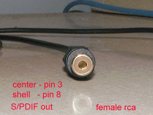

pins 3,8 go to an rca female plug labeled S/PDIF out

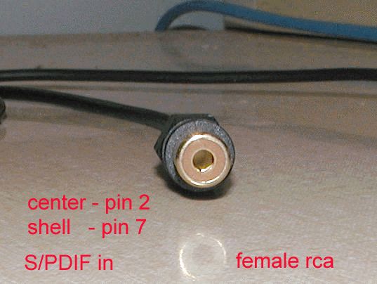

pins 2,7 go to an rca female plug labeled S/PDIF in

in order to complete the info above : here is polarity (only for the audio digital in-out) :
SPDIF out => pin 3 is + , and pin 8 is - (rca)
SPDIF IN => pin 2 is + , and pin 7 is - (rca)
I don't know the polarity of the other connectors (midi in/out).
