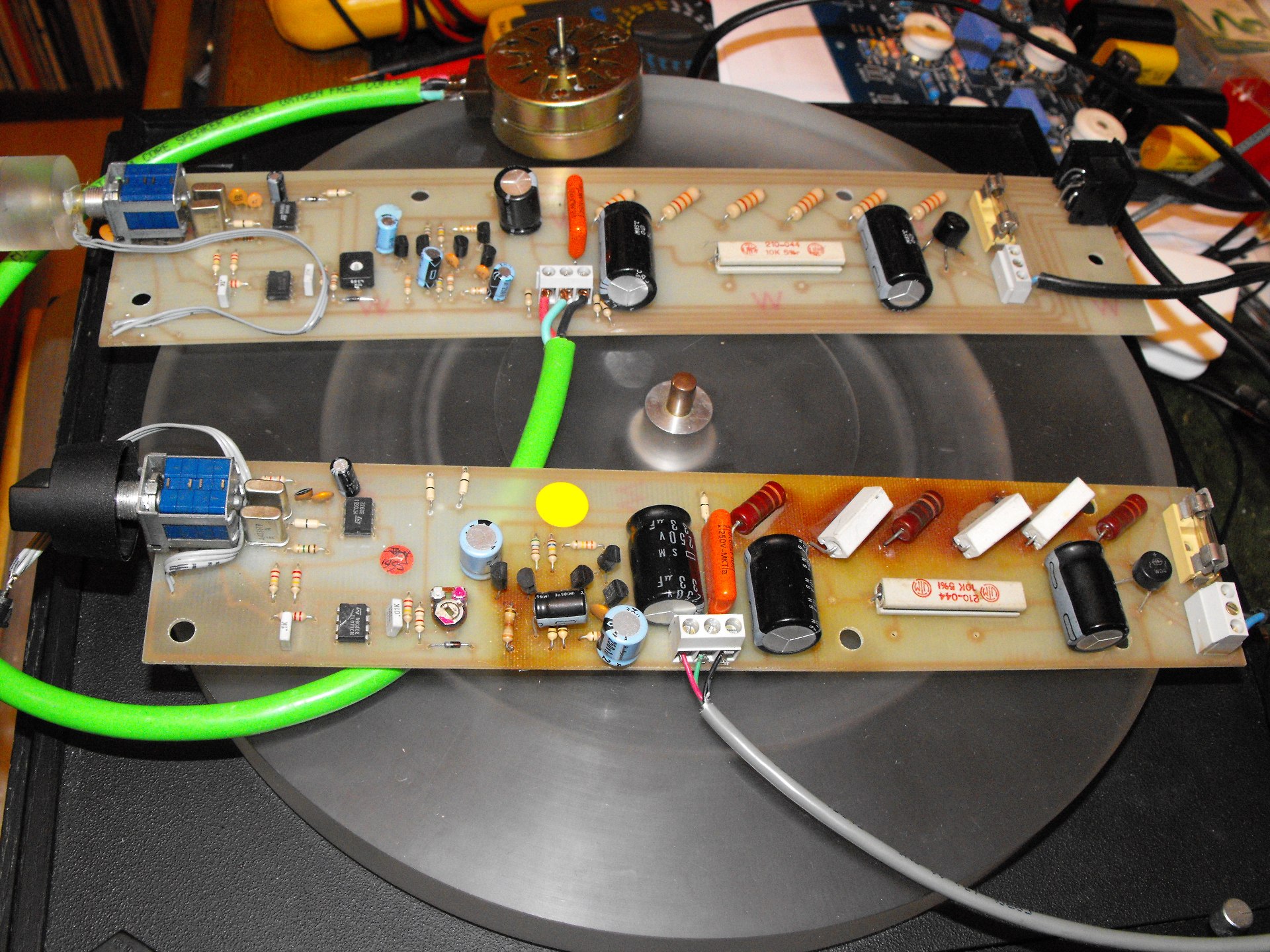

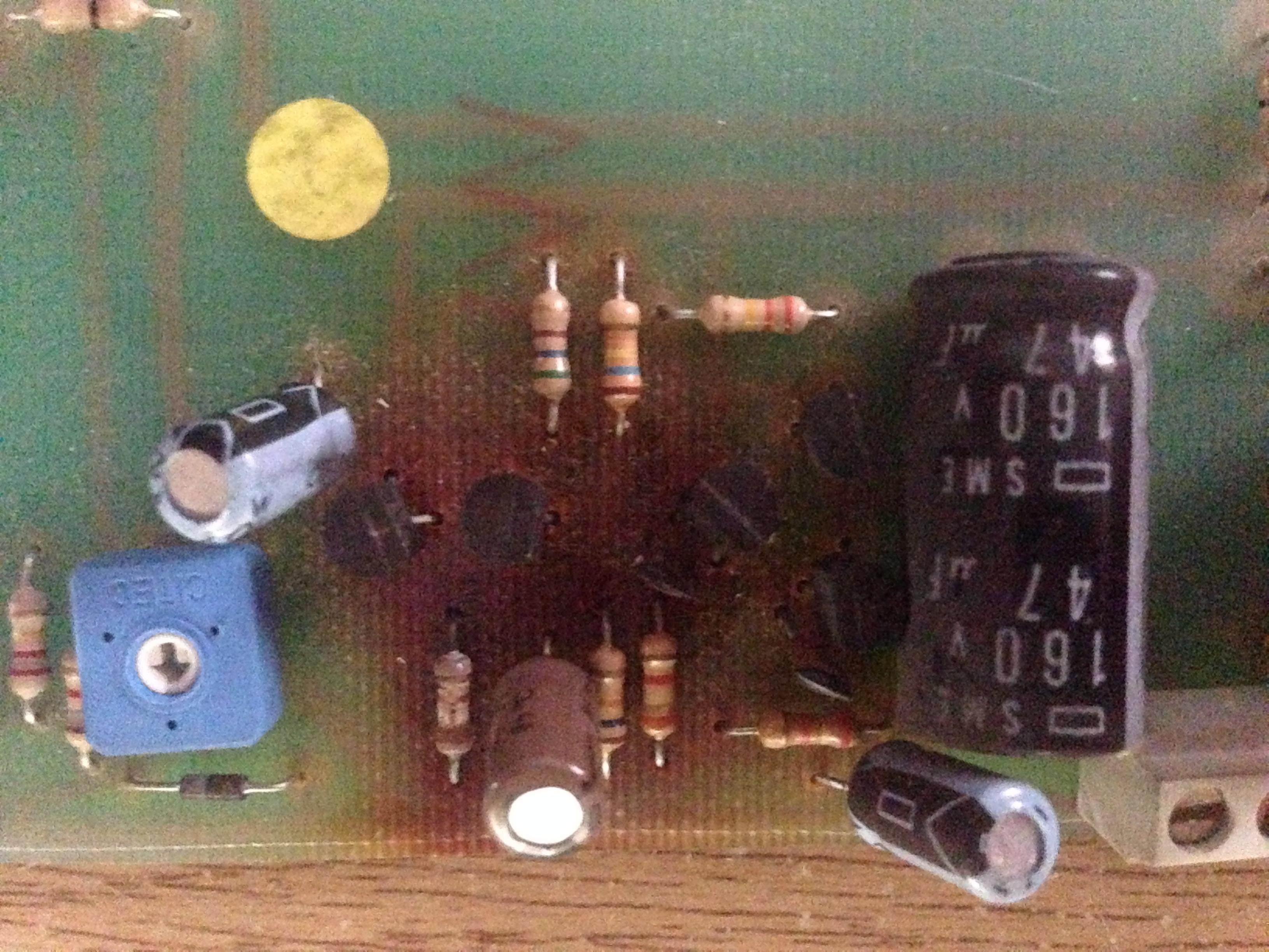

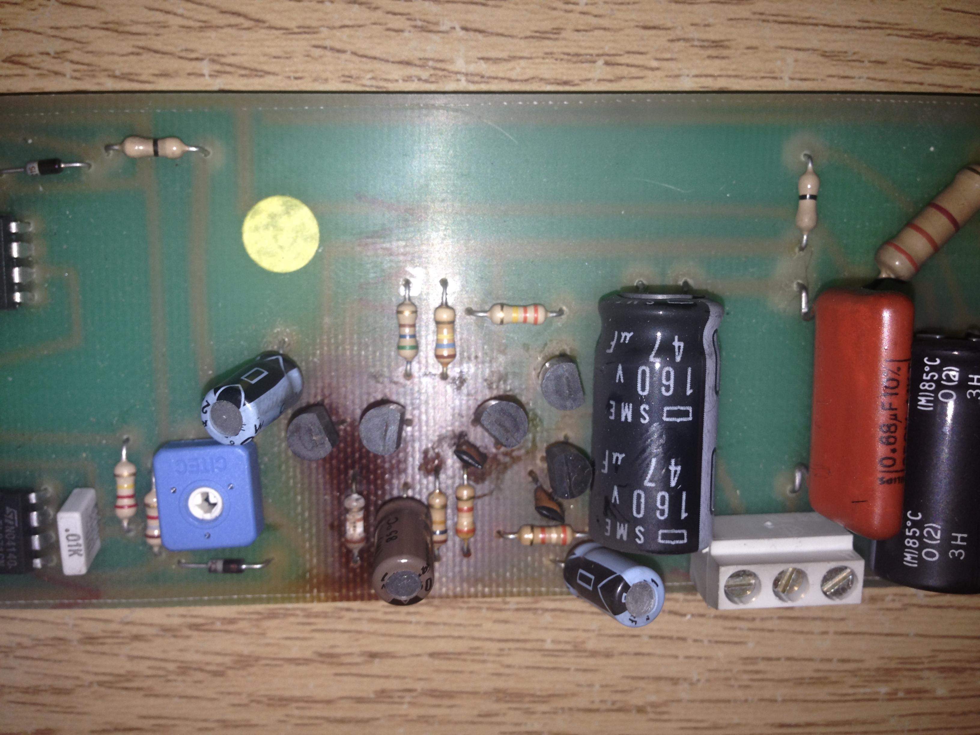

I have problem with my PT LPT turntable. The motor is struggling to start and vibrates. If I give it a helping in hand it will spin up but very slowly. I have read many threads about these issues and suspect that resistors are probably ill where the PCB gets hot. My issue is I can't see the bandings on the worst resistors and therefore not sure what to purchase. Therefore looking for a little help if anyone has had similar issues or a PCB to hand or circuit diagram to help identification please?
I looking for the resistor to left hand side of the capacitor towards the pot.

...I looking for the resistor to left hand side of the capacitor towards the pot.
If you look at this from here, the resistor appears to be identical to the 2nd resistor on the opposite side of the adjacent electrolytic capacitor. The colour code appears to be ORANGE (3), WHITE (9) AND RED (2) which has a value of 3k9 Ohms. However, judging by the scorch mark on the PCB, I'd say that there is something else duff on that circuit board.
Might look at using a higher power resistor off board, and try to identify what the transistors are and select something similar with a somewhat higher dissipation rating. I owned a PT turntable a couple of decades ago, complete and utter nightmare; I wish you the best of luck!
There's an update here that suggests the burnt resistor is 39k - ORANGE (3), WHITE (9) AND ORANGE (3)!
N.B. I do not have any first-hand knowledge of the LPT circuit board, but from what I can see from the available pictures, it doesn't appear to be too complicated.
Good Luck!
I have the same issue but ive decided to go a slightly different route.
As the LPT board isnt really fit for purpose Ive thought about going down the simple psu route ala naim armageddon, basically just a transformer and a phasing cap. I know itll only be single speed but i just want a quick fix until I can afford a gyrodec.
