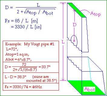

Thanks. The design looks somewhat familiar but it's apparently an original design by the owner of the website linked. I was wondering what he was using for calculations.
I have something I downloaded from the WWW a long time ago for tqwp but have never actually built anything with it and so have no idea if it works.
Andrew
Voigt formula
here you go.
