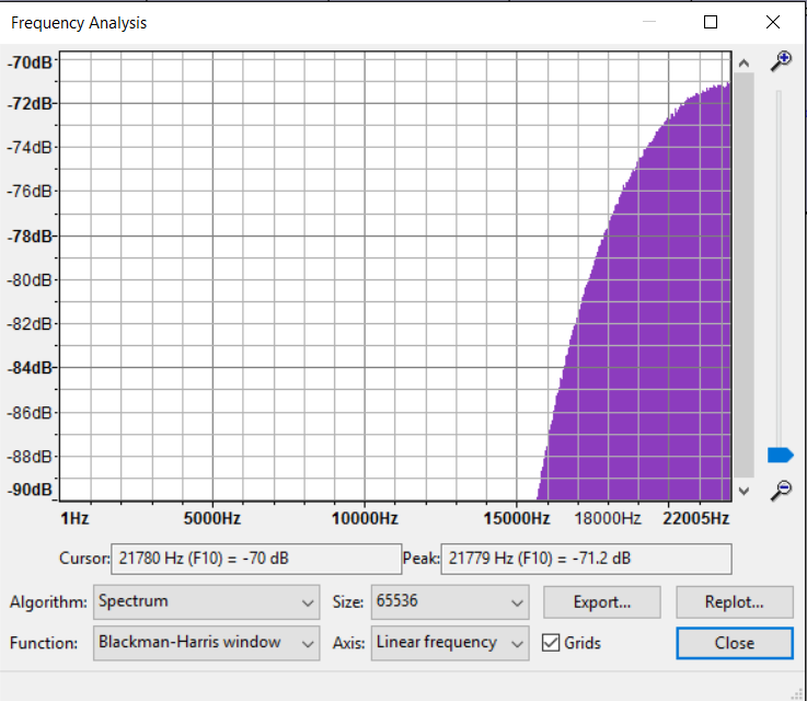

FWIW, if the Beatles mono remasters where fed into two different DACs (dual mono) then they are superbly matched. Below see the spectrum of the null result between left and right. The difference is boosted 40dB. Any difference is waaay down. But it's enough to make for a different checksum - thus not bit identical between the two channels.

I seem to remember reading somewhere about music tracks which had a low level 16kHz signal - from the Rugby VLF transmitter. If the mono signal was simply fed into the L and R channels of the ADC then the output would not be bit-identical, although it ought to be very close.
I've seen that in the spectra, but thought it was video monitors at 15,750.
