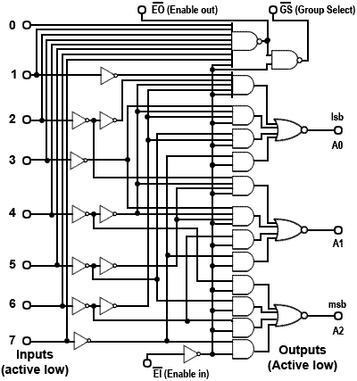

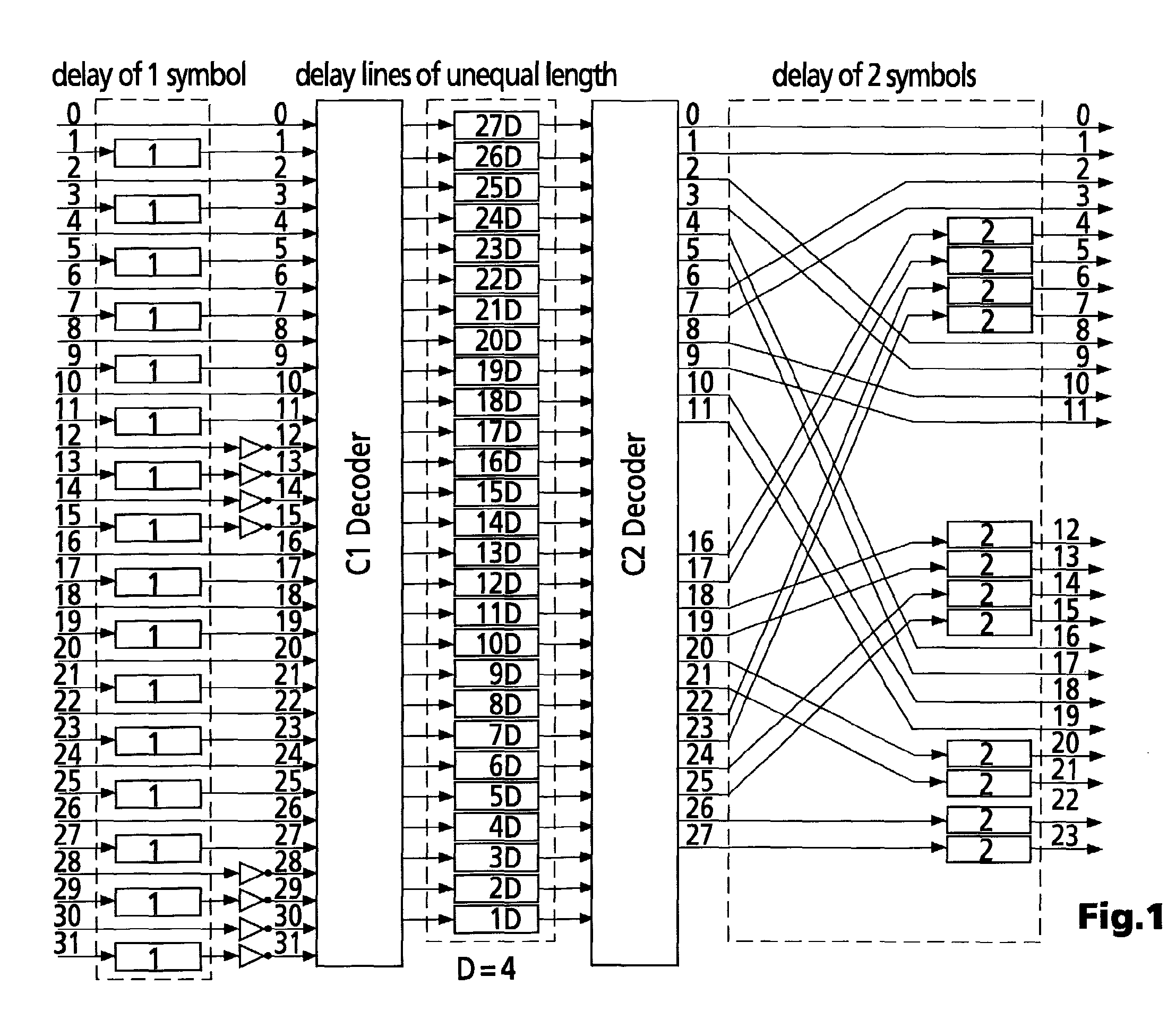

Circ for CD and how you might construct it. A bunch of logical building blocks that are hardwired together. No software, not even a CPU.

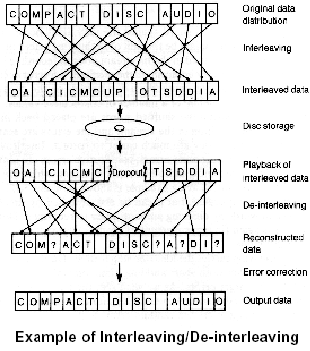

I like this one. Not very sharp, but it shows that despite a dropout, the original data is still correctly restored!
Jan
I avoided posting the original AES version, too much of an eye chart. We need to remember this all had to be done in 1980's technology. Before we leave the bit perfect discussion...
Data stored on CD-ROMs follows the standard CD data encoding techniques described in the Red Book specification (originally defined for audio CD only). This includes cross-interleaved Reed–Solomon coding (CIRC), eight-to-fourteen modulation (EFM), and the use of pits and lands for coding the bits into the physical surface of the CD

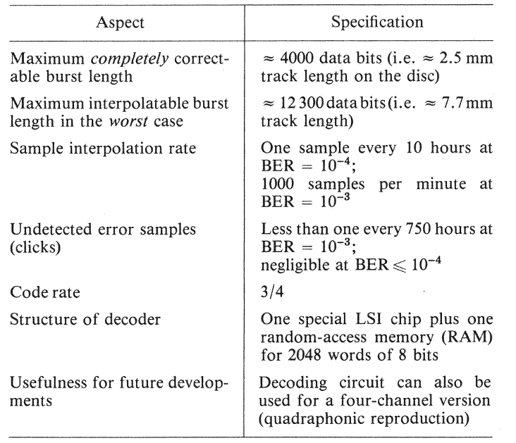

As usual, it depends. The inventors think it is like this:
http://www.diyaudio.com/forums/attachment.php?attachmentid=569131&stc=1&d=1473519591
(Hoeve et al. , Error correction and concealment in the Compact Disc System,
Philips Tech Rev. 40, 166 - 172, 1982)
I see they made the completely correctable clear. They also seem more optimistic than SY. Any data on BER performance of players? The falloff is rapid and I suspect e-3 is nearly pathological.
I'm surprised that no one commented on the fact that CDROM does not in fact use a more robust error correction. This should have been obvious from the overhead.
