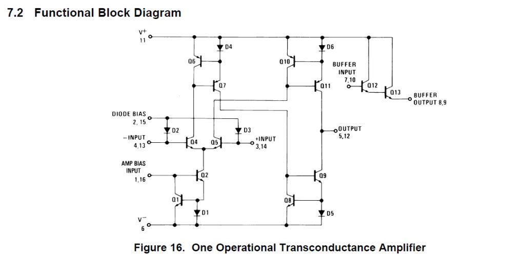

pin out of LTP current source?
LM3080 "transconductance op amp", Gilbert cell analog multipliers will let you do that
maybe some adjustable bias/BW op amps - but I don't remember any really explaining which currents are being adjusted in detail
