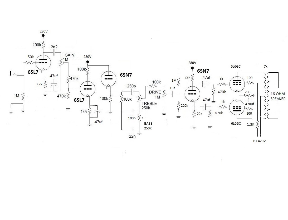

Whoops, forgot that cap - I have a .1uf cap between wiper and grid...forgot to show it...so take 220k from ground to point between new upper 1k resistor above 22k cathode? I thought about doing it this way...would I then get rid of 1M to B+ or keep it?
Corrected
