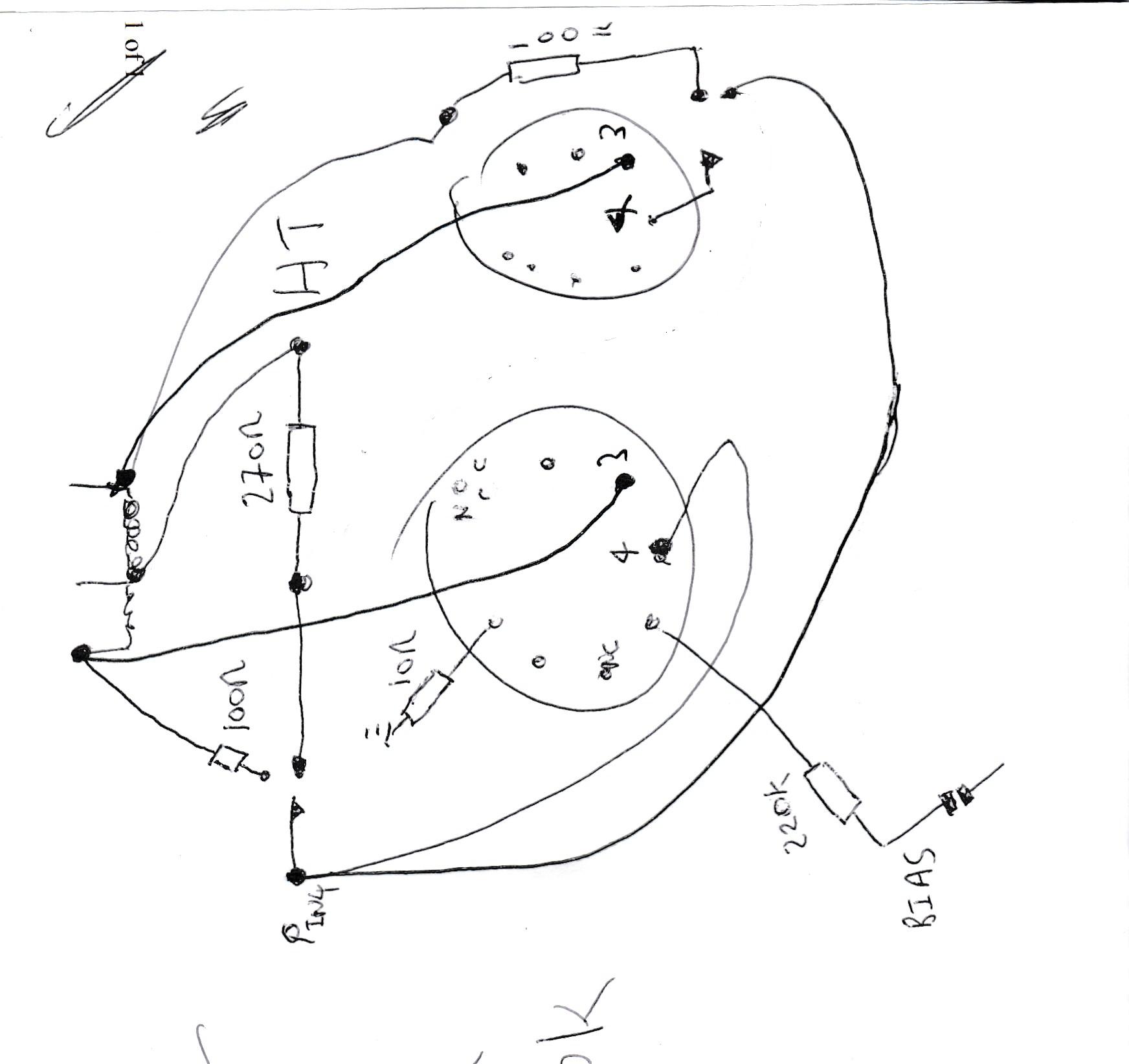

Hi again, can any of you guys she'd any light on the switching of the 270R resistor into the HT circuit? It's a bit confusing but it appears to come off the HT feed, into the switch that would switch from Triode to UL, so appears to just add it's series resistance to the 100R Grid resistors. Only one resistor, which feeds both halves of the PP?

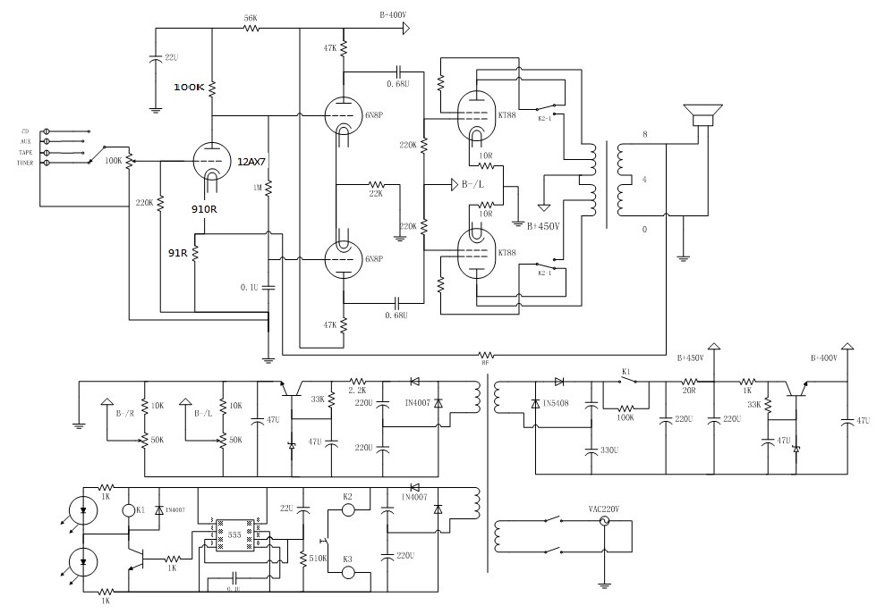

Hi, Lol, making some unreasonable assumptions from you guys.
I have attempted to attach the circuit to this reply.
Not sure if I've done it successfully, but I'm sure you'll soon let me know.
It obviously does not contain any info about the 270 R resistor, as this was supposed to be an UL Amplifier and from what I can see, this is something they done to simulate the 2 modes.
Please let me know if you can access the attachment, then we can take it from there.
Actually, that's your basic Triode/UL switch. The resistor going to the screen grid could be 270R, that would make sense.
- When the 270R resistor is connected from the KT88 screen grid to the audio output transformer's primary tap, the output stage is wired for ultralinear or distributed load operation.
- When the 270R resistor is connected from the KT88 screen grid to the KT88 plate (anode), the output stage is wired for triode operation.
Does the wiring in the amp agree 100% with the schematic?
Hi, I've had another look at it since I posted, it's a bit confusing for me not being a Tube Expert, but I made some notes while activating the switch/relay. Hope I've got it right, but feel free to ask me any further specifics. In one position, the HT routes via 270 ohms to feed the 2 Grids, in the other position, it switches 100 Ohms between Anode and Grid. This is where I'm confused. As I think you are saying in your reply, the Triode connection should be the position where the 100 Ohms is connected between anode and grid, but what is it doing in the other position? As I mentioned before, it can't work in Ultra Linear as it does not have an UL Transformer. Only 3 Primary Connections. CT and the 2 Anode feeds?
There's some confusion going on. The KT88 has two grids. Each one has a control grid (pin 5) and a screen grid (pin 4).
If you connect a 270 ohm resistor between the anode (pin 3) and control grid (pin 5), bad things would happen.
Are you saying the control grid and screen grid are connected together (shorted)? That would not be a good thing, normally.
Is that a different resistor? I thought it was a 270 ohm resistor. This is confusing.
Obviously, the schematic you posted is not the same as the amp you have. Please post a schematic that shows the actual wiring in your amp.
No, none of the switching is connected to pin 5, this is all centred around pin 4. There is only 1 270R resistors, but 2 100R.
The circuit I believe would have been correct for the amp if as I think, they didn't decide to cut corners and not fit an UL Transformer. The 270 Ohm resistor doesn't appear on the Diagram and there is no screen ident for it. That's why I think it was added as something that would work as an alternative to Triode Mode, a Sort of Dummy Pseudo UL.
