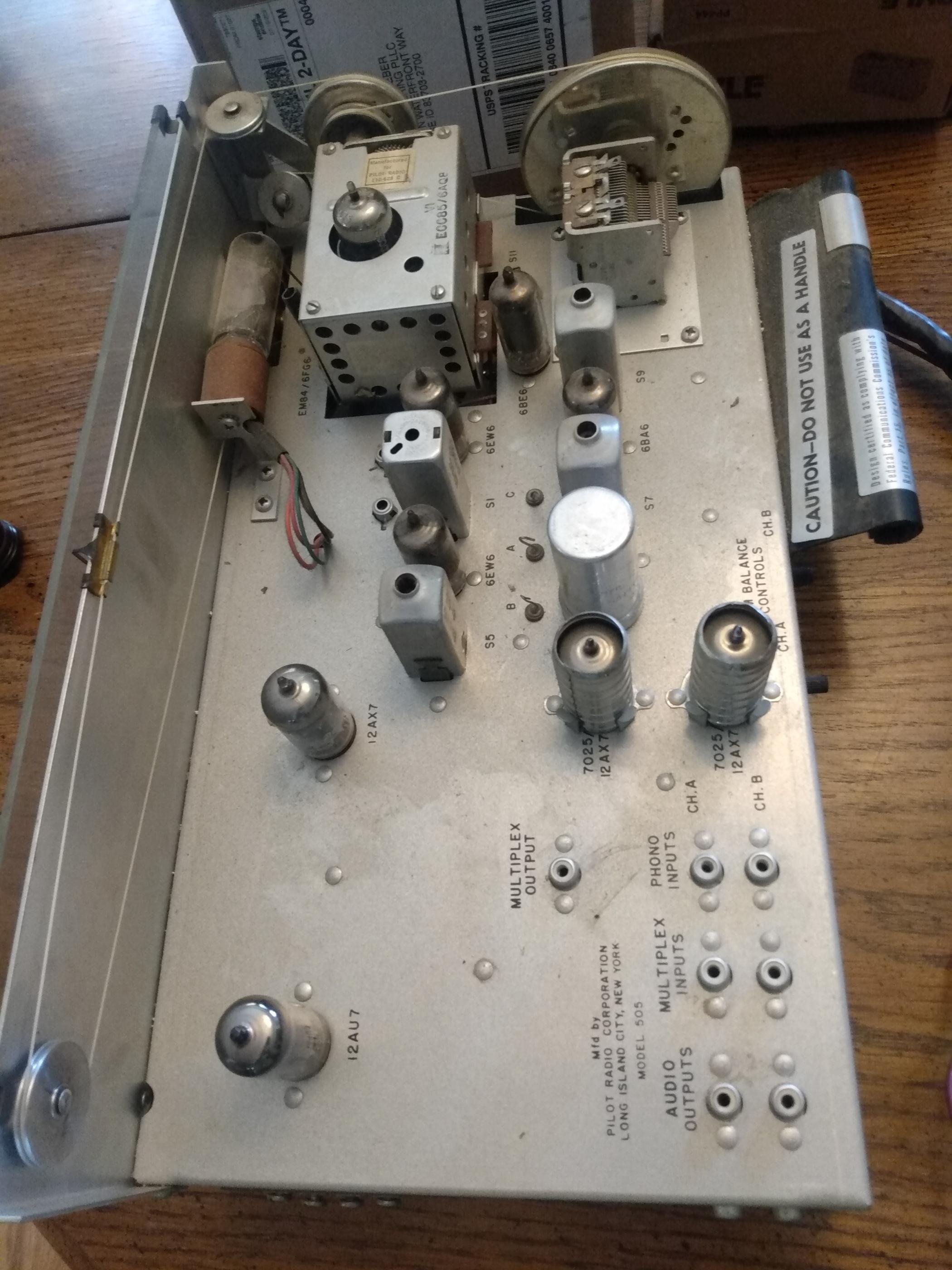

Some years ago I tore apart a couple of console units. One was a Pilot 505. I put new capacitors in the amp and was working on the MPX unit when I got distracted and never got back. I've just ordered JJ tubes for the amp and would like to see if it works.
What can I do for a pre-amp? I'd like to build your kit unit but haven't the time right now. Is there a reasonable priced phono unit I could use just to test this?
What kind of power does it have and what to do for speakers? The original speakers were largish but without heavy magnets and no enclosure so I'm guessing I need easy to drive speakers, correct?

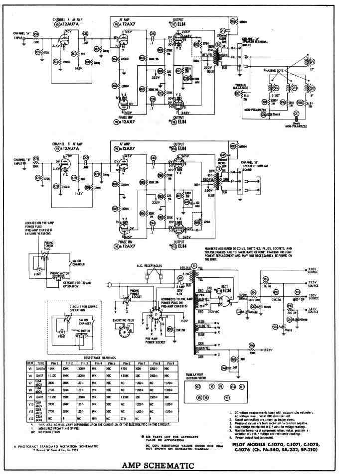

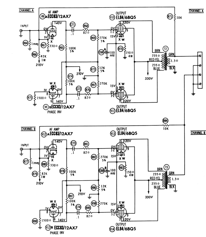

I've snipped out the amplifier portion of the model 500 schematic Tom Bavis was kind enough to post in a parallel thread and I'm uploading the snip here.
This setup doesn't have a 12AU7 section voltage amplifier and might do well driven by a "standard" CDP's 2 VRMS O/P.
There are items of concern.
The 1 MOhm value of R66 and R77 can adversely interact with 12AX7 section Miller capacitance and roll HF info. off. Reduce that value to 100 KOhms.
A 1.3 ohm O/P transformer secondary impedance is, to say the least, suspicious.
In any event, please upload a photo of the chassis actually in your possession.

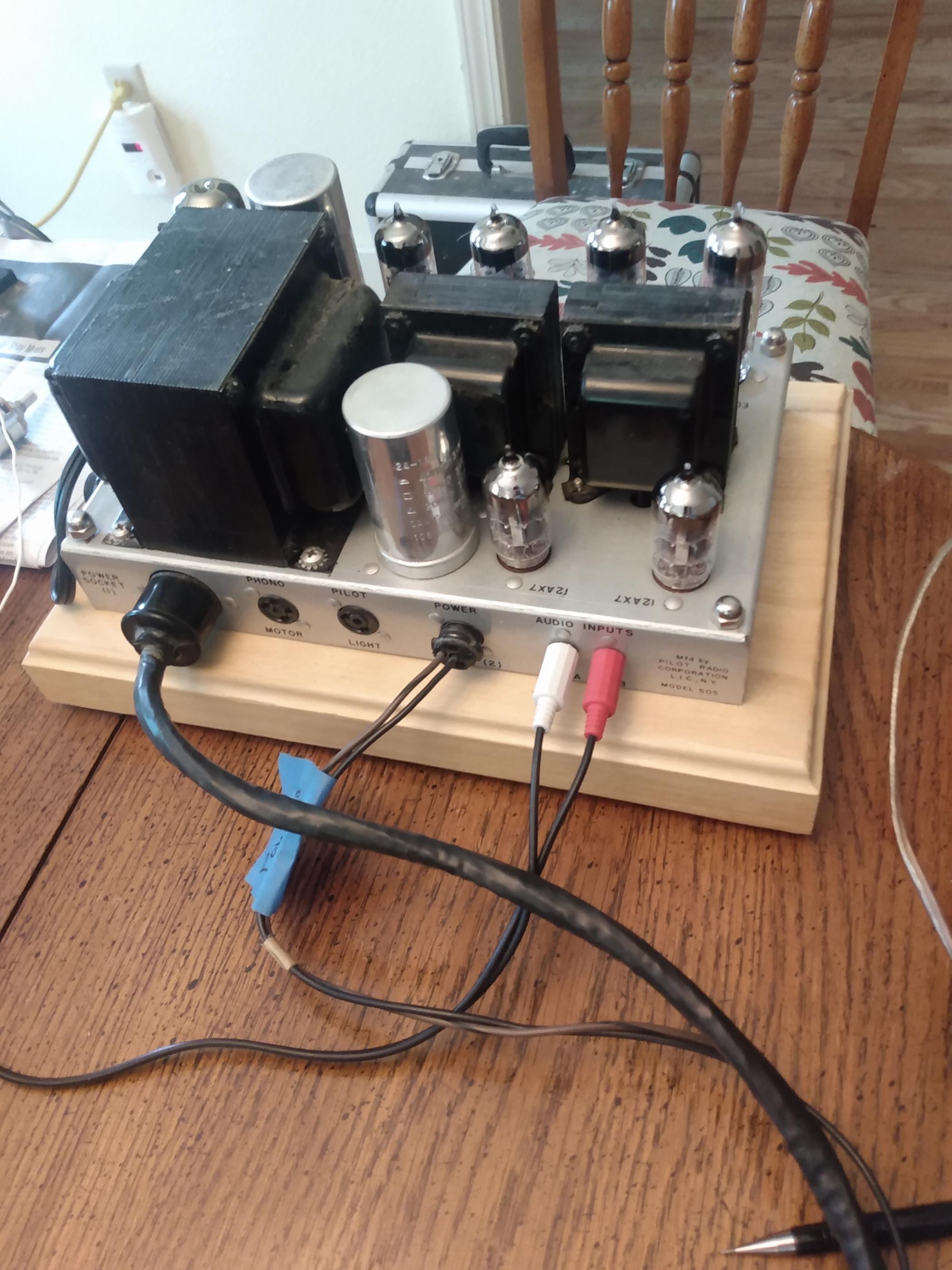

I went with a Pyle phono pre-amp. Consider that the Pilot 505 Amp was recapped by yours truly, somewhat suspect, so I don't want to throw too much money at it until I know it works. I had hooked it up bac when, with the tubes it came with, and the tuner/preamp unit, but the preamp unit had a pretty bad tube so I didn't get much. Put it away and moved 3 times since then.
The volume control worked. I bought the wrong (but very nice) RCA jacks and don't want to use them on this, so some jumpers were involved. Also didn't want to haul the Dual 1019 out to the dining room, so I used the old SL5 TT.
Of course nothing happened when I turned it all on. I'm thinking it needs a signal from the preamp power cord to tell it to turn on. (power to the preamp comes from the amp but the signal to turn on goes from pre to amp?). I dug out the old pre-tuner & plugged in both power socket 1 and power socket 2 cords. Worked, produced stereo with a lot of noise. Volume control all the way down best but still very noisy.
I will try and the documentation I found back then. There must be a way to switch a signal to tell the amp to turn on. Mean time, is the noise my crappy soldering or a bad component?

Clean and re-tension, using a dental pick, all the tube sockets. Anhydrous or even 91% isopropanol is an OK solvent, but DeoxIT is (IMO) better. Scrub the miniature tube socket contacts with a periodontal brush and the Octal socket contacts with a pipe cleaner.
Clean the steel pins of the miniature tubes using a coarse cloth that's been moistened with solvent. A rubber eraser intended for use on ink (contains mild abrasive) can also be of value in cleaning tube pins.
The carbon composition resistors used in "vintage" equipment drift in value and go noisy, with the passage of time. Every last one of those parts has to be checked. Failed carbon comp. resistors should be replaced by modern carbon film parts of equivalent value and wattage rating.
JMO, the tuner preamp is close to being a POS. PM me about salvaging parts from the tuner/preamp carcass. Build a new control center that includes the on/off switch for the amp. IMO, it's unlikely that the umbilical cable can be recycled. Back in the day, 3 wire, safety grounded power cabling was not employed. You will comply with modern safety rules, especially given an exposed metal chassis.
An excellent way to replace crappy OEM RCA females, for comparatively little $, is this. The die cast metal housing ensures strength is maintained, even though sheet metal gets cut.
Pilot seems to have used respectable "iron". Squeeze what you can from the decent vintage magnetics.

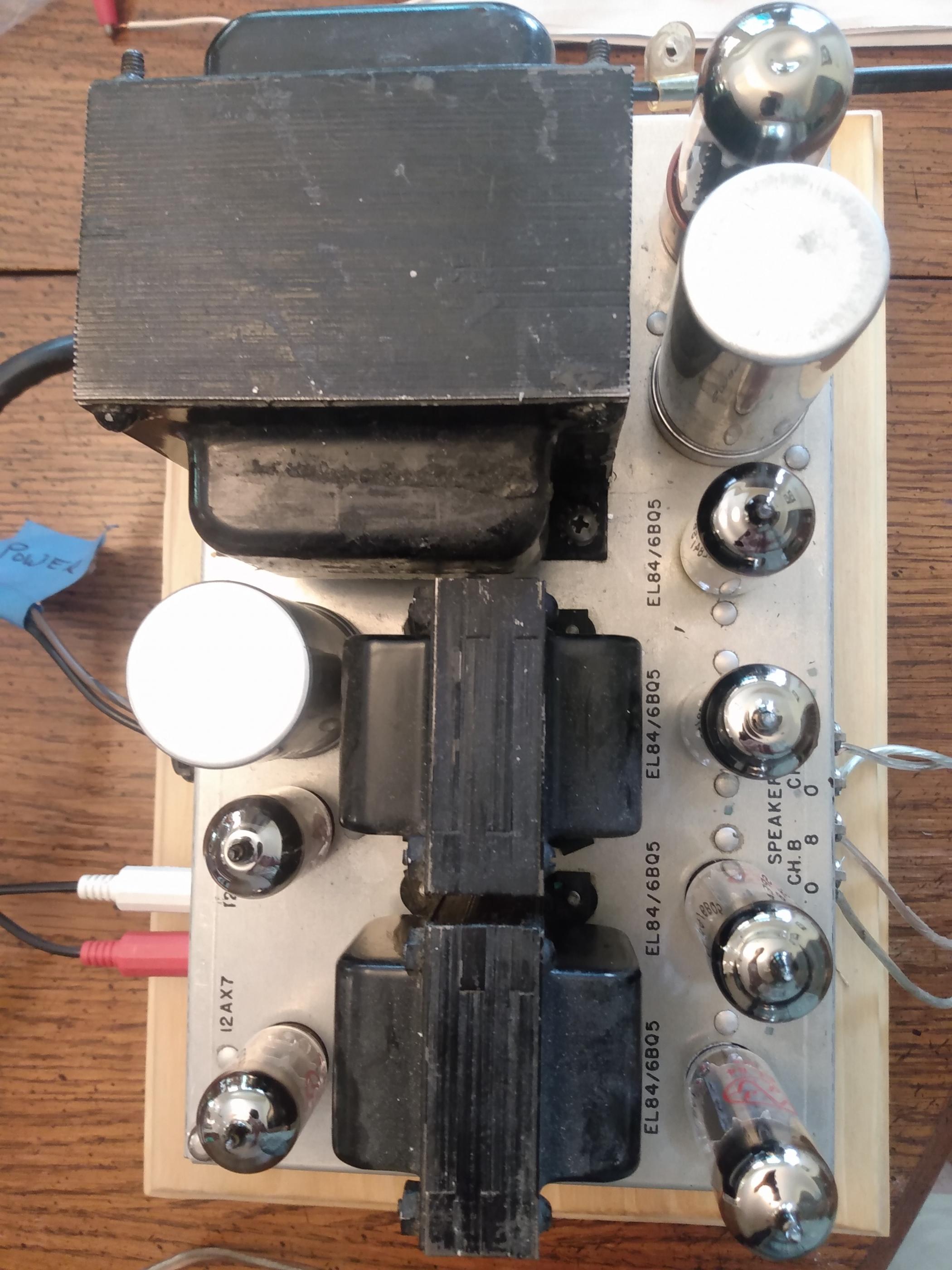

Eli, those are new tubes, I will swab the pins with alcohol and lean the sockets. I put new capacitors in including under the big aluminum ones. It was a lot of soldering, likely beyond my workmanship level. I'm sure I used heat sinks, though. I had the complete info back then, schematics and parts list. I turned it on when I first got it (I know, bad owner) and it sounded pretty good. So I think the problem is my clumsy hacking in recapping it. Still trying to find the repair info I had back then. The amp does not need the smaller 3-pin power plug. Seems to work the same with or without that. A lot more power than I expected.
