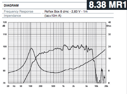

Meanwhile I see that at least Qspeaker says I could do this with the FaitalPro driver. Two 3 x 6 x 14.5cm ports could quite easily be cut into the back of the box, and Solidworks says the box is 14.97L. I really wish I knew what the current speaker is so I could model it, but there is just no info whatsoever on it...
@weltersys thanks for the kind offer, will PM, but I am in the UK so might not be so easy...

You could use REW https://www.roomeqwizard.com/I really wish I knew what the current speaker is so I could model it, but there is just no info whatsoever on it...
to measure it's response.
Honestly, unless you intend to play bass guitar through the little Pignose, I don't think the extended bass response below 100 Hz will make any difference at all....I could do this with the FaitalPro driver...
The lowest fundamental frequency from a guitar in standard tuning is only 82 Hz, and the few spectrograms I've seen show little to no fundamental present; with normal playing technique, most of the energy is in 2nd and 4th harmonics, at roughly 166 and 330 Hz, respectively.
Marshall 4x12 cabs, famous among guitarists for strong bass, actually have a frequency response that falls like a rock below roughly 120 Hz: https://www.aikenamps.com/index.php/frequency-response-of-a-marshall-4x12-cabinet
However, SPL at 150 Hz is some 10 dB higher than it is in the 1 kHz - 2 kHz band; that is why these cabs produce strong-sounding bass! It's about the EQ curve, not deep bass extension.
-Gnobuddy

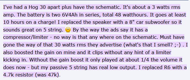

I have recently come to possess a Pignose Hog 30, which I would like to use with my bass ukulele (Self contained electric acoustic u-bass) (yes I know my ubass has it's own built in amp, but I still have the output available and I'm hoping to get even more volume).
So my plan is in fact to play bass through it.
