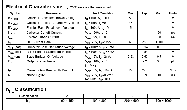

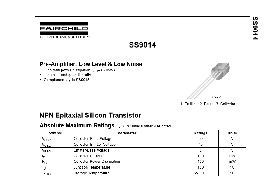

I don't think so 🙂 The photo shows S9014 gain group B for the little 'uns.

If you want you can measure and record the voltages on the transistors with the amp powered up:
Looking at the label side of each transistor starting from left to right.
Copy and paste this with the results.
TIP41
B=
C=
E=
TIP41
B=
C=
E=
9014
E=
B=
C=
9014
E=
B=
C=
