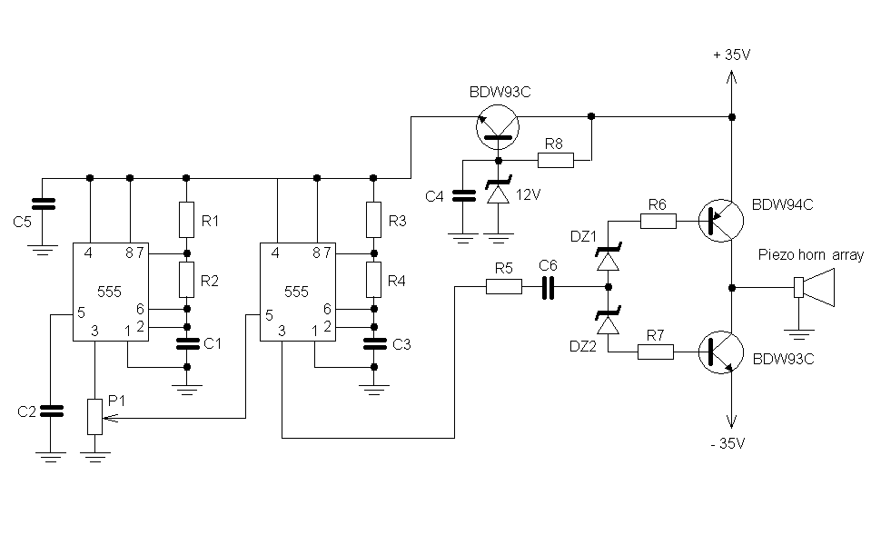

A first schematics ! 😀
(I have this not yet verified)
http://img296.imageshack.us/img296/7270/horndogof0.gif
+/- 35V is enough for piezo horns ?
A great first step, indeed, but I'd need to see component values as well. Unfortunately, I can only copy an existing schematic... Also, is there a way to drive this circuit from a single 24V supply? Thanks - ardo.
