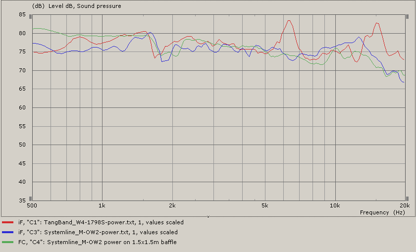

I have BMR drivers. They are very good, well balanced loudspeakers. No complaints. Much better then more expensive Tangbands. For about 10-20$ a true star.
