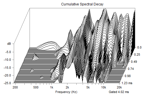

In fact 1mm balsa is not heavier than quality printing paper. Here is the CSD of the 2x0.8mm magnetostat:
http://www.diyaudio.com/forums/showthread.php?s=&threadid=80797&perpage=25&highlight=&pagenumber=3
Behaves very much like a DML in the highs. I didn´t try this concept with cardboard, so i can´t say whether transparency of the balsa is worse here, too.
Aluminium decays much faster. I've tried adding the mass to monomorph brass plate and piezo plate but got contraction result to what I have wrote 🙁
Mass on piezo plate == higher modal density, higher first mode
Mass on brass plate == 6db louder

According to:
There's no difference between a violin and DML panel.
Langhoff, A. (1994). Measurement of acoustic violin spectra and their interpretation using a 3D representation. Acustica, 80, 505-515.
And if the only difference is in decay of fundamental tone and harmonic distortion then DML is well suited for anechoic recordings (even spectacular) of chord instruments worse on brass or human voice. Maybe Balanced Mode Radiator is more universal.
http://www.diyaudio.com/forums/attachment.php?s=&postid=1831258&action=thumb&stamp=1242679394
Maybe new name: Distorted mode loudspeaker🙂
