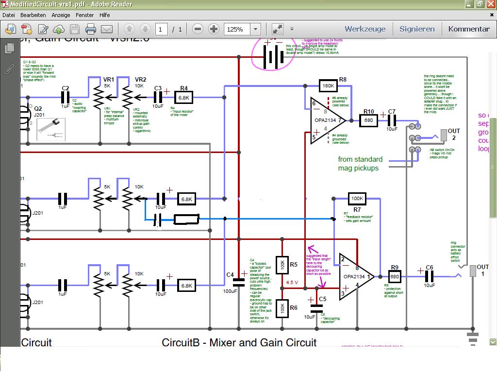

Hello there, in order to increase the "headroom" of the audio circuit, I'm interested in trying a Bipolar Power Supply/Dual Rails.
I've attached a schematic of my circuit with the proposed changes. Could anyone offer any insight into whether I've got this wired correctly or not? Or are there any other considerations when switching from a single to a dual rail system?

I am not not sure exactly what I would propose as an alternative, but I personally am only familiar with the musical instrument jack TRS jack ring terminal being grounded by a TS plug as a power switch technique when it is used with a single battery.
My initial concern is that I see op amp(s) connected to the both voltage polarities regardless of the ground being opened/grounded by the jack as switch technique.
This appears to have 18 V total on the op amps with no ground. So it appears the op amps are sort of floating relative to ground and connecting/disconnecting the ground would/probably create a transient, in addition to the 'power off' function not really being effective.
2nd observation is that I see op amps still biased to 1/2 a single battery voltage. Going to bipolar power with the op amps still biased for single supply would likely put you op amp outputs at some other potential than they were before. Even if it stayed at 4.5V rather than moving to 13.5 or -4.5, it's still counterproductive to seeking more headroom on output swing.
I'm on a phone now & can't see while I type, but I didn't look at the JFET's bias to see if they are affected by the power supply change. I also didn't look for coupling (DC blocking) capacitors on the op amp outputs. That's normally needed with mid-bias single-supply operation of op amps. If the op amp bias DID change to a negative offset by virtue of the single-supply bias technique, electrolytic coupling caps could be unhappily reverse-biased.
As I said, I didn't study it carefully, so it may be that the mid-point bias remains at 4.5 V due to being directly connected to the +9 'bus'.
I think a DPDT switch for both batteries (+) with ground no longer jack-switched and disconnection of the op amp input power bias are things to analyze relevance of in your scenario.

i think you can use two 9V batteries in series (instead of only one)......gives you 18V.
have a look if there are parts running hot.

Oh sorry, I actually didn't mean to try and run this with a battery on switch jack, I just forgot to update the circuit diagram. I've updated it now (see new attachment)
I've circled the areas of concern you brought up multi-volti... do you know, would I change the resister values of R5/R6 to accommodate the dual rail system? Also, not sure about the capacitors C6 and C7, would I just omit them? or change their values?

so there's a possibility that I wouldn't need to change ANY components? (except add the additional 9V battery) In your opinion, would I simply add another 9V battery in series, as opposed to attaching to ground between the two batteries as I've indicated in the diagram?
'2134 op amp has max. power supply of +/- 18 VDC or 36 V total, so two 9V batteries is OK, for 18V total.
Do the JFET's work as drawn? The dual 22M set gate bias, but I see no drain or source resistors...the lower JFET looks like it's set up as a current source, but with the wide variation in JFET parameters, it doesn't look like a predictable biasing method.
I suggest you research 'noiseless biasing' for op amps and JFET boosters. The pair of 22M resistors looks like a recipe for a lot of thermal noise. Noiseless biasing typically does something similar to the op amp voltage divider...a pair of 10k to 100k resistors in series to bias the gate at half the Vdd voltage instead of the 22M resistors, then instead of the 1k feeding the gate, you use the high impedance you want, like 11M.
