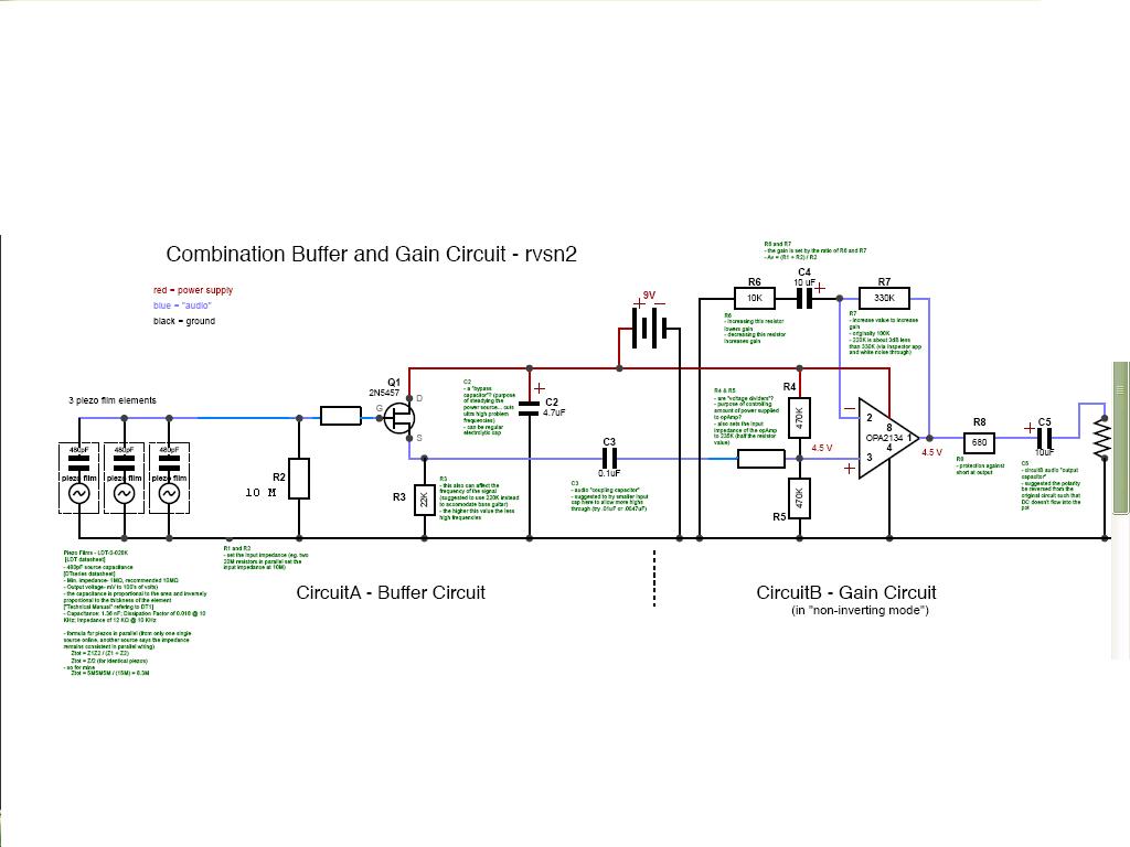

Hello Lid55,
Looking back on your first post I noted you have three piezo films in parallel.
So, just a couple of points which I think need to be addressed.
In parallel the effective source capacitance has tripled (that may be obvious) and that would mean considerably more high end roll-off for a given buffer circuit, compared to a single film. I did not download the data sheet, but you could measure the capacitance for one film? Then look at the buffer input capacitance.
Are you trying to get a blend of different sounds from different points of the guitar?
If so, would it be preferable to pre-buffer each piezo and then mix/balance the elements rather than parallel them all at source?

Hi Lid55,
I am estimating the total effective capacitance would be about that, 1.2nF.
Yes this could diminish high frequencies depending on the buffer's input capacitance, the best test of that is to simply try with just 1 transducer and compare with a given buffer.
Regards
Regards

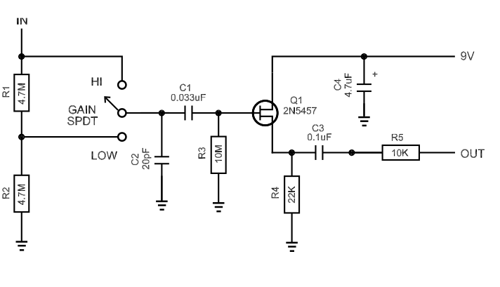

On the point of optimizing the the circuit, is there any reason why I can't use a single 10M resistor in place of the first two 20M resistors in parallel in the buffer circuit? I can post a schematic if what I'm talking about here is unclear.
Post a schematic, but I don't quite see why you would have two 20M anyway?.
Well here is the original buffer circuit... with a gain switch at the beginning. But since I've done away with the gain switch and the 20pF capacitor... I end up with two resistors to ground, one on either side of the input capacitor. Does it matter which side of the capacitor the resistor(s) connect to ground?

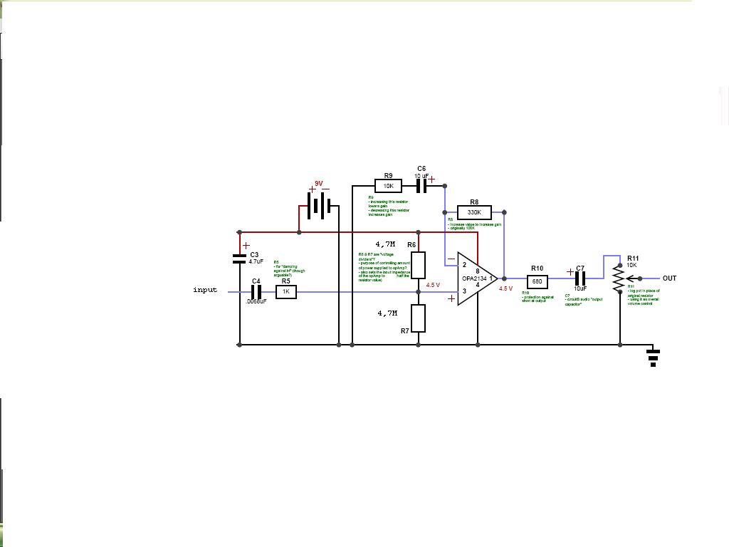

And here's the schematic of my current combo circuit. So in other words, can I combine R1 and R2 to simplify the circuit?
On another note, I AM still wondering about C1 and C3 and C5, the audio coupling capacitors... how these particular values were chosen. I read somewhere in my research (from the BeavisAudio website) that the values of 0.1uF to 1uF is where the full audio frequency range will pass... is this always true... or does it depend on other factors?
R1 and R2 aren't needed, but you MUST have the gate resistor R3 in place.
R1/2 are just there to implement the gain switch (which seemed pretty bizarre in the first place).
Coupling capacitors 'can' be calculated to give the required -3dB point, in conjunction with the load and impedances. But as I've repeatedly said, it's NOT a good idea to try and restrict low frequencies in that way. Generally you would 'calculate' then to give a far lower bass response than you require, or more likely not even 'calculate' them at all - just 'chuck' a suitably large value in there - which is why you see a LOT of 0.1uF's used in high impedance circuits 😀
