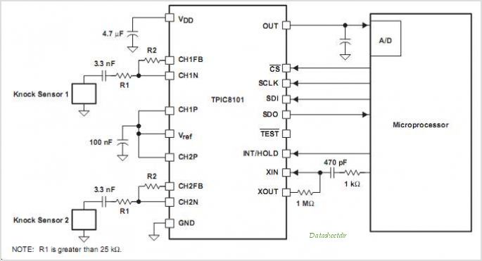

Which IC? Is there any DC-blocking cap or load resistance? Do you have schematic?
We want to be able to Monitor the sesnor signals audibly (headphones) through the sensors as well (they basically act as piezo Mics)
We use a common automotive IC used for engine knock detection called the TPIC8101 (see attached Schematic).
Gain is programmable but we can also adjust via R1/R2.

R1 is the load resistor. The signal can be upto 5V p2p at that point depending on the value of the load resistor - piezo's are current sources so the resistor sets the gain as it converts current to voltage.
What values of R1 and R2 are you using?
It may be that you only need attenuation and current buffering.
For a floating source like a piezo transducer, decent coax is probably as good as anything in this application.
If you are going to include a (FET input) unity gain buffer, I would suggest splitting the signal after that. Knock sensor input impedance at the IC is = R1, i.e. 500k, and as outlined earlier you want something well in the Megohms for best performance.
This whole splitting business could turn out to be fun - good luck avoiding ground loops. Better make a plan of all ground connections involved. Strategically placed ground loop breaking resistors may have to be employed.
