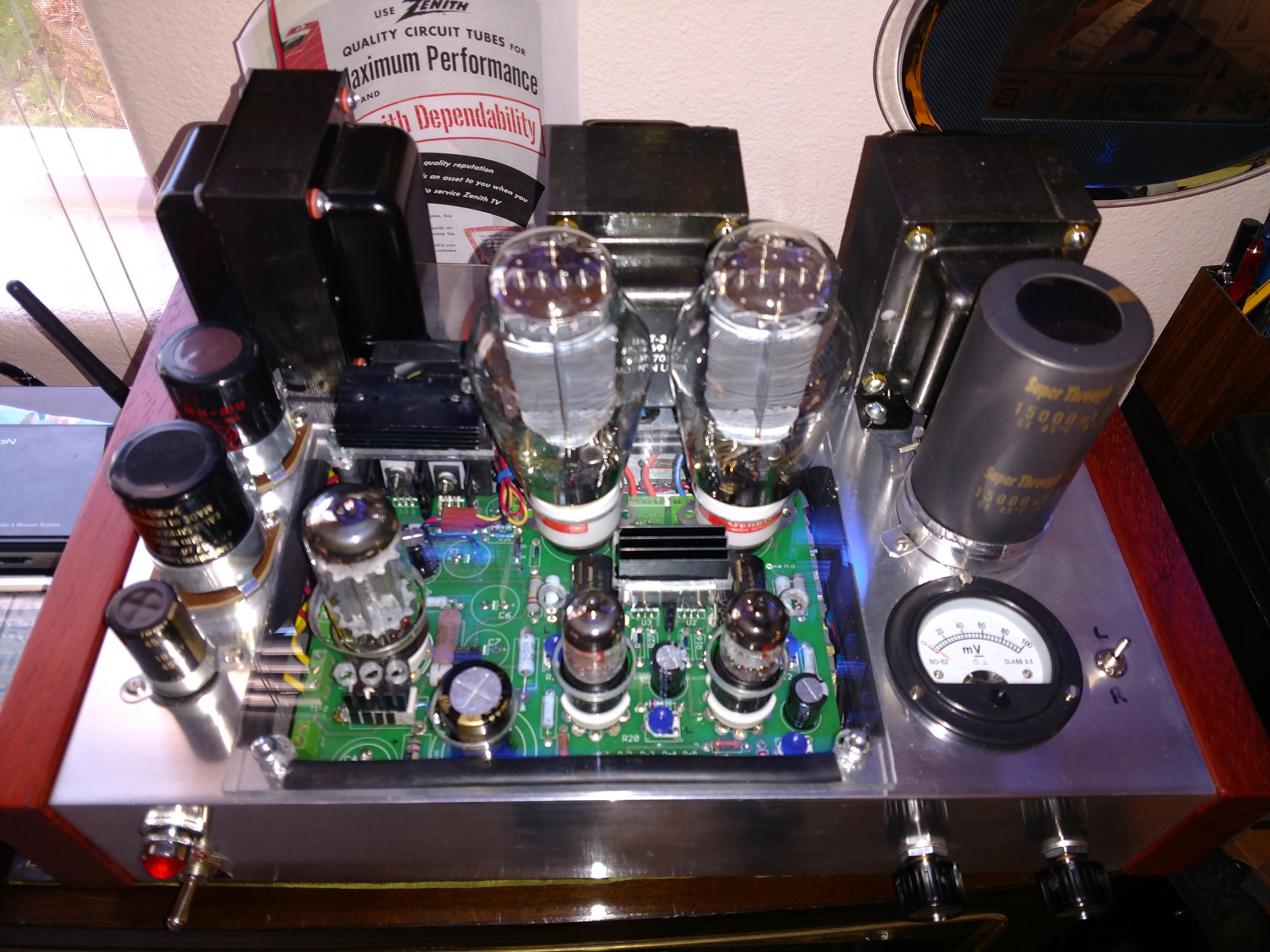

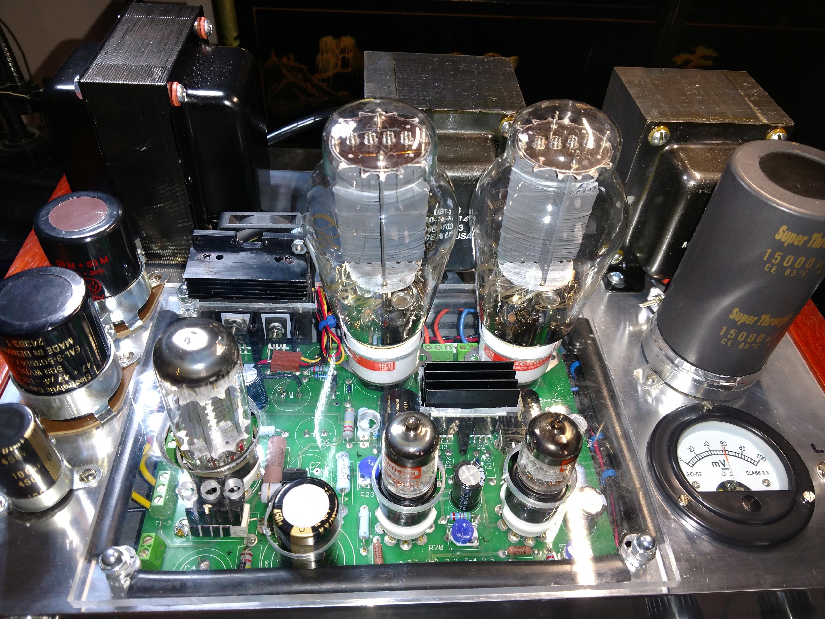

My finished 300B
Well it was bit trying at times but i got my 300B working like I want it. Changed a couple of components around to lower B- from -230 to -154VDC. Added more heat sinking, a small fan for the 5 volt regulator. Small mV gauge to monitor the plates of the output tubes. All in all it was a good experience and the sound as you guys know is quite good. I added attenuators for volume and a output transformer impedance selector. Also added small heat sinks to B+ and B- output resistors.
Hammond 276X
One Electron UBT-3
Nichicon/Jensen and JJ Electrolytic's
Mundorf Couplers
Goldpoint Attenuators
Genelex Lions 300B,
Old School Raytheon Black Plate 5842
New Issue Mullard GZ34
Tell me what you guys think...

Nice build.

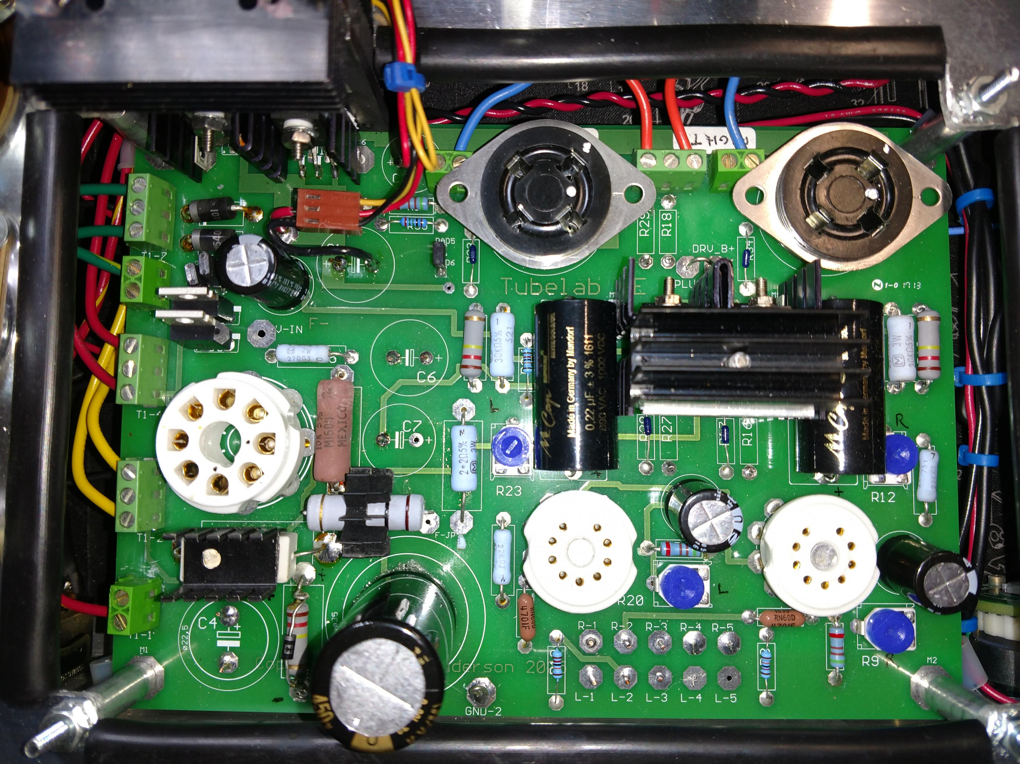

What are the specs or the part numbers for the wire connections to the board? I've never seen that before on a TSE board.
The TSE board was designed before I did the "Simple" boards. It actually was never meant to be a DIY "kit" board.....that just happened. The wire spacing is not consistent, but as you have seen people have a way of making things fit. I did the same thing with Pete Millett's big red board.

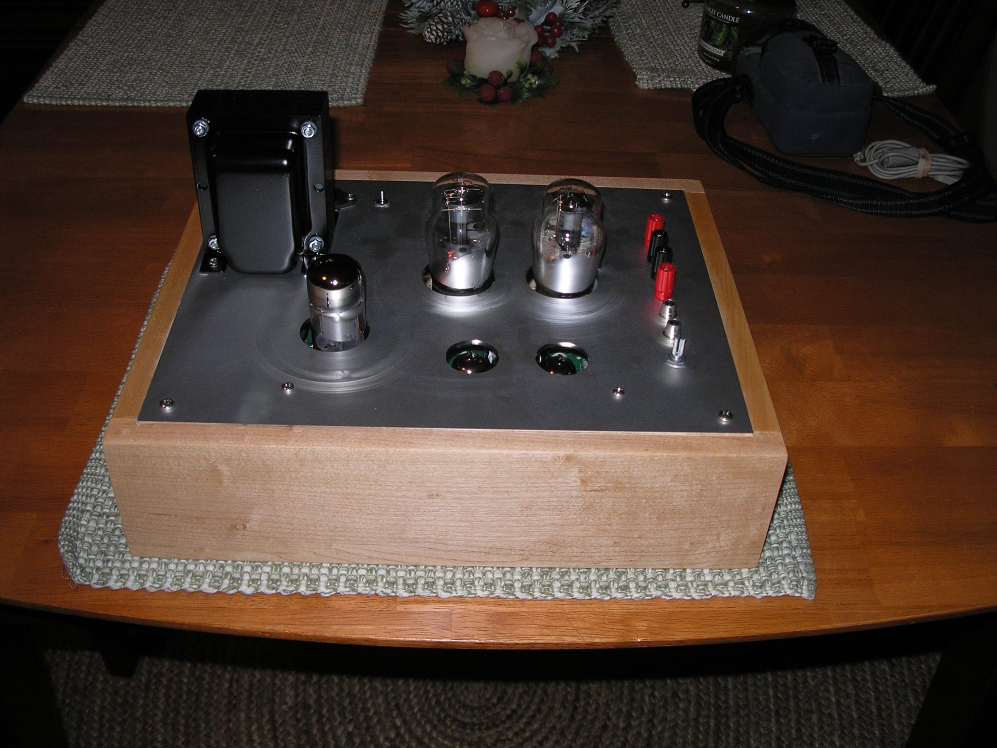

My TSE with 45's. The board was gifted to me by a good friend and fellow forum member wdecho. I made the cabinet with a piece of maple I got at Lowes and the top panel was from front panel express.
Sounds pretty freakin good😀

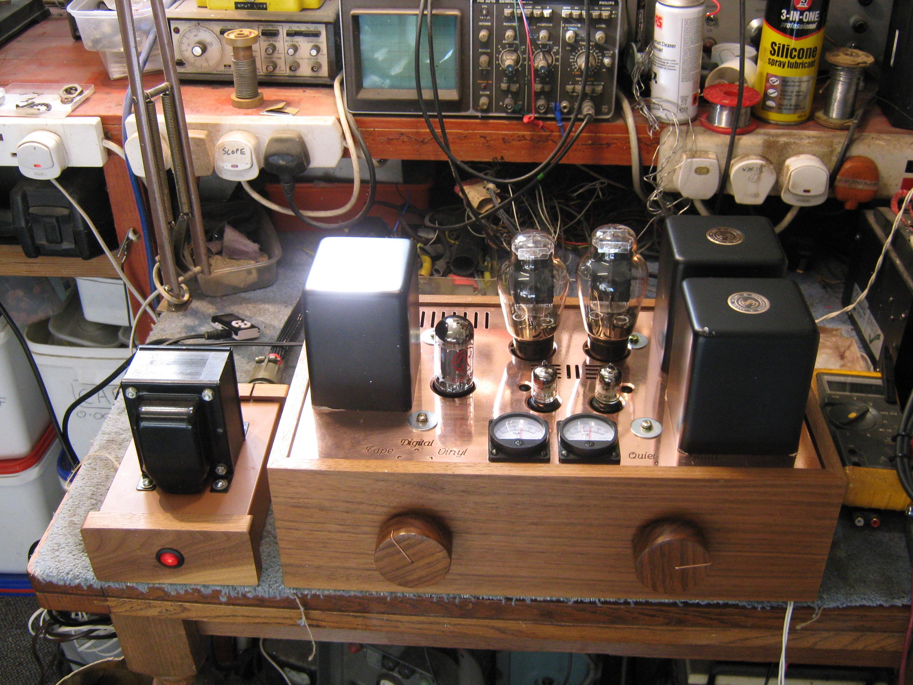

Another SE up and running!
The Tubelab SE by dcmeigs1
Here is the SE (on the right obviously) built out with the $20 Edcore OTs. I'm running 45s now and I've got the Power tubes loaded by the OT iron from an 845 amp. I hear a noticable difference between the two transformer sets, mostly if not completely, in the lower ranges, bass guitar and percussion.
The object is to replace the 845 front end (which sounds abhorent and looks even worse on a scope) with the TubleLab SE. The next step is to load the 45s with a constant current source and run the 45 plate signal to the 845 grid. The final step is to apply the Power Drive mosfet circuit to that signal as described in George's writing on the subject.
That 845 is a "Mr. Liang Audio" Chinese product. If you can find one at a salvage price, it has decent iron.
The TubeLab SE really sounds good at this stage. Probably the best sounding amp in the herd. It's suprising what a few watts can do. One could be forgiven for declaring victory now.
