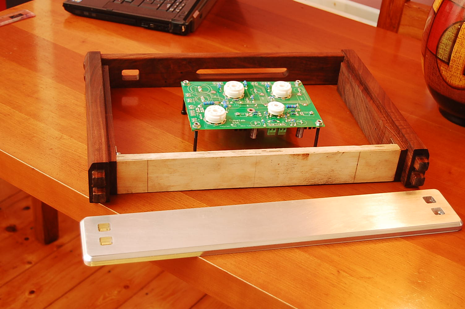

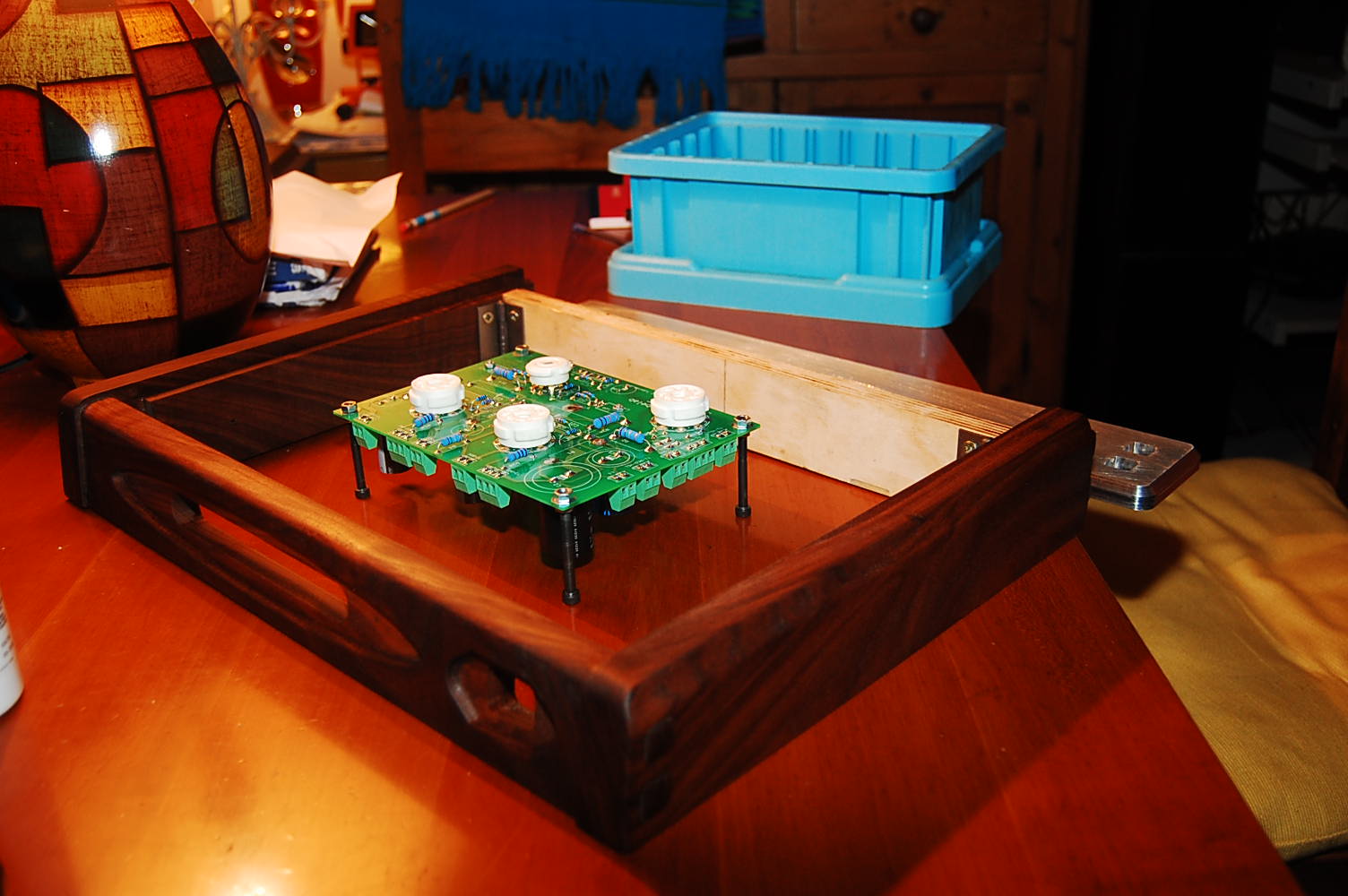

Thanks Michael. There is wood and supports under the transformers. The area around the tubes has a Lexan cover. Lexan is a type of plastic. I purchased clear and then spray painted the underside black. The top provides the clear glossy finish look.
I was worried about the heat at the base of the tubes, but so far so good. Lexan was not my first choice, I actually like other types of acrylic plastics. However, the Lexan was available.

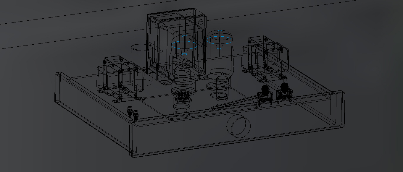

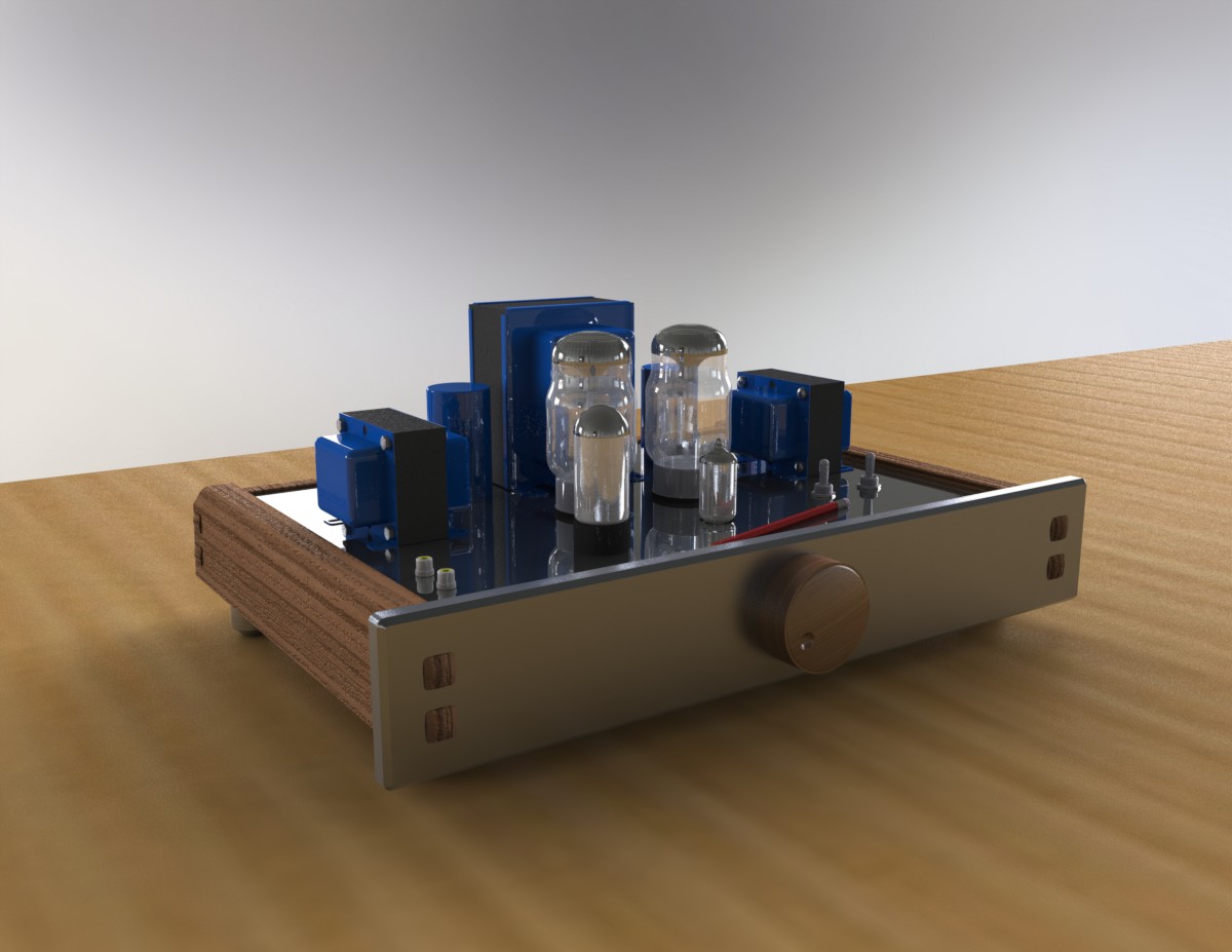

Well here are the layout drawings of my SSE so far, I've plenty of time to play around with the chassis layout because I won't have money for the transformers or tubes for a few months yet.
I've drawn it with the Edcor XPWR059, GSXE Edcors and GL KT88's and
2 auxiliary capacitors (I presume I just wire them in parallel?)
Walnut back and sides and 1/2" aluminium plate front panel.
I have a Blue Velvet 50K pot for the front.
I will probably cut a few Lexan top plates first to check fit before I cut the top Alu plate.
I cut the 1/2 front panel today with my router and it did not like it much!
I think I may have the interconnects on the wrong side?
Any comments or corrections appreciated as I haven't really got my head around the wiring part of it yet.:confused:

I don't see any layout drawings. All I see are a 3D wireframe model and photorealistic renderings of that 3D wireframe model. A layout drawing by definition consists of top front and side views and perhaps dimensions of the layout.

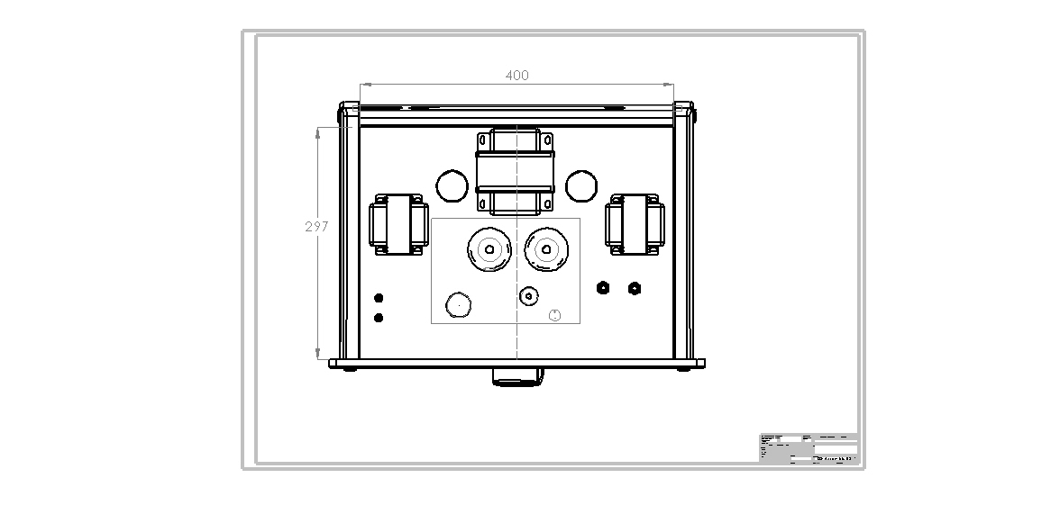

Here's a top view, I don't think a front and side will add much.
The 2 switches on the right are the power and tube rectifier.
The interconnects are on the left I think I need to switch them.
If I place the aux caps like that will I have a lot of wires crossing under the board causing hum problems?
Back in the 70's while attending college I started out working as a Design Draftsman on a drafting board. Since then I've gone on to work as a Senior Aerospace Engineer using CADCAM software as a tool for performing my tasks. I consider myself to be a Master Draftsman due to my extensive experience. Sorry for pointing out the technicality.
By the way ...your design is very nice. It's giving me a few ideas.

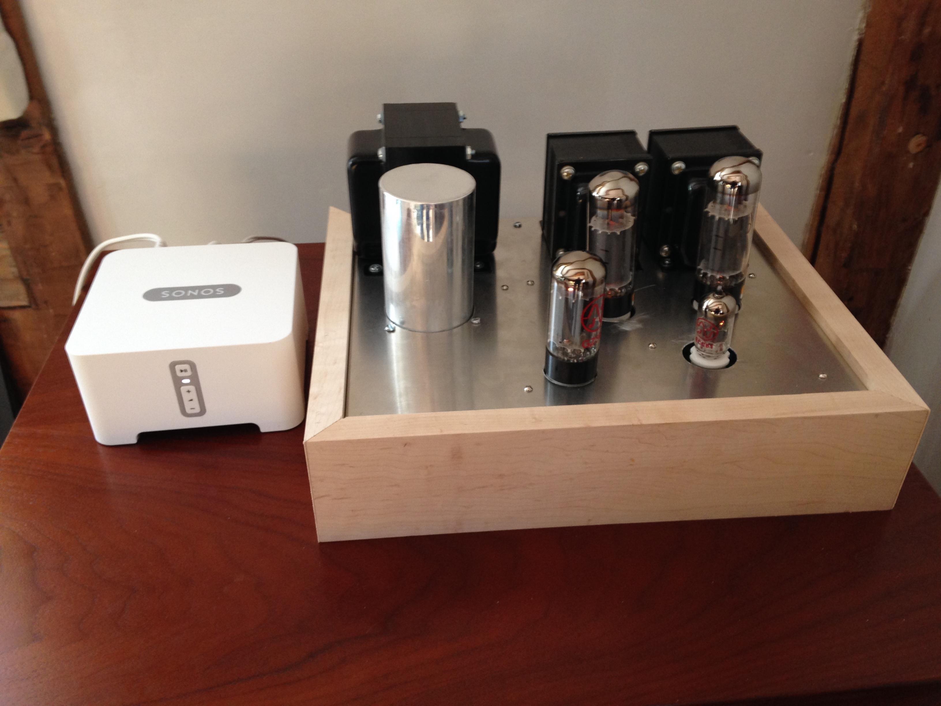

Here's what I call my SSSE (Super Simple Single Ended). It only has an on-off switch which is part of the fused power socket. It is being driven by a Sonos which controls the volume. It sounds great. I need to finish the woodwork and I think I will add a volume control so I can use my cd player, but then I think I'm done.
It has:
an Allied power transformer
Transcendar 10 watt output transformers
JJ 34L tubes
I have a question. I believe the set up I'm using is UL with CFB. As I said it sounds great. How would the amp sound different in triode mode,with or without CFB, etc? Any reason to mess with success?
This was my first build since a I built a Heathkit radio back in high school. I was amazed (and my wife very impressed) when I plugged it in, turned it on and it produced wonderful music.

Jacques, I have 91 db JM Lab speakers, 2-way MTMs, that are fine with a ~7 watt per channel Tubelab SE 300b. It will depend on how easy to drive your speakers are, but with 5 or 6 watts of a triode wired EL34, I think you'd be fine. It might not be as loud, but the tone and detail might be different.
