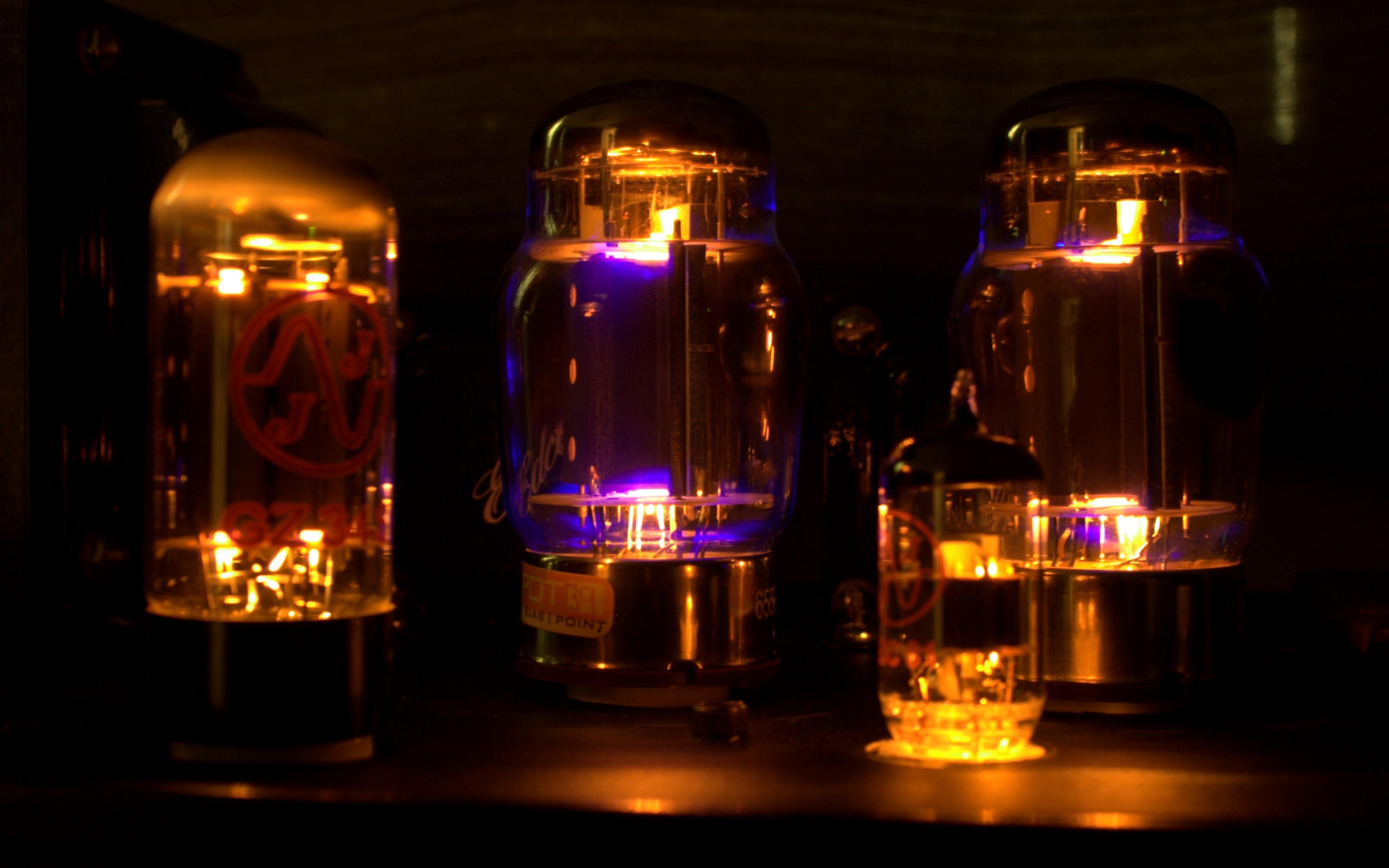

Here are some photos of my Tubelab SSE. The chasis was a Kenwood tuner and it's struggling to support the weight of the transformers. My first experience with a tube amp. It has been fun to build, and sounds pretty good too. I'm looking to add a motor run cap and will probably upgrade the coupling caps too. I also want to change the cathode resistor to better match the 6550s. I think I prefer them to the EL34.
B+ 453
Cathode Resistor - 560 ohm
JJ El34
Pin 8 Bias - 30.5
Pin 3 Plate - 431
Tug Sol 6550
Pin 8 Bias - 40
Pin 3 Plate - 421

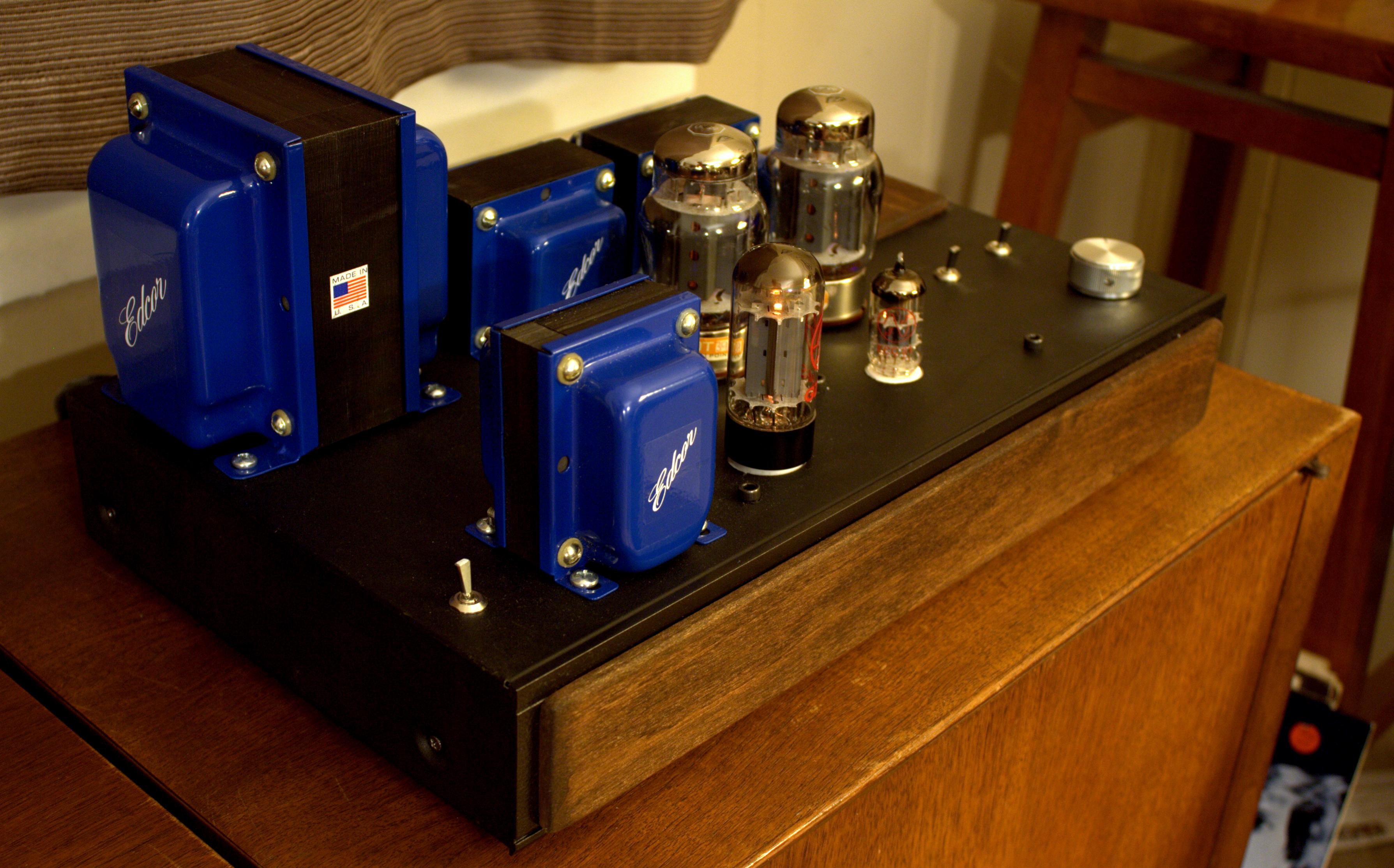

This is my sse. I started with 20 watt transcendar opts. I like them because they have all the features like 4,8,16 ohm and ul tap. They also sound very good. I have switched to the big edcors for the bass performance. They also sound good, but the jury is still out. I don't think they are quite as refined sounding as the transcendars, but I'm not sure yet. I will be sticking with the edcors however because I need the extra thump. The transcendars can be used in another project or might be for sale and they are like new.
Under the hood of the hammond box is a triad choke, and Russian pio caps. Also an 100uf hvac auxiliary cap. I have another hammond choke withless henries and resistance that I tried. I can't hear a difference. I have tried audiocap thetas as the couplers and they sound fantastic in this amp. I'll be experimenting with others. Best sounding resistors so far are the carbon comps. Little demons from digikey. Ul triode switch is in the back. Power comes from the allied transformer. I did bypass all electrolytics with .1 uF pios. Not sure if it helped the sound at all, but it is my habit to do so.
I love this amp.

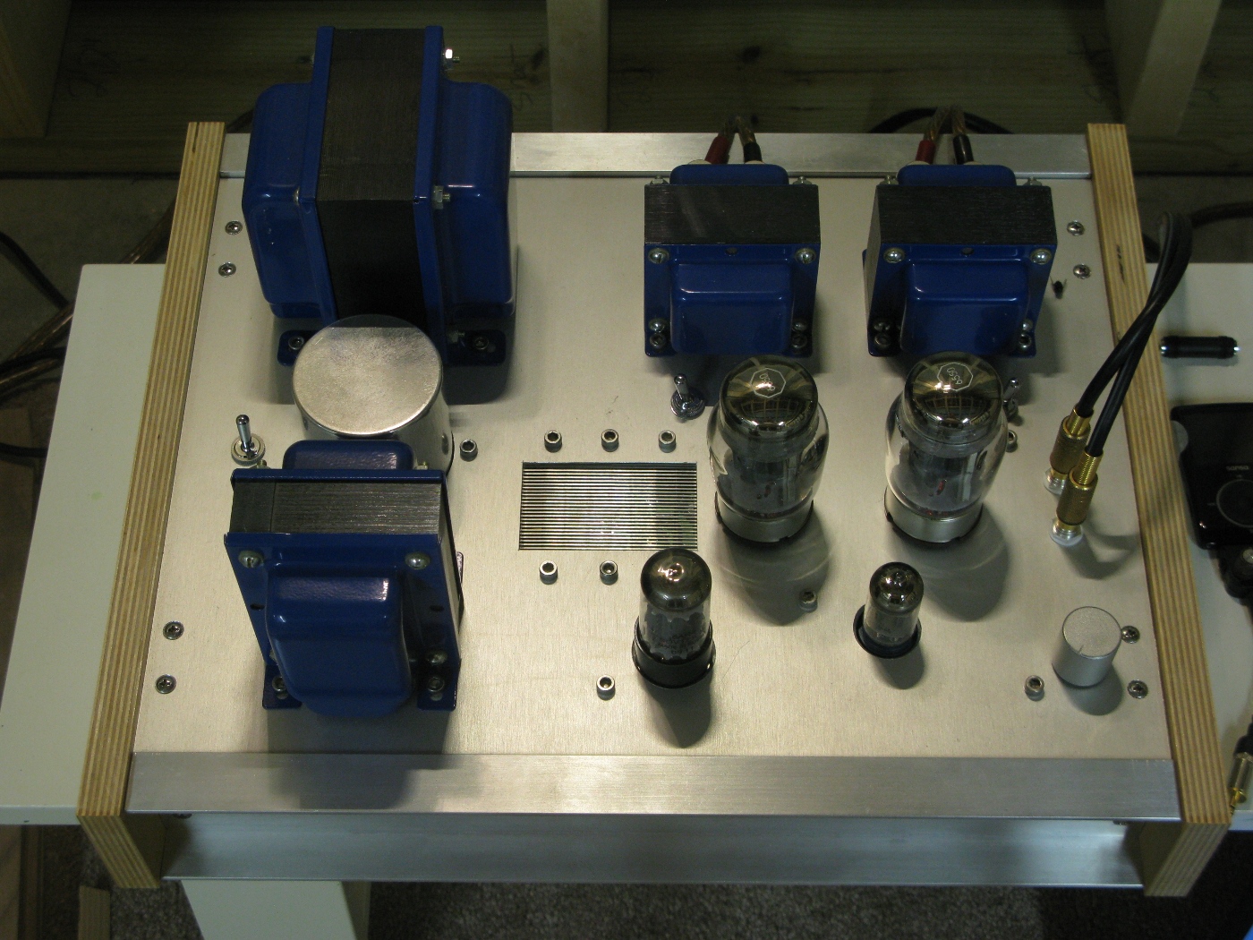

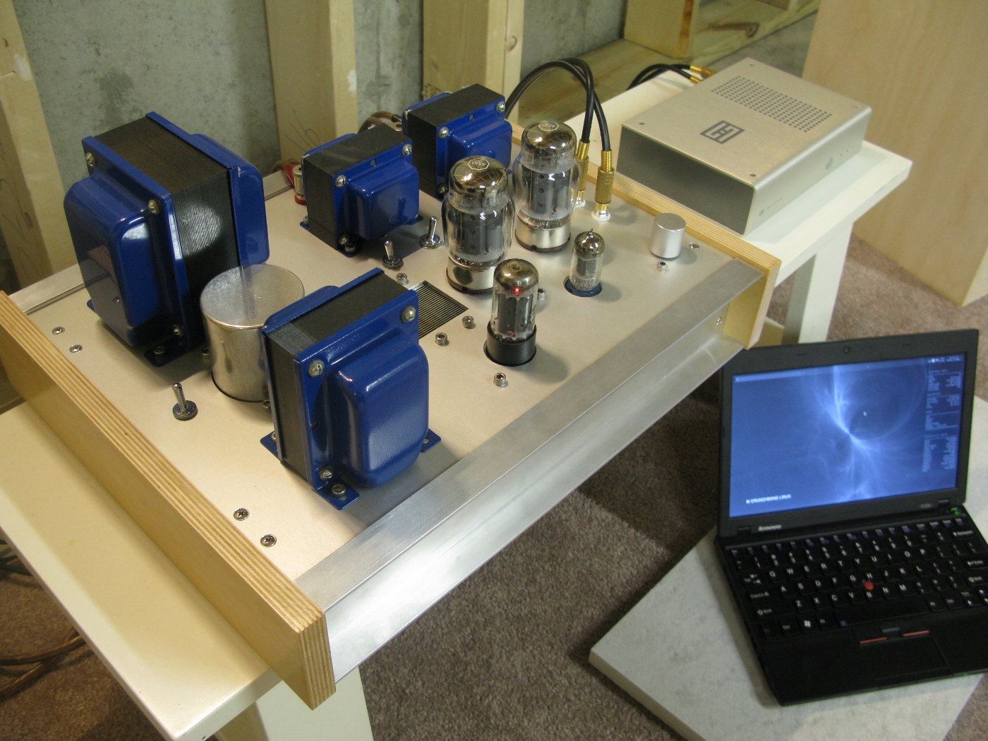

This SSE is my first DIY project. I built it to hear for myself what all the fuss over class A single ended amps and their corresponding back-loaded horns is about. I am pretty well sold. The amp has zero noise and other than fairly weak bass and a little congestion in more complex pieces (I am a headphone guy so take this with a grain of salt - I am used to high degree of clarity), this amp sounds amazing... almost headphone like in its linear presentation, stable imaging and rich soundstage.
My only regret is not holding out for the larger output transformers, George is correct: don't skimp here it is the most difficult thing to upgrade. A bit more bass extension woud be nice but for most music I can live with what the amp offers.
A few vital stats:
Room : About 16' x 19' with ceiling varying from 8' to 9'
Source : #! Linux running MPD > Schiit Bifrost DAC > Tubelab SSE > Madisound BK-16 (back-loaded folded horns) with Fostex FE166En drivers
SSE Amp :
Power Supply : Sovtek 5AR4 Tube Rectifier with 10H-200mA Choke and a giant filter capacitor
Coupling caps : Robert Hovland Super Caps 0.22uF / 600V Film & Foil Poly
Volume Pot : Alps Blue Velvet
Driver Tube : Mullard 12AX7/ECC83 reissue
Power Tubes : Tung-Sol 6550 reissue
OPT's : Edcore GXSE15-8-8K (really should have pinched for the bigger OPT's)
Takman metal film resistors in the signal path
I powered up using some old bookshelf speakers, the results were not music, I didn't expect much but I was honestly a little surprised and worried at just how poor it sounded. The good news was it worked right away, the voltages all checked out and it didn't explode.
Next I hooked up the Fostex drivers to break both amp and drivers in while I built the horn cabinets. This was much more promising, even without drivers I was getting very clear, balanced but weak sound. But wait, where is the noise? This is a tube amp right? Shouldn't there be some noise? Nope, just a faint nothing at full volume with my head right at the driver.
Once I got everything put together (it took a while to get the BK-16's stuffed properly and correctly located in the room) and settled it really plays nice and fills the room quite well. I listen to it critically at nearly full volume, but that is too loud for conversation.
CFB helps anything but very simply instrumented acoustic pieces; the clarity with or without CFB is really astounding on folk, (some types of) jazz, chamber, african, whatever. Most of the time I leave CFB switched on, there is just a bit too much harmonic distortion for me otherwise, too much of that second-order goodness is still, well... too much. I also wired switches for the ultralinear tap, it is a little rough sounding - a lot more volume of course but not something I will use; my curiosity is satisfied though.
The only shortcomings are the bass (bigger OPT's would have been wise, but add considerably to the cost of the build) and a little difficulty resolving very complex music. It does get a little winded on very challenging dynamic pieces, a friend uses a tough piece of vocal jazz as his litmus to test the limitations of audio gear... it really did tax the amp; the imaging and sound stage were spot on but the amp didn't quite have enough speed to keep up with the big (and I do mean BIG) dynamic swings. The music was completely enjoyable but it did show pretty clearly this is not a cost-is-no-object system.
I've been running the system for about 8 months now and I have gotten nothing but surprise and very positive comments on the clarity of this setup from totally HiFi illiterate to very experienced ears. It was a lot of fun to build (thanks for the great design and PCB George) and even more fun to use. For what I have into the amp and speakers it really should not sound as good as it does. For that I consider it a rewarding and resounding success for a first time DIY project.
