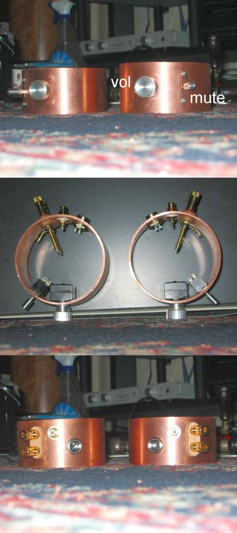

it's not a basic mute on the 7294, you have 2 pins, one for mute and onr for standby, that you can wire together
this places the amp in a doze mode, since the stdby pin can shut the power stage down (a mute only disconnects internally +in and -in)

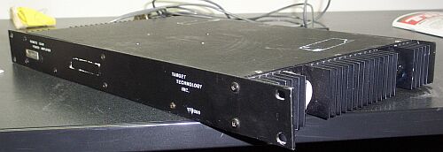

This case became home to 4 new LM12 gainclones. Although its not much of a clone if it uses a different chip I guess. Anyway, the power op amps were already mounted and everything. I kept the power supply and the op amps. I used point to point wiring. I also added active crossovers for the bi-amping.

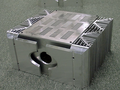

This picture might inspire you to do a good job!
its been a year and a half in the making, and most of that is sourcing. we found people that were willing to help out or get us stuff for cheap. the metal was (gasp) free, and the metal working was pretty cheap (considering its perfect). the milling of the metal was like ~$100 per face plate. the cuts in the back and the vents on top were done free too. so far i have (in my two monoblocks) around $400 into the project. not too bad. i have transformers, connectors left to buy. i initially budgeted $1K for the entire project and its looking like ill be within budget by a $50 or so.
leo said:
Very impressive:eek: how much are we talking to make something like this
