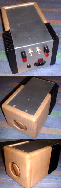

Mmmm. Don't have a digital camera so a CAD drawing will have to do.
<center>
<img src="http://www.q-audio.com/images/littlechassis.jpg">
</center>
Click here for a <a href="http://www.q-audio.com/images/bigchassis.jpg">larger view</a>
It's designed around the <a href="http://www.accelindustrial.com/model79.gif">Model 79</a> extrusion from <a href="http://www.accelindustrial.com/">Accel Thermal.</a>
Except for the heatsink and screws, the chassis is all wood.
The fins are facing outward from the front and the heatsink is gold plated (purely for aesthetics, and the reduced heat capacity isn't a problem for this little 6 watt amp).
The outside open-ended box is made of 3/8" cherry with a 1/16" chamfer around the front and rear outside edges. The four inside surfaces are covered with 1/16" natural cork.
The strip down the middle between the groups of fins is 1/4" birdseye maple with a 1/8" chamfer around all four edges. The hole near the bottom is a power indicator LED.
The strip mounts to the heatsink using four 7/8" brass standoffs and 4-40 thread brass machine screws (yes, you can use machine threads in certain hardwoods like hard maple).
The rear panel is 1/4" birdseye maple with a 1/8" chamfer around the outside edge. The screws are all 4-40 thread brass fillister head machine screws in 1/4" diameter by 1/8" deep counterbores (the counterbores on the outside edges were done on a router table using a simple jig so that the piece could be slid square on into a 1/4" straight cutting bit).
The groups of 1/8" holes at the top and bottom of the rear panel are ventilation holes.
The rear panel is attached to the heatsink via the four inner screws and 3/4" standoffs. The rear panel/heatsink assembly act as one unit and are slid in trough the back of the open-ended box and the rear panel seats into a 1/4" wide by 1/8" deep rabbet in the open-ended box.
The heatsink fins and center strip stand 1/8" pround of the front edge of the open-ended box.
The spacer block is hard maple and the base is a solid block of big leaf maple burl.
Countersunk inside the bottom side of the open-ended box are two 6-32 stainless steel T-nuts to receive the mounting screws which run up through the bottom of the base.
The feet are made of 3/8" natural cork.
The chassis isn't limited to a vertical configuration. I just preferred it and I liked the smaller footprint. You could just as well route your connectors through one of the sides of the open-ended box, dispense with the base and lay it on its back.
Feel free to use any or all of these ideas.
