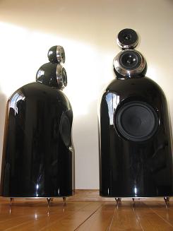

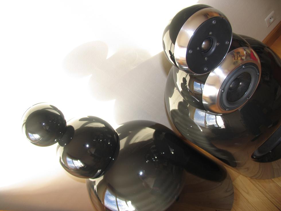

pictures of my last project
2 years of hard work for this one and only carbon enclosure :bigeyes:
TMW scanspeak revelator serie
more information on my web site : http://users.skynet.be/fa616506/
marvelous sound. No speaker on the market under +/- 15000€ can keep the comparison.

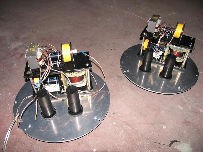

to have a repair for the picture below of the very big crossovoer the aluminium plat are 48cms of diameter ???:smash:
ADYN CAP plus +/-2%, resistance +/- 2% trafokern r=0.08ohm

Yes it's my last project (study of form, capacity, speaker,crossover...) but its not my last realisation. I have paint this one because I was not satisfy with the external aspect, but because there is always a but ............ now I have find THE trick to do a perfect sphere in carbon😱 I can let the carbon without paint with perfect finition (For a sphere Nobody do that before I think). Wait and you will see
For the materiel I start to compare a lot of components (speaker, condo, Resist...) and my opinion it's the following :
No speaker in a sphere are not more natural that a Scanspeak Revelator. I have listen BW serie 800 and I'm just impress with the control of the low bass but don't worry my Scanspeak 25w8565-01 charged in 130 L vented box go down, only -2.5db at 25hz and -7 at 20hz
:smash:
Like I said for midrange the 15w8530 in close box is so natural.
For tweeter I use D2905/99000 with voice of girl like Lisa Ekdahl you can touch her.
The XO is 2order for the three.
Now I go sleep but I will be back Tomorrow with mesure with Cliowin :bawling:
Madmike2Are those transformers in the picture Can you please explain what they do ? I have only seen them used for ribbons and electrostats.
I used Trafokern like a self when I have self in the Signal. The advantage of the Trafokern is the Low resistance. For example a lot of peaple use self from Tritec, but with the same inductance the resistance is +/- 75% less with the trafo:dead:
The resistance is more or less nul. Like that you don't change the impedance value of your XO. Tomorrow I will publish on my web site some mesure that I have made with CLioWin for Phase, impedance, response, and you will see the coherence of the unity (speaker/XO). A other think about the chosse of trafokern is the sound. I do comparaison with some other (Tritec, CFI, Corobar, ...) but none sound like trafo. One thing more the self will be never saturated. :angel:
