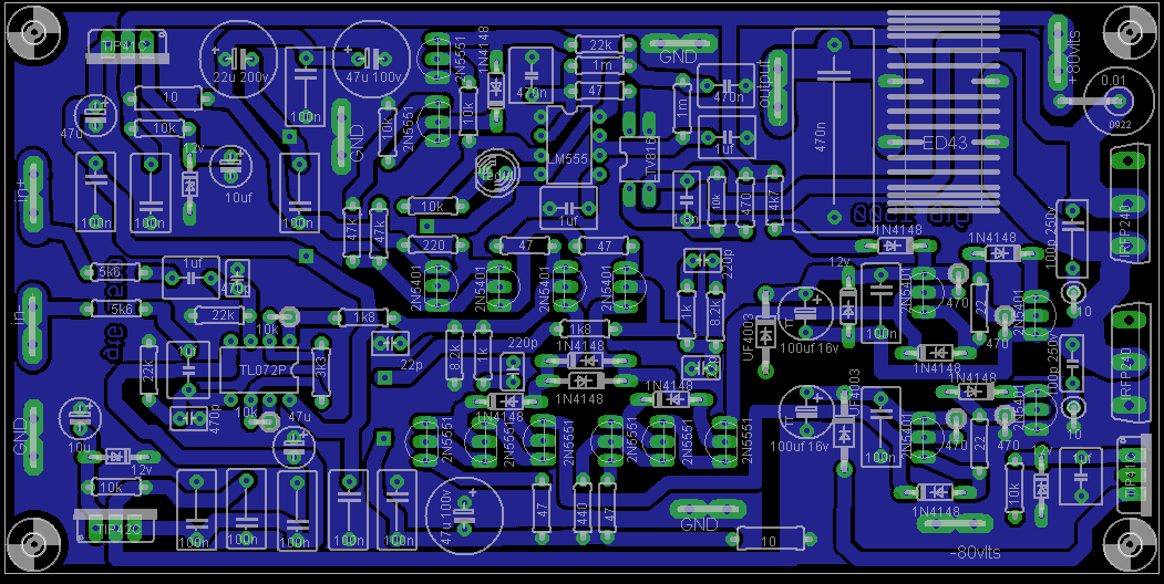

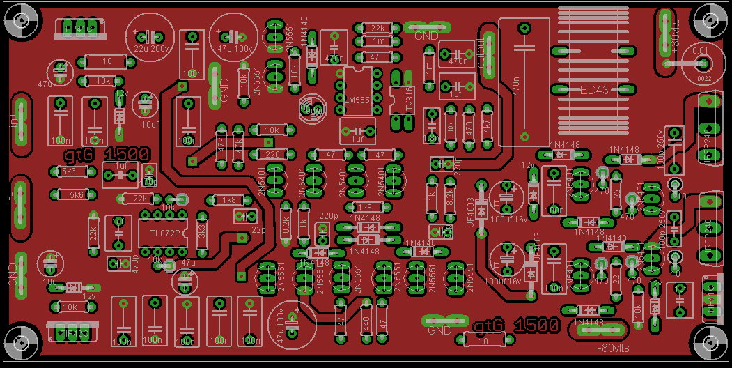

hi class d from ru . wow i can,t believe i found this forum. i have made this amp using irf540n .at first it used to heat like crazy but i found the solution by changing resistor from 220r to 440r . your amp is powerful will post you pictures of my trials . i never got smd components and irfb fet because of my location will post pictures
hi class d from ru i will upload pictures of my projects once i get hold of a camera thanks

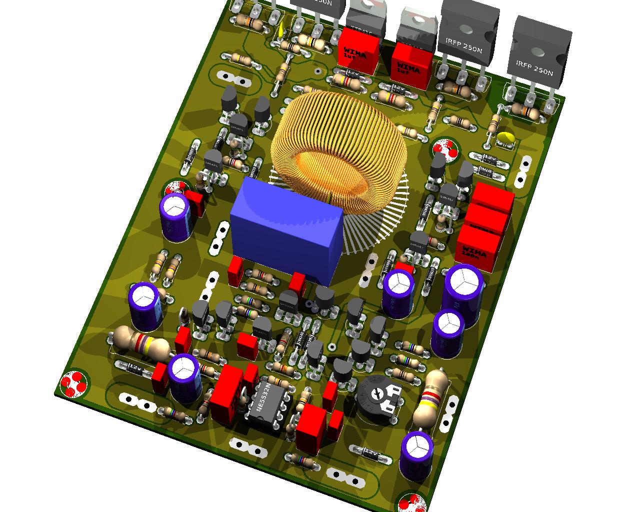

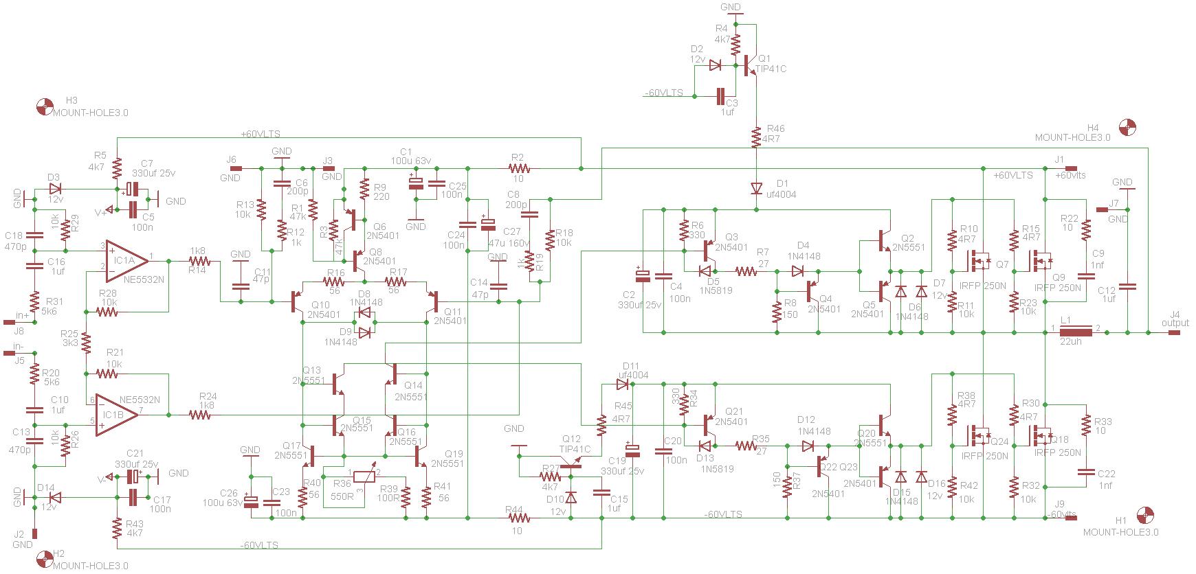

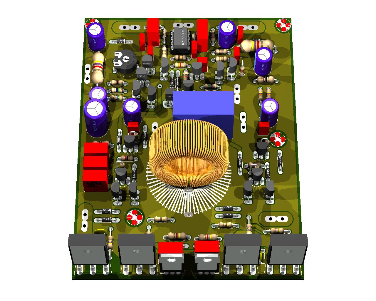

hi luka it works fine,silent and very powerful .but i haven,t reached to over +/- 54vlts because of outputfets (i didnt find any bat or 1n58xx diodes so i just used the in4148) the best i can get was irf540n and irf640 they. used to heat insanely at first but when i changed resistor from to 220R to 440R all was fine
i don't have a scope to verify it but it works fine . the fets warm when operating at high volume levels . recently i found these fets irfb23n20 i will try them with +/- 90vlts hope i am in the right track.
those resistors are 10x too big... you shouldn't ever need to go above 100R
i'm using eagle 5.1 , also i'm stuck to irfp250n because of availability issues thats the best avail high powerfet for class d here . but i am a bit lucky there is a seller who has added irfb4229 to his stock.i'm planning to use them single +/-75vlts and will parallel 3 pairs for sub channel like +/-90vlts.
