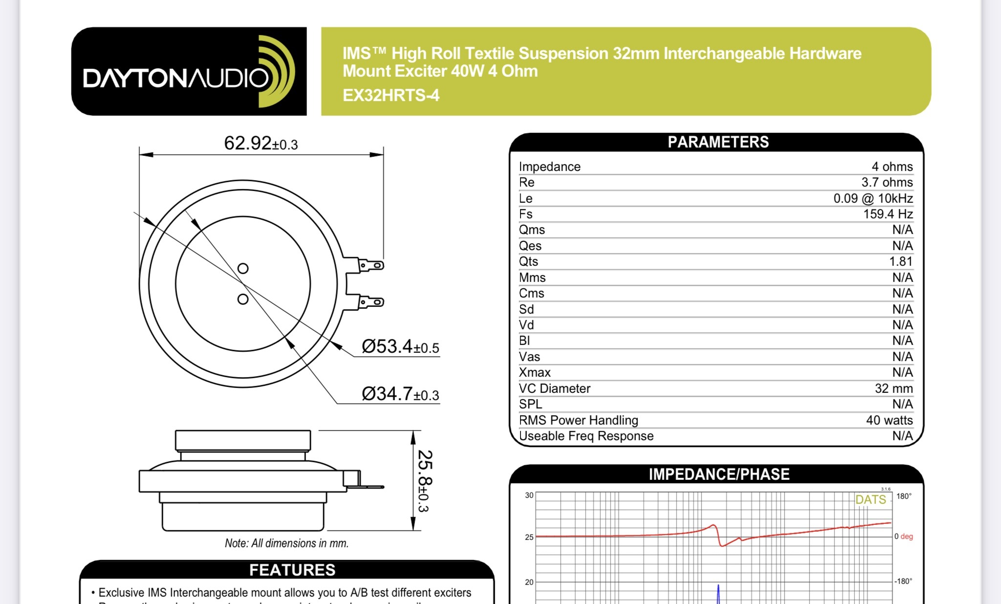

Thanks!Thinnest driver is this one only 1” deep.
https://www.parts-express.com/pedocs/specs/295-274--dayton-audio-ex32hrts-4-spec-sheet.pdf

These aren’t for Dave, they are for the OP. Dave made a good recommendation but I think It will be hard to find a traditional driver thin enough to fit in a picture frame. I think this is a great use for the exciter type of driver. They are thin and offer reasonably good sound, especially in a loudspeaker of OP’s dimensions.

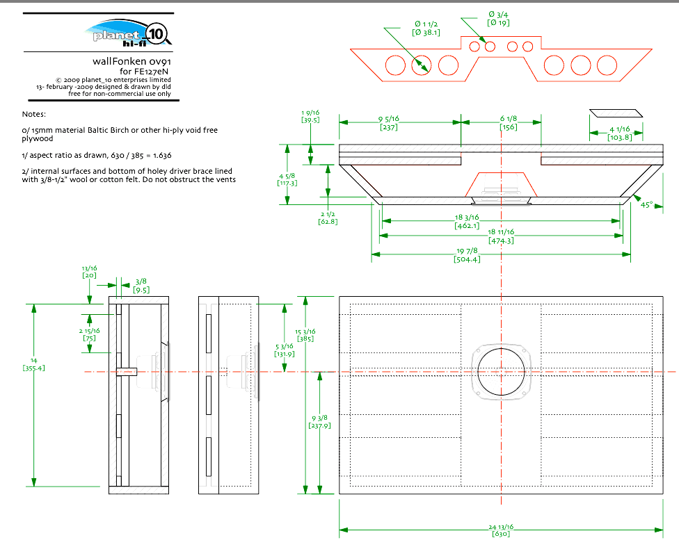

Here is an example of a wallmount Fonken i did (a long time ago), is as thin as we have become comfortable with. It is 13 litre, the P7HD need 9 litres, CHN-50 2.5 litre.
The uggestion of a cornucopia is a very good one. The structure allows use of very thin material, a big boon to keeping things cloe to the wall.
dave
