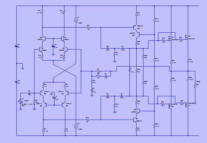

OK, I've done some simulations on this too. It seems OK to
use a 4 Ohm load, which will give you approx. 350W. This
should still be safe with proper cooling. Max drain current peaks
at 6.6A, the dissipated power per device is 120W in the peaks,
but should be well below the 100W limit on the average, even
measured only during the active half cycle, so I suppose this
is OK. Still, I would not recommend stressing it so close to
max operating conditions other than for brief periods, and if
you try, don't forget the earplugs.
You should not try to use a 2 Ohm load without adding more
output devices. The ouput power at max drain current is only
approx 200W, and each output device will peak att 240W
each in dissipated power. Don't try this at home
Once again, all results are approximate since they rely on the
accuracy of the transistor models.

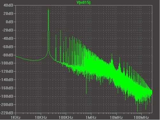

jgwinner said:Interesting .. how does this relate to THD? I guess I should know that. 😕
Each of the harmonics can be read off the spectrum. Find the
difference in dB between the fundamental and the harmonic
you're interested in. Then you can recompute to percents
using that each -20dB is a division by 10, eg. -20dB is 10%,
-40dB is 1%, -60dB is 0.1%. More precisely, if d is the difference
in dB, then the distorsion is 10^(d/20), or 10^(2+d/20) if you
want it in percents.
THD is a bit harder to get, since you have to consider all
harmonics at once. I don't bother about that. I think it is
more useful to know the value of each harmonic individually.
jgwinner said:Can you upload the spice model for the whole circuit?
I only have it the SwCAD3 file format, so it won't be useful unless
you use this implementation of Spice. Alternatively, I could just
extract a standard Spice netlist from it, but it will be without
comments on which component is which in the diagrams.
Component numbera are different from Sloanes schematic since
SwCAD numbers them automatically when entering the schematic.
I just realized that I could post my version of the schematic
along with the netlist, so you can see which component is
which. The netlist is autogenerated by SwCAD so you may have
to do some editing to get it working, perhaps.
There are a few additional resistors not in Sloanes original.
These are only for testing purposes. Some are set to 1 microOhm
and used only to be able to measure the current at these
particular points. The others are set at 1 GOhm in order not
to interfer. I used the latter to experiment with extra loading
on the VA stage.

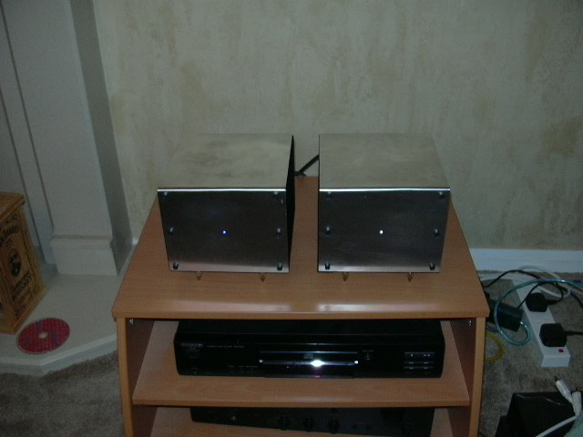

- PICS: "Optimos" 140W Monoblock Amps!
