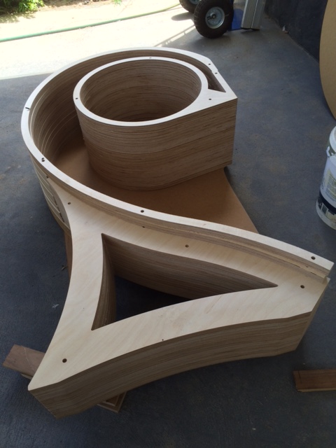

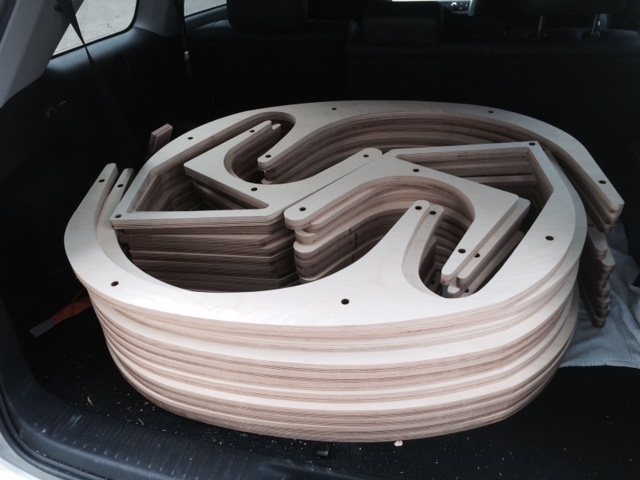

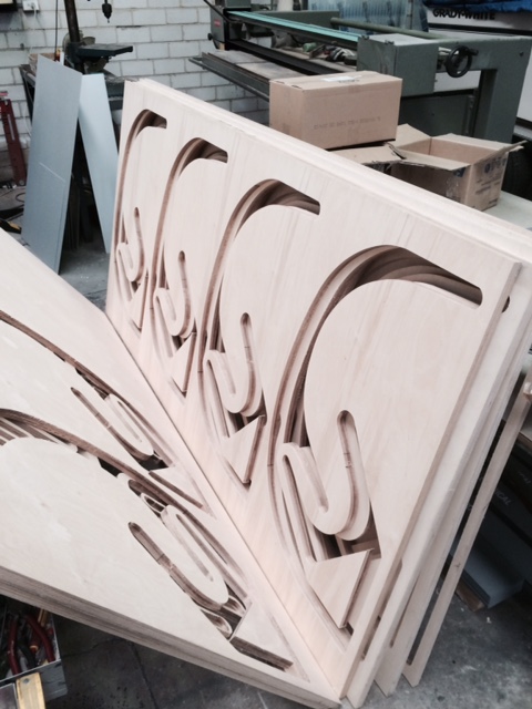

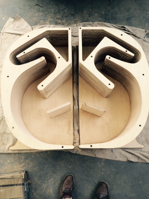

Pics New Lowther "Alfredo" horn using CNC'd Birch Ply
Looking forward to starting this exciting new project, modernising the Alfredo design. (Alf Lepp (RIP) was the designer, and the plans are in the public domain.)
The unit is approx 1150mm tall x 580mm deep.
It should be weighty given the solid sections of CNC'd ply.
Cues taken from recent Tang Band BLF project with exposed ply....plus my C-Horn.
I'll also be including a new Lowther baffle 'ring' which is machined in MDF, which was tricky to create as Lowther uses an off-circle shape.
Driver of choice, PM7A (Alnico).
Andrew

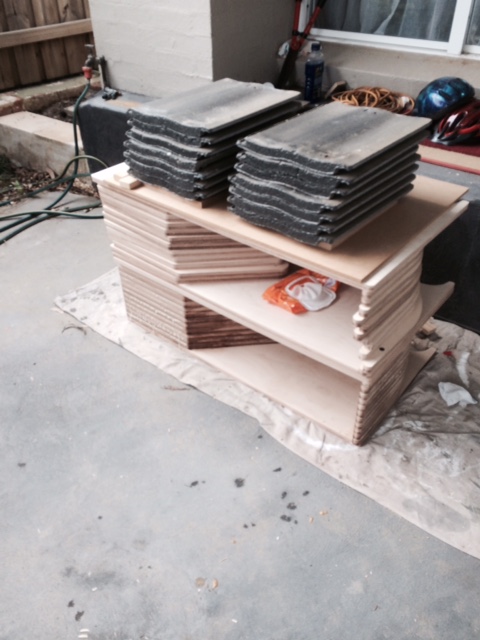

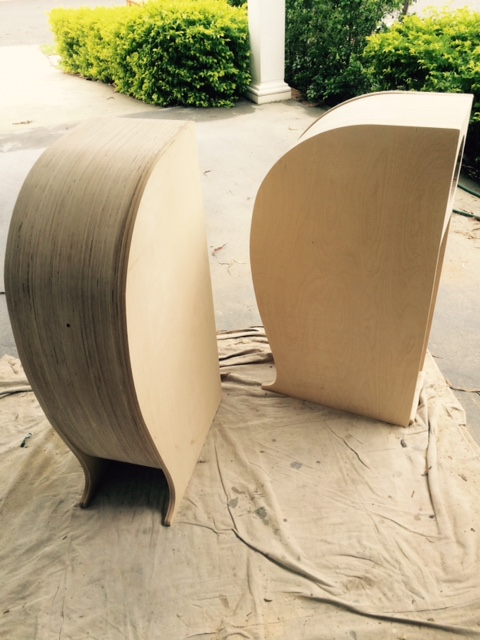

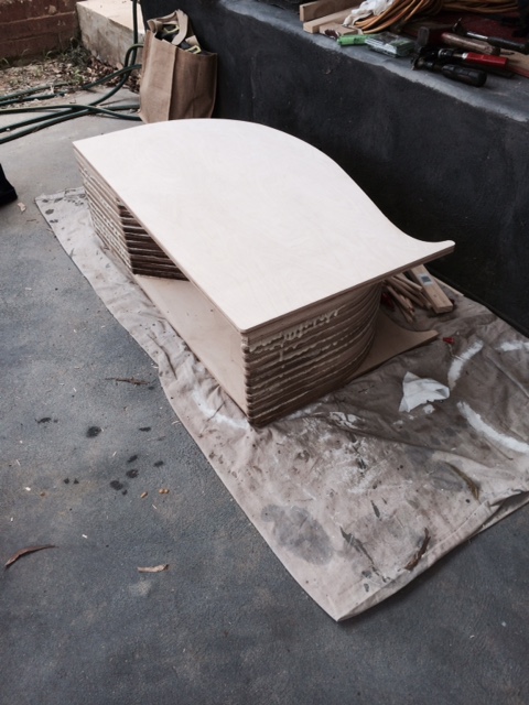

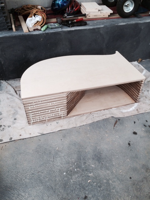

Thanks Thunk.

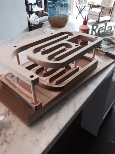

Glued up the main sections yesterday and today...they look very cool up close. And HEAVY.
Note the Lowther CNC'd baffle ring I designed. This will be gloss black poly.

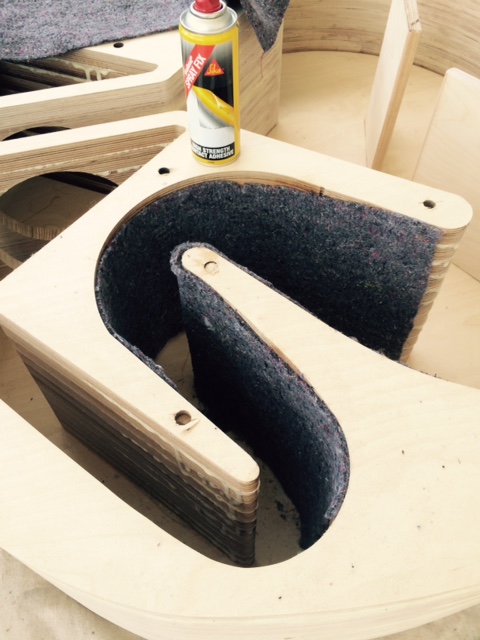

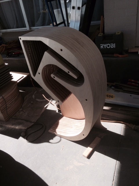

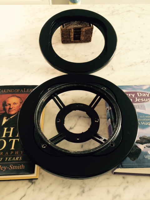

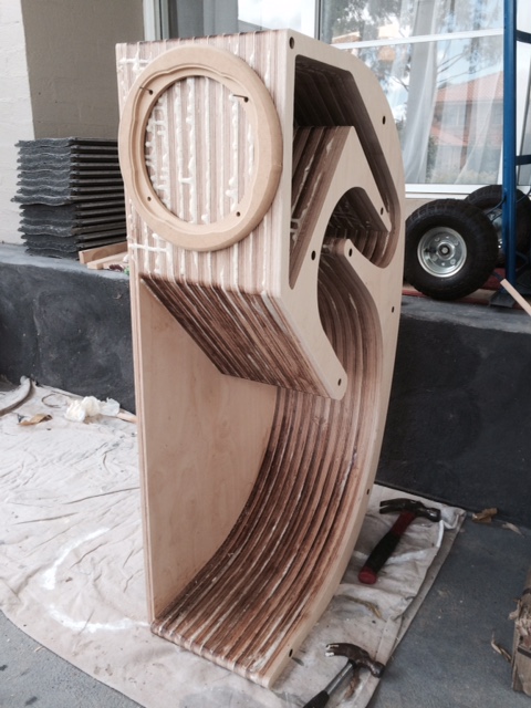

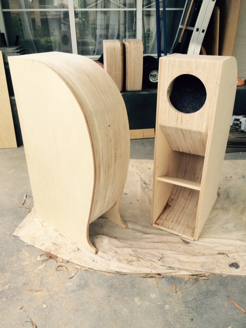

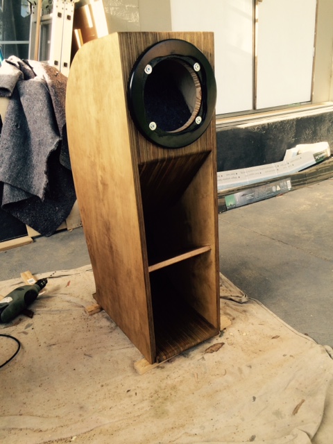

Mostly sanded....brace added with Oak hardwood trim on edges, dampening added to 1/3 of horn.
New CNC'd Lowther driver frame surround in MDF and gloss black. Makes for a professional look...should contrast nicely to the exposed Birch. Bought Scandinavian oil with a Teak proof tint.

Hey I hope the Alfredos sound good. I see you used the plans I made from the originals. Credit goes to Brian Lafrance of Ontario for the CAD drawing using dinensions and angles I extrapolated. The curved version looks cool. How does it sound? Damping?
Thanks, and credit to you and your colleague for this design.
I have not heard them yet, though my friend wrote a quick update below.
For dampening, 1/4 inch denim material to angled panel in chamber, then first 1/3 of the horn.

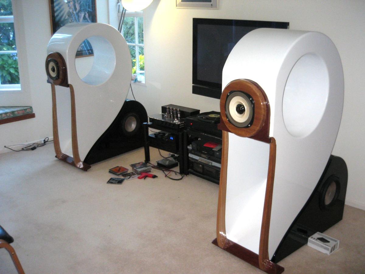

Comment from friend:
Set them up last night to ensure everything was working ok. This is how it looks but still work to do with the final locations and finishing touches. They integrate well into the living room as you can see from the picture. I will try them with and without the baffle ring.
Warmed them up as per John’s requirements and listened for 10 minutes or so. They sound very ‘new’ and tight as expected but more importantly no sign of any Lowther shout or honkey mid-range colouration. Actually I couldn’t pick any specific ‘horn’ characteristics. Very solid sound, pin point imaging beyond the speakers straight out of the box and generally a very flat response. The wow for me was how smooth they are. There is no harshness about them at all. I will give them a good run over the next couple of weeks. As mentioned yesterday you are more than welcome to visit and have a listen when you get back. They will have a few hours on them by then.
Hi Atilsley. No doubt you'll have to play with damping....maybe a little more the we did.Those curves act less like a low pass than more abrupt angles do. I have heard that this cabinet is excellent for lowther. The Snindo exampes on line certainly seem to indicate the musicality. I'm still interested to hear what you think.
Atisley, like your technique of CNC layers and dowelling. Nicely put together.
