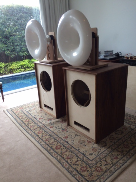

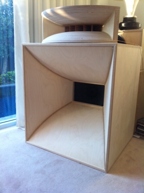

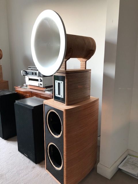

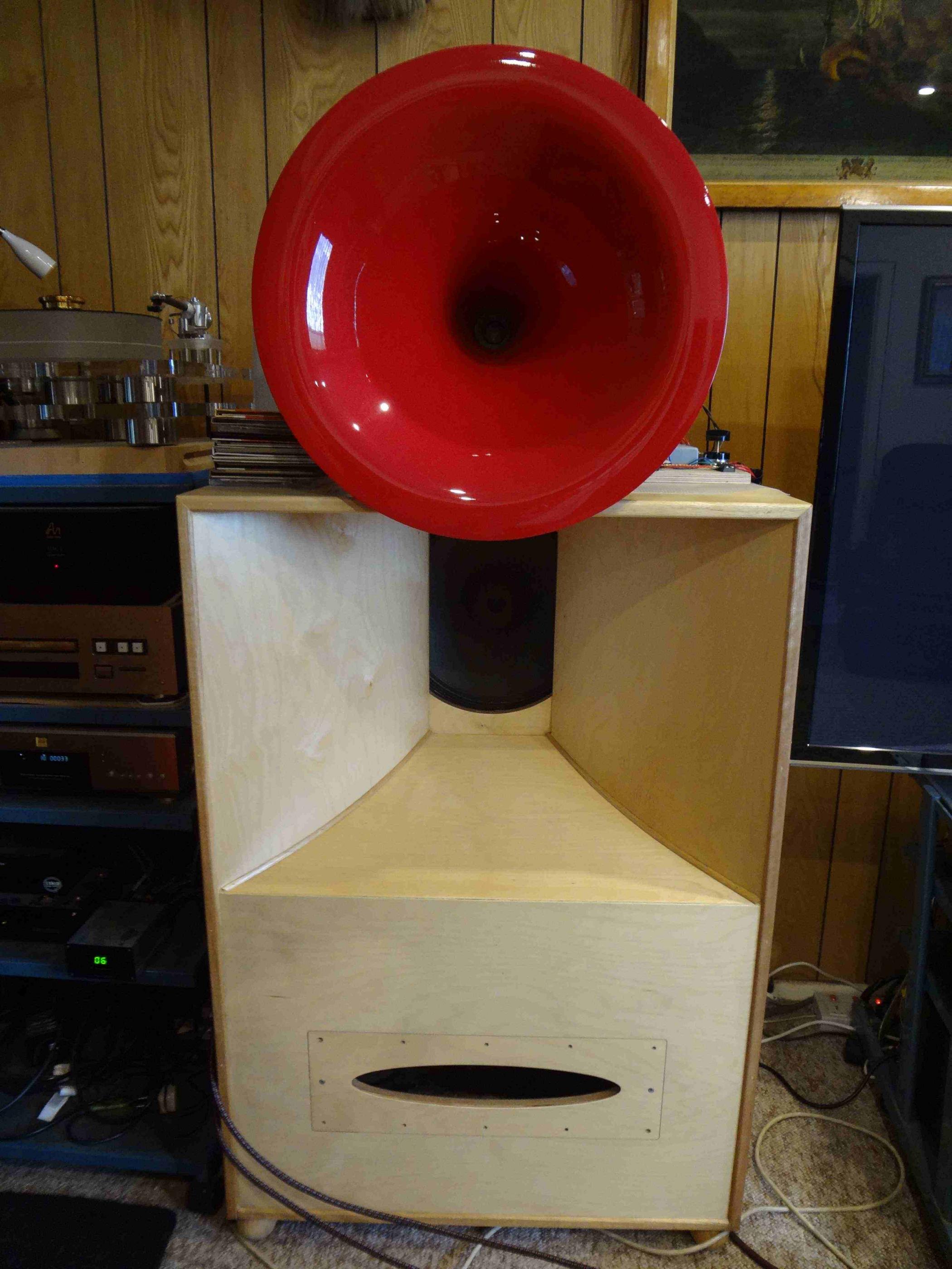

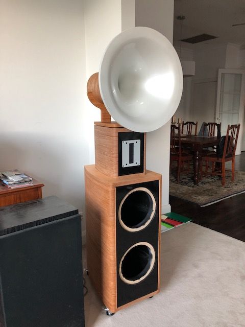

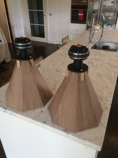

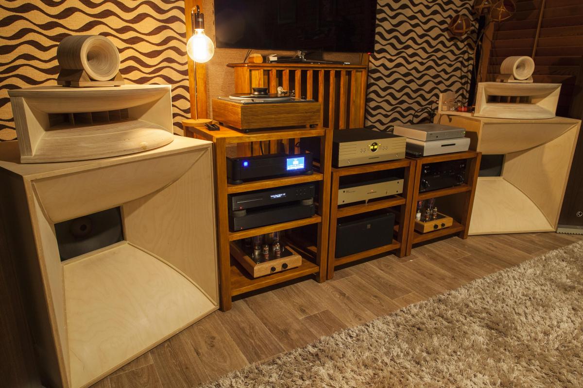

Over the years, I've been able to enjoy building systems using a mix of different horns, including:
- Altec 811 and 511
- Yuichi 290 (similar to TAD, see pic with matching bass horn I built)
- Iwata 300Hz (see pic with dual 18 inch AE dipoles in OB config)
- Azura 340Hz (see pic with Altec 15 inch bass cabinet)
- Conical 400Hz (see pic)
- Altec Mantaray (see pic in grey cabinet with Altec 416 woofer...my own personal system)
The Jabo was chosen as I had trouble sourcing the Azura 340.
A friend uses a Jabo with his Altec A5 VOTT bass speakers, which I built....so I already knew how good this horn sounded. (See pic)
It is reasonably sized to suit most rooms without being too large....and performs very well in that critical range of 500Hz up to what ever (depending on CD).
I also like the look of this horn. We had extra pearl/sparkle added to the paint, which makes the white look silvery. Very nice.

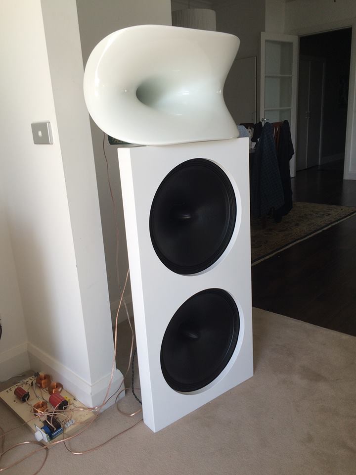

I think the iwata 300 was probably the nicest sounding...it's unique shape meant nice room filling sound, clean. The Azura is also very nice, as the Le 'Cleach flare is superb. The Jabo is still a lovely sounding horn....so I would put these three horns quite close together. (I've not yet had a chance to listen to the current Jabo horn with the bass, as the drivers are still on back order from AE).
I find these fibreglass horns are nicer than the Altec bi-radials (511 and 811)....of those two, I like the 511 more than the smaller 811.
The wooden Yuichi is a good horn....perhaps not quite as smooth....but then it's very heavy, so there's no coloration.

I used MiniDSP for the bass...but only had a moderate amp to test this system. The owner was going to use Ncore amps.
I added about 10dB low shelf gain at 30Hz.
The bass output was very good....tight/fast/deep. The quality of the AE driver is exceptional....heavy and great looking.
I used passive LR2 xover for the horn....approx. 700Hz. We used beryllium 2-inch drivers from Radian, which provided that classic "bell like" sparkle. Not cheap....but the system proved to be world-class in sound quality for a very moderate investment.

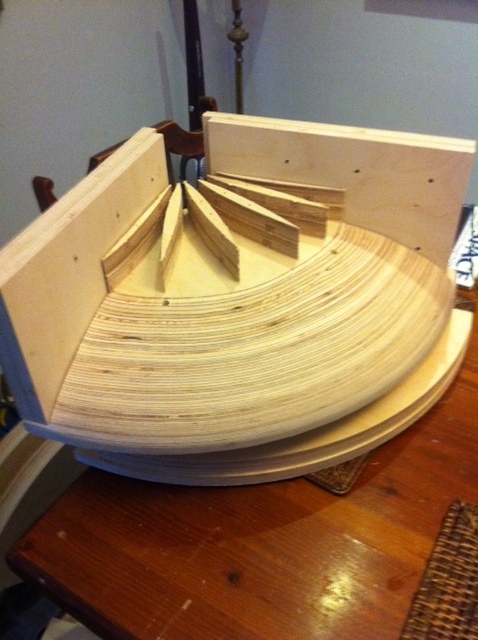

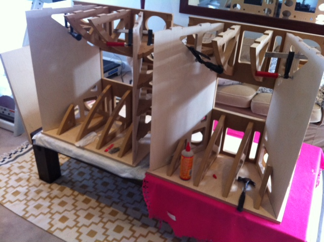

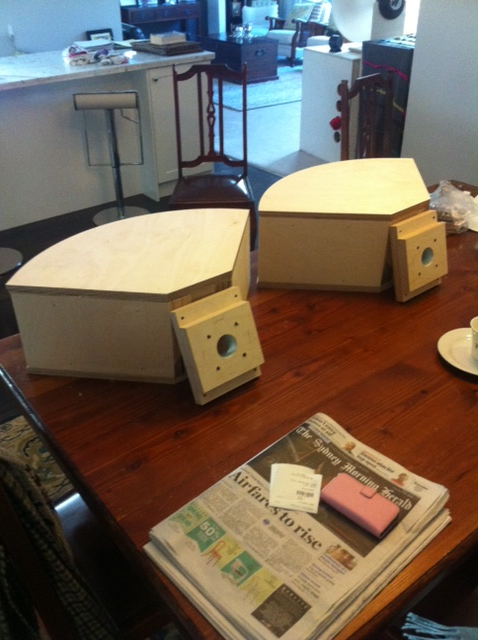

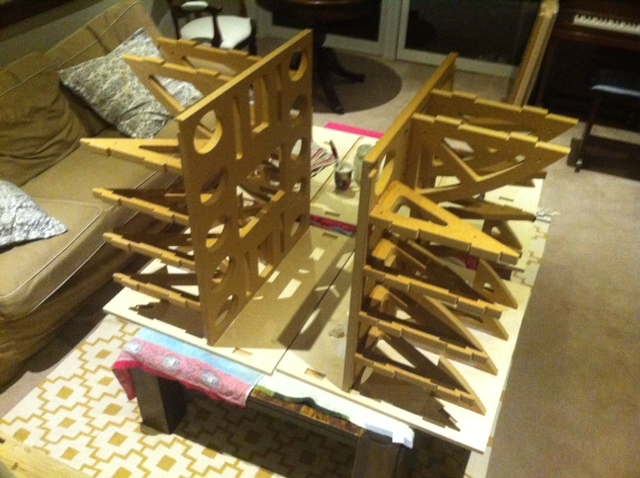

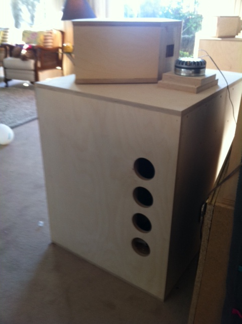

I offer CAD CNC plans for both horns...the Yuichi 290S and my own designed bass horn using Altec 416/515 or similar.
The CAD plans for the Yuichi also include the rear mounting plate...though you need to craft the square-to-round section manually. I use auto filler for this. The CAD plan also includes the fins. The CNC makes the large curved cut in 1mm increments...so you still need to plane/sand.

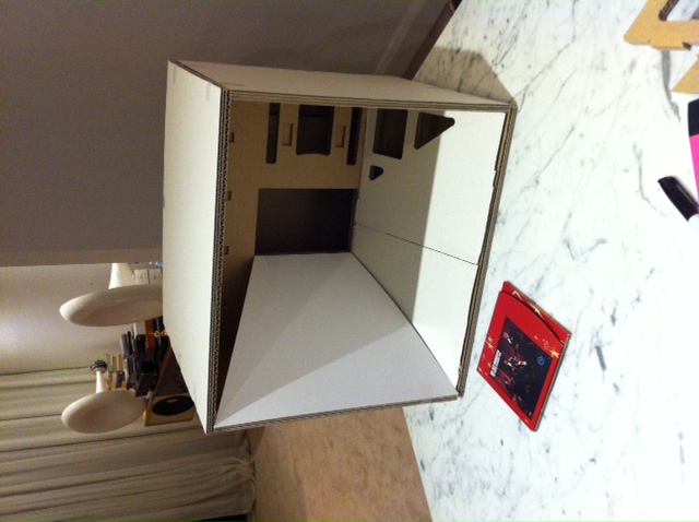

The bass horn is very heavy. CAD/CNC makes the job easier, though woodworking skills required. Ports on the side allow for cabinet tuning. I even CNC'd a 1/3 replica in fluted cardboard.

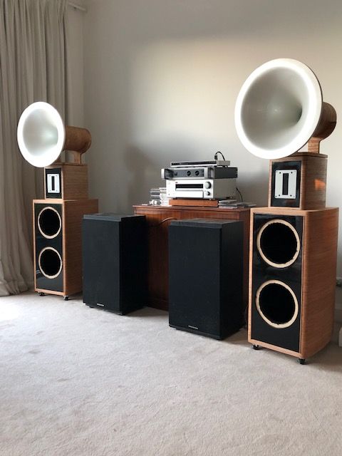

Dear home builder, thank you for you kind remarks.
The driver have arrived!
This project for client, who wished for moderate sized cabinet. Mind you, the system is now 175cm tall.
The dual 10’s will give good bass given cabinet tuning, rigidity and EQ. Running Krell amp.
I’ve enjoyed Altec 15’s in many projects, so I would have used dual 12 or 15’s for bigger output.
Have used dual 18 AE dipoles in OB with active xover and Iwata 300 horn. That was supreme bass indeed.
This current project was intended to have bass and TPL150 only, then we added horn for more mid presence.

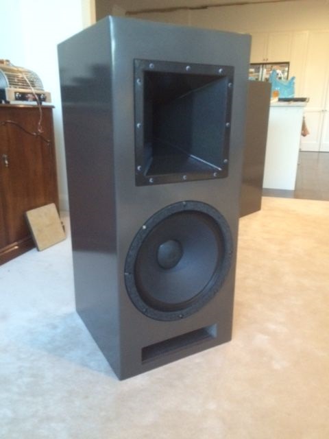

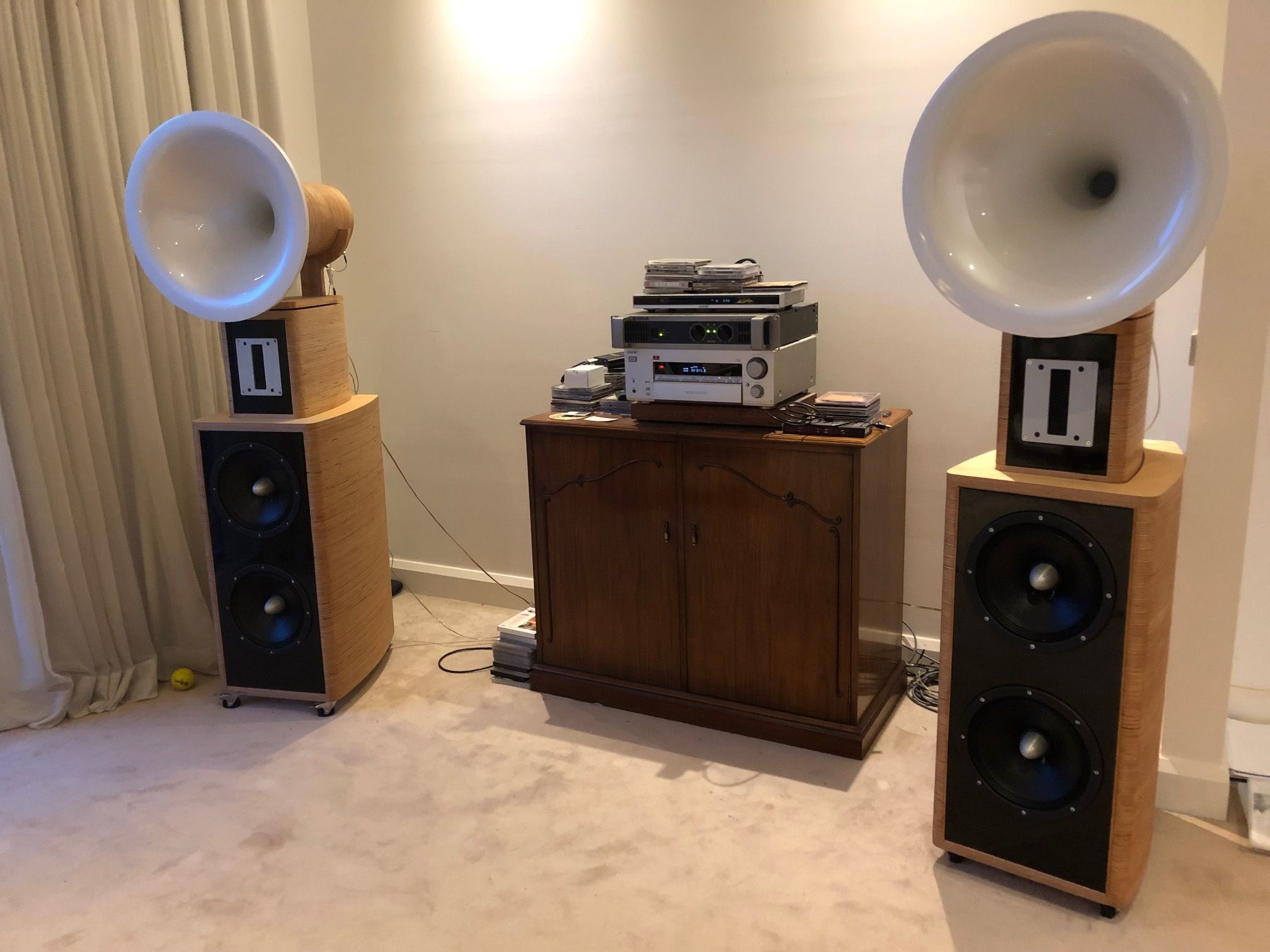

Finally got the AE drivers....plugged in using the snug rubber surrounds.
MiniDSP crossed at 750Hz, with 7dB low shelf gain at 40Hz.
The bass is tight and deep...very happy. No cabinet resonance.
I'll test the horn with MiniDSP also....just to compare with my passive xovers.
I tested the horn using MiniDSP, crossed at 750Hz (matching the active bass). The horn performed very well...but not as clean/sweet as the passive xover. It gave me confidence that the work on the passive was worth it.
With huge output, the woofers are only moving 2-3mm.
