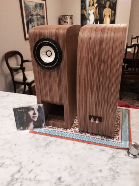

I don't have any dimensions but guessing based on driver bezel width, the length of the TL is about 1 meter. As it is expanding slightly and not tapered down to smaller terminus, the resonance frequency will be a bit higher than the 90Hz quarterwave frequency. So maybe 93Hz extension. If my 1m estimation is totally off than that number is subject to change.
Correct, 1m is spot on. I'll provide some graphs once the drivers are fitted...though I'm away on hols for two weeks from tomorrow. It will need to wait.I don't have any dimensions but guessing based on driver bezel width, the length of the TL is about 1 meter. As it is expanding slightly and not tapered down to smaller terminus, the resonance frequency will be a bit higher than the 90Hz quarterwave frequency. So maybe 93Hz extension. If my 1m estimation is totally off than that number is subject to change.

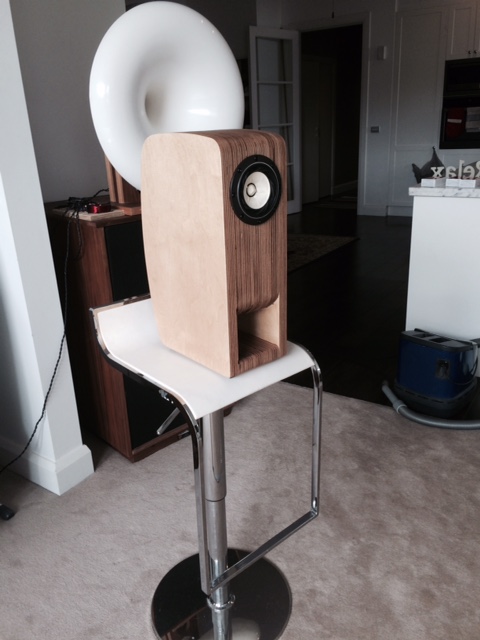

My main goal is to build an attractive and small desktop/standmount speaker, that has better output than a standard ported unit. The horn/TL provides that...and the curved CNC gives it an exotic appeal.

Andrew - aside from my aversion to the stacked lamination method from the point of view of material waste, those are particularly pretty, but to expect much deep bass from the 108 EZ in any compact enclosure is probably a pipe dream
Thanks Chris, I agree re the bass. They're a small speaker designed for quality sound near-field. Having said that, I was enjoying listening to Leonard Cohen's very rich deep voice the other day in the Dublin Live concert. They performed very well.Andrew - aside from my aversion to the stacked lamination method from the point of view of material waste, those are particularly pretty, but to expect much deep bass from the 108 EZ in any compact enclosure is probably a pipe dream
On wastage, I'm intending to use the remaining CNC'd "outer" material to create a foam or concrete horn to test the method.
