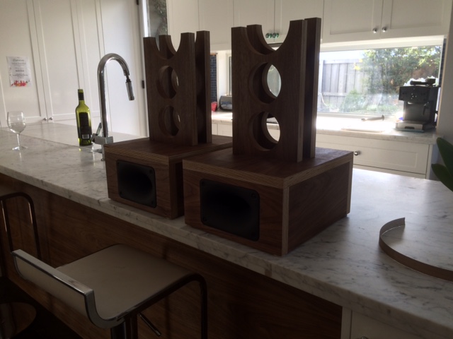

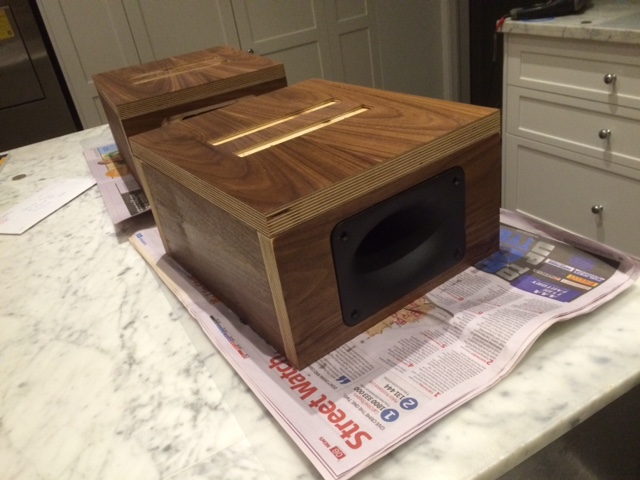

Very beautiful plywood from the land Down'Under!
Didn't see too much of that in the Hobit movies 🙂

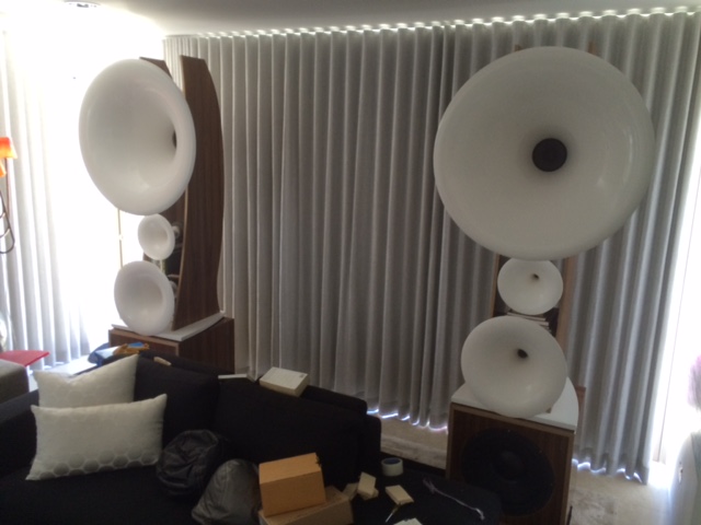

Just enhancing the original design
Six channel Holton amp, with the tweeter and 340 horn running off one channel
Yes, FP tweeter horn, but Selenium driver (for now)...will swap for FP later, although Selenium calf to 18k.
Retaining active xover now via minidsp, but will soon add passive for mid bass and top two horns, then couple four channels into two for the bass (EV 18 inch).
Vinyl more for fun now...not sure if I'll invest heavily.
I love Spotify...suits my joy of flicking channels...!
Would like to upgrade DAC.

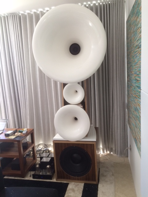

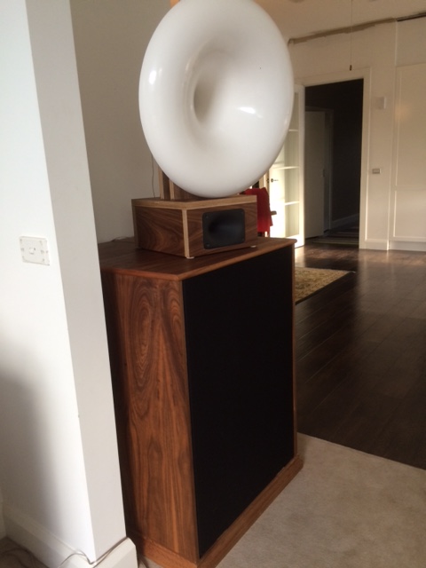

Reconfigured the system with the 160 now on top...pretty big...
Big woofers produce Big vibrations.(without counter-force). With the Large 160 horn on top, do you hear any sound stage wiggle or waggle?
Big horn on bottom.
Tweeter at ear level.
Medium horn on top.
Woofer(s) on the side? Woofer(s) toward the rear? Unsymmetrical woofer placement?
You may have to knock down a wall for your Art 🙂
Ok, time to blow a hole in the back wall? 😀
But the idea is that the farther back, the less "%" in time difference there is between the various sound sources - vertical difference, assuming the front to back distance has been accounted for by some means...
but the system looks quite impressive! 😀

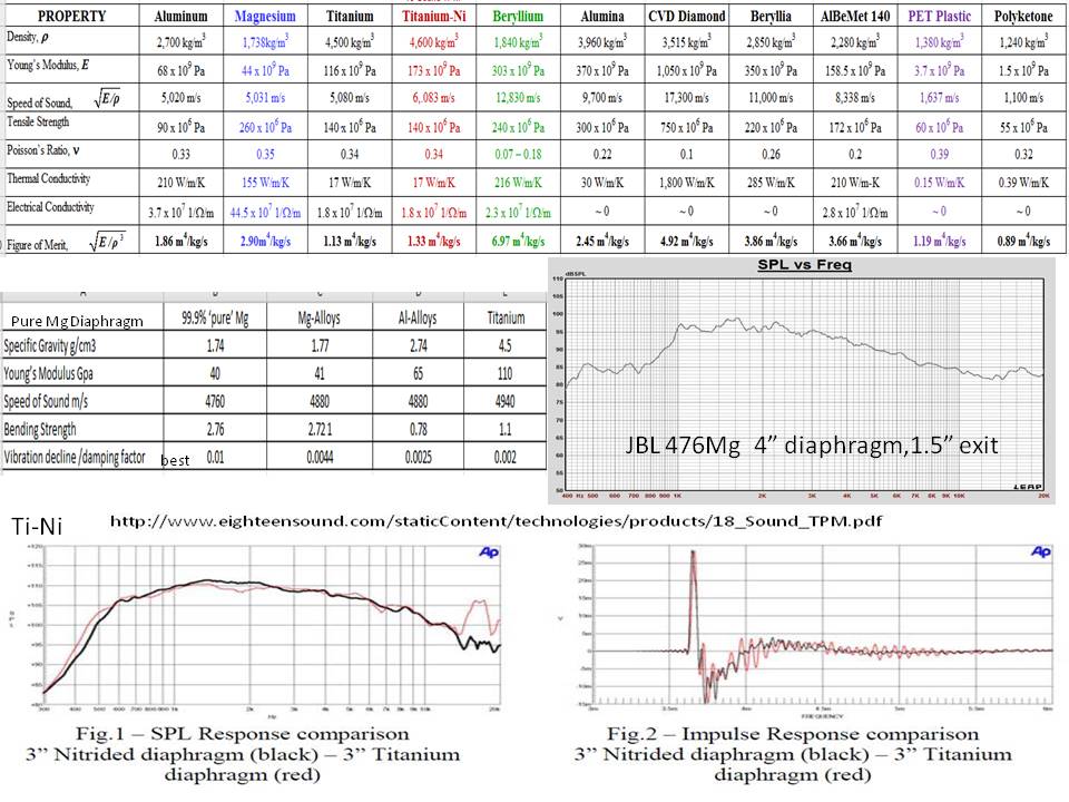

I have been experimenting with 15Khz-20Khz boost on 1.4" Faital HF146 - Ketone Polymer plastic dome in a borrowed LeCleach horn hoping to avoid a supertweeter. Not much success. Boosting the 1.4" at 12-15Khz creates very noticable beaming. "Throwing in" a super tweeter at 12Khz just sounds broken.

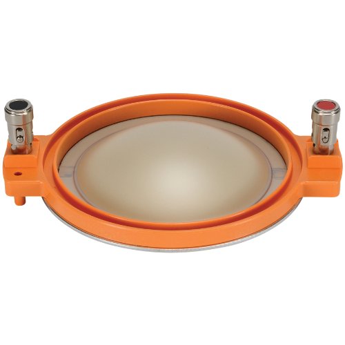

Had high hopes for that driver. Other than beaming how does it sound in the rest of the pass band?
The 1.4" Faital HF146 compression driver uses a Ketone Polymer diaphragm. In a JMLC 400 horn the SPL starts to drop at 12Khz, and has a few SPL bumps between 14-16KHz, but not the nasty break-up spikes common in titanium diaphragms. A simple linear slope boost which attempts to provide a flat SPL from 12Khz to 20Khz+ amplifies these old "few bumps" and also "shows off" the directional beaming from 16-18Khz which I believe the LeCleach curve naturally produces. From 800Hz to about 14Khz the HF146 has a "warm and neutral" sound, and I think this help them blend with a paper cone midbass. Sine wave tests below ~800Hz have irregular resonances... sounds bumpy.
Polar plots show the LeCleach horn to be more directional at high frequencies than a round oblate spheriod waveguide. The OS waveguide has a larger SPL drop at high frequencies than LeCleach, but wider polar response.
